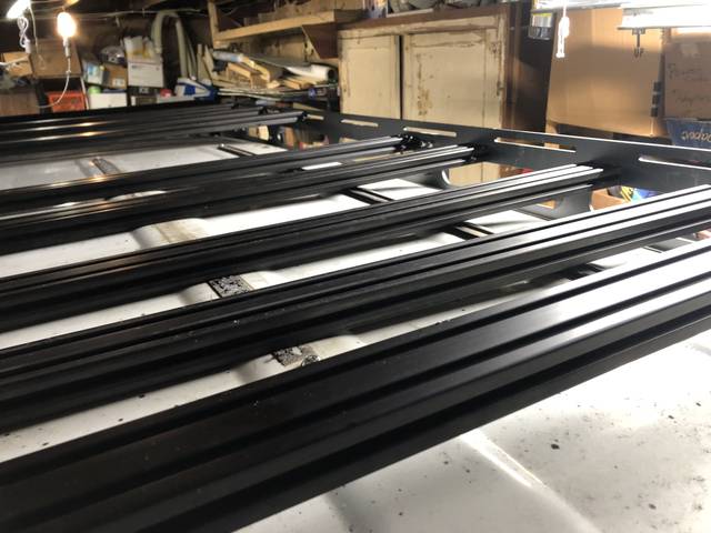

The above is a good view of the distinct "no lip" rack design that worries me. Prinsu does this as well as others. I have a Bowfin Crusiers rack that was similar. Don't get me wrong, these are good racks and you shouldn't solely rely on a rack lip to keep your top-end goodies from departing the truck. But I also think you shouldn't do without a lip IMO. Here's what the inside of my Bowfin Cruisers rack looked like after I modded it to lower the bars about an inch and a quarter.
To accomplish this, it will generally be necessary to get the rub rails off the roof so there's enough clear coat all patyusand then to drill pairs of new holes about 1" lower than the adjustment slot provided.
