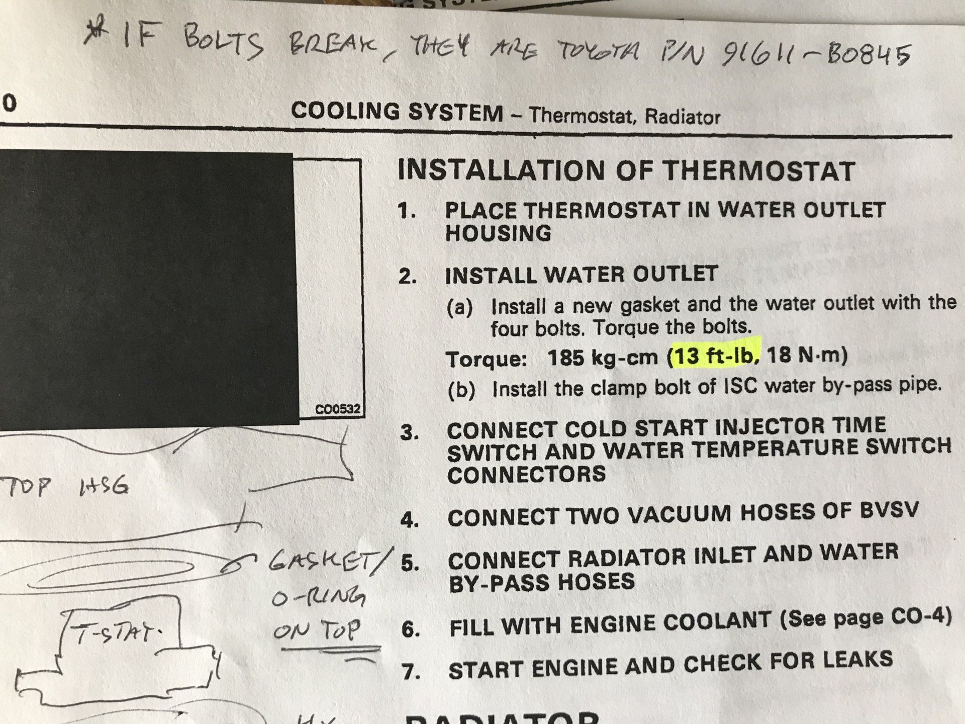

While you are in there:
And don't forget new hoses. Buy and install once, cry once.
