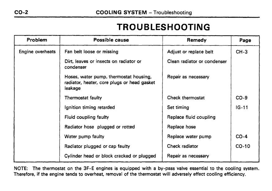

Do you have a copy of the Factory Service Manual? The start of each chapter has a nice troubleshooting guide to help you know which subsystems to look at.

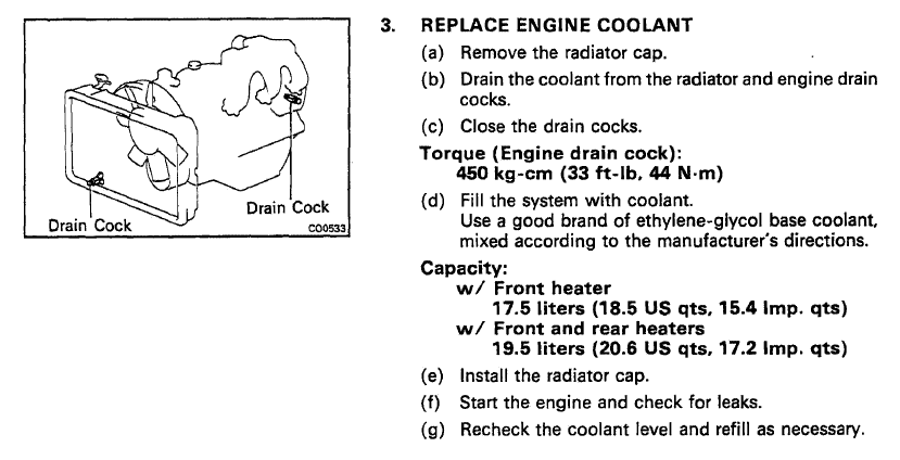

This drawing from the FSM shows the location of the block drain. All you do it loosen it off and let the coolant out. That's really all there is to it. If you open the block drain and no fluid comes out, it's likely because the water jacket is clogged by the "stop leak" crap the mechanic added to your cooling system.
While we're on the topic: find a new mechanic.
