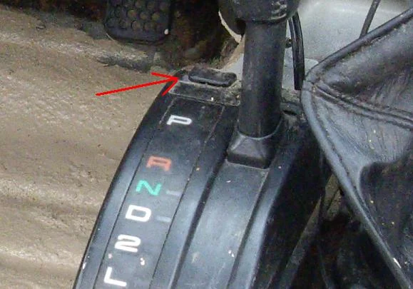

My shifter doesn't want to unlock to shift into drive or reverse. The batt is almost dead but that shouldn't have anything to do with it does it? Problems problems. Anyone else have this problem? I hope its just something caught or stuck and not the solenoid thing. Didnt have this problem until I pulled the carpet back and wedged the foot rest under the brake pedal to hold the carpet in place while I welded that strip in the floor. Is there an override for this?
yes, there is a little panel on the shifter you can pull. I had an issue with this and it turned out to be a short in the tail lights - the trailer plug had melted to muffler.
Yea, that is kind of a safety feature built into the 80's system; when the brake lights are not working you cannot shift out of park. This happened to me when i first purchased my rig and pulled a trailer that had a short in the wiring which blew my brake light fuse. Couldn't get it out of park. Pulled that little cover WE just pointed to and pressed the button with a screwdriver to get it into drive. Changed the fuse and all was good.
ok that makes sense. I broke an 1157 by accident. That must be why its doing that. It happened at the same time I pulled the carpet back. Thats crazy it does that. Man that takes a load off though. I thought I was going to have to replace a $50 sensor or something. Thanks guys.
Its also nice to know where the over ride is. I thought it was a cap for the over ride button that wasn't there. Yeah i'm an idiot.

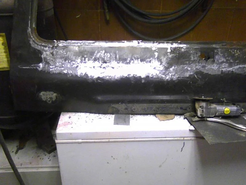

Its more orange because I have it wet sanded down right now. I wanted to get everything in color than re assemble it, wet sand it with 1000 grit and than lay a nice clean wet coat over everything so its uniform. Its been a week since I've touched the truck. I had to clean up my shop. Stuff wasn't getting put back after it was used and I found myself a huge mess thats taken me a few days to clean up. Not how I wanted to spend the free days I have but now I can work again without walking around in circles looking for stuff and stepping over things to do this or that. And yes Rusty, heat is amazing. It was low 20's last night and I was in my shop in jeans and a t-shirt sweating away. No more carharts with long johns and frozen hands for this boy. I don't have any good pics right now unless people want to see my clean shop. I'm gonna be heading out in about an hour to tackle the hatch. I'm going to patch the old one for now and get a new one this coming summer. Funds are getting pretty limited at the moment, unless theirs someone looking for a good set of used twins out there.
Heres some shots of where I have the hatch. Should be done with all the repair work tomorrow night sometime. For now I'm not worried about putting the wiper back in it. My whole assembly was in really bad shape and I had to cut it off. With the rear tire on the back I wont be able to see out it very well and the stereo I'm putting in it has a rear view camera I had planned on integrating into the bumper. Not to mention that will be nice when it comes to hooking up my trailer.
