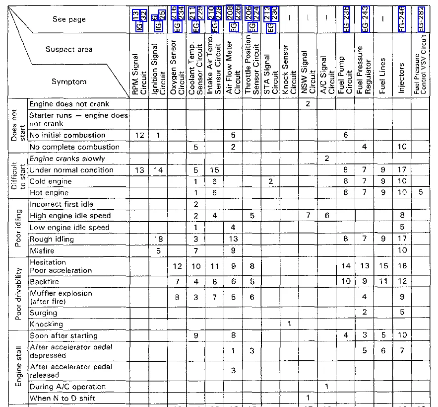

The FSM says (I wouldn't have thought these would be first, but what do I know?):
In addition to the suggestions already made, since (I agree) it sounds like a fuel problem, you might want to check the fuel pressure regulator, if the filters don't do the trick. It's cheaper than the pump and much easier to get to.
