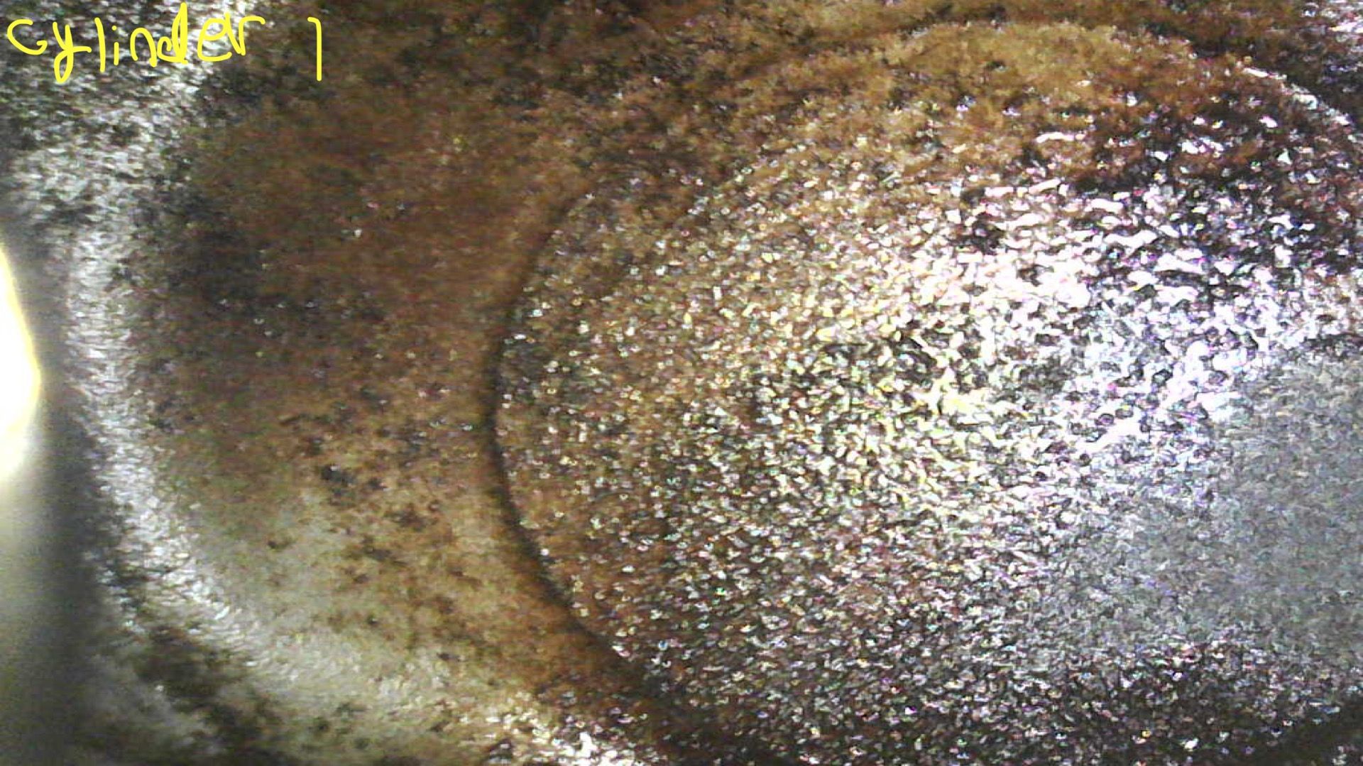

To his knowledge the 1st driver side piston and valves were replaced, all new gaskets, and the head was sent to a machine shop. I picked it up recently and he said he fixed it but it wasn't making good compression on one cylinder. I tore into it myself since I have gained a ton of mechanical knowledge since I dropped it off at my former mechanics place. Today I pulled the spark plugs and the spark plug on the piston he replaced seems to be either caked with oil or carbonation, all other spark plugs seem fine. I only did compression tests on 6 cylinders because the back 2 were a pain to get to on either side.

I got a borescope into the cylinders and I saw some crazy stuff. Passenger side was never touched so it was immaculate, as if it was brand new almost. Driver side (Where work had been done) was different. Lots of black crud, probably carbon buildup, and some cylinders had visible chunks of black stuff. Cylinder 1 obviously had some oil in it since I assumed the rings hadn't seated correctly. Is this normal? Should they all look the same? or does one bank get more gunked up?
I want this to be the most perfect Landcruiser there is. Do I have any hope that I will see a day where this is true? I am willing to go to any lengths that aren't super expensive, even an engine teardown isn't off the table, I got time. All necessary images are attached. Passenger bank cylinders are numbered in blue/purple (im colorblind) and Driver side cylinders are numbered in yellow/green. Spark plugs are laid down in order of cylinders on each side. I would post more pictures but I guess I'm limited to 5.
