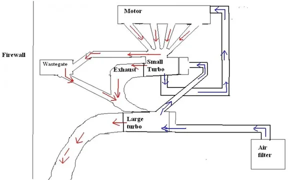

Here is how i was going to fab up my next manifold. It has several bennifits:
easier to weld up
can utilize divided manifold on large turbo making it more effecient and spool faster
turbos can be changed out easily for different ones (less welding)
Drawbacks:
will add turbo lagg on small turbo during normal accelleration. during towing or really slow accellerations the small turbo will still spool at low rpms. Its boost will just be delayed.
Because the flex pipes are downstream of both of the turbos the fabing is much much easier and dosent have to be as exact. I would recomend this way (in the pic). I did it with the small turbo first and getting it to fit properly was very tedious. I 'll draw a pic later for you on how mine is currently.
That is essentially the setup Borg Warner are running with some production diesels. The advantage is your small turbo can be smaller than it could be as a single, the disadvantage is you need more valves and more control over the system.
Depending on the sizing, you may need a bypass around the compressor of the little turbo. A spring-loaded valve so if boost gets higher from the big turbo than the little, that it can bypass the smaller compressor and head straight to the intake.
Again depending on the sizing, you might need to get clever on a bypass for the small turbine. It's the switching of this bypass that normally needs computer control to avoid a valley of death.
The external wastegate in the large turbo first design sits between the two turbos and only opens at desired small turbo pressure limiting its boost. A very large wastegate will really allow for alot of exhaust to escape straight to the tail pipe bypassing the small turbo and prevent boost creep. I have found a true 60mm in and out wastegate that should breath really well. Most are 60m in with 44 out which would most likely still work.
As far as large turbo compressed air bypassing small turbo I think that as long as the small turbo is still sized for the origional engine and the compressor housing is generous to allow for good air flow, I wouldnt think that a bypass system wouldnt be needed necessisarily. That actually sounds like a real sequential system. I had always planned on utilizing small turbo for compound pressures so I actually dont want to bypass it. That would be for pressures greater than 1 turbo could feasably produce by itself (30 psi and up).
Here is a drawing of my current manifold. My main problem with this set up is the wastegate sits between the two turbos and has to fit with the main dump pipe from small to large turbo. Essentally you have to weld two solid sections of steel pipe that are different length that fight eachother. I also used v-band wastegate conection which suck for this stuff because they have to be very precisely fit in order to actually be clamped. In order to change my little turbo I have to reweld this problem section and make it all fit again, which was the hardest part of the whole manifold.
The other set up sidesteps this by allowing for the use of flex pipe due to low pressures. I guess I could have used flex pipe in between on mine, but I thought it would leak as the pressures are pretty high there.

When you say WRX turbo, that includes many different types. VF28, VF 52, TD04L... the list is a long one. Here is a link.
http://www.wrx.com.au/forum/viewtopic.php?f=56&t=53416
Im refering to the TD04L wrx turbo. Hope it will work, just got one off of ebay.
The shipping on that exhaust housing is a bit much ($50) on a $130 item, maybe Ill call them and see if they will ship it snail speed, or order it to MSO.
:cheers:
I have a couple of those td04L wrx turbos on my shelf as well. Mainlander ran one with good results for low end boost. He felt it ran out of steam around 2700rpm. It is on the smaller side, but is a good fit for the 3B in my opinion. Would work well for normal driving rpms. The compressor maps really well for it for higher boost, but you would definately need to upgade to a 360 thrust bearing.
The .63 housing is more common on older t3 turbos rather than the .48 as far as I have seen in the junk yards. I have a .63 but im running it as the large on my comounds. I also have a couple .48s but they are only really good for singles.
