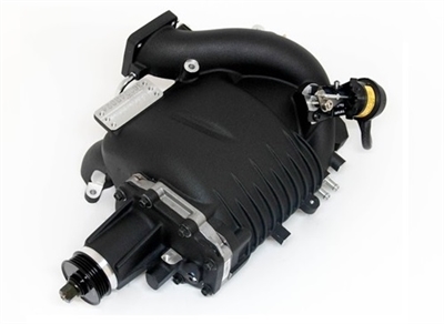

Keep the T100. Buy a supercharger. In the long run any vehicle you buy and the depreciation you lose will be more than dropping money on one of these. Even switching an engine will cost you 5-10 k min. I had a 3.0 T100 with an auto and wished I had a 3.4 manual....
