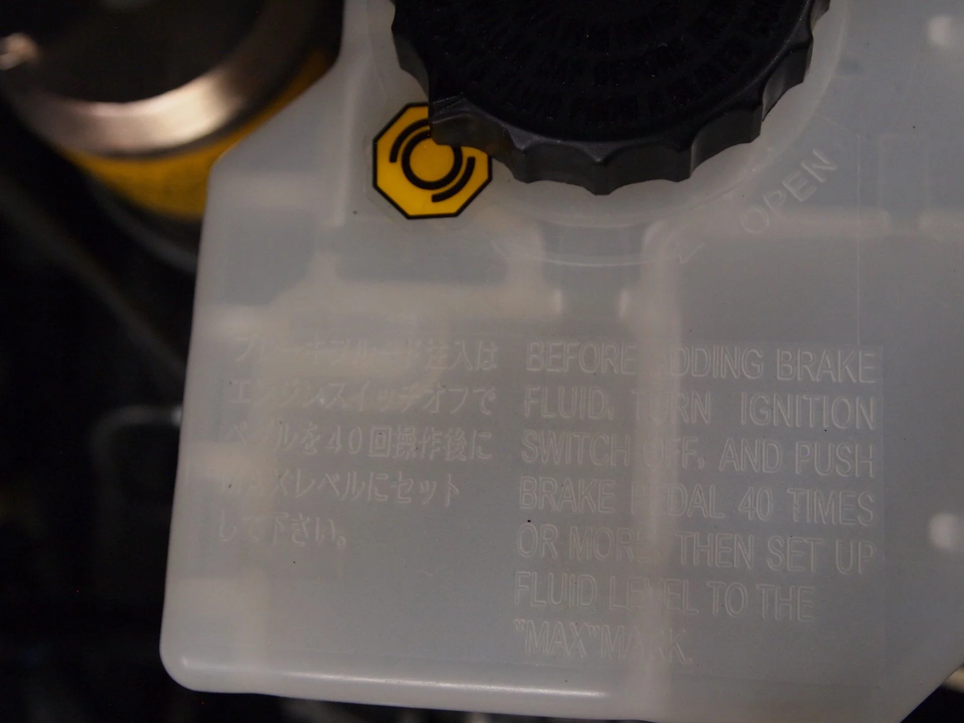

Evacuate the Booster just like you did to detriment brake fluid "previously in the normal range", instructions are on brake reservoir. Then turn key on (don't start) and time how long it takes until booster pump shuts off. Normal is 30 to 40 seconds.

Reservoir being full indicates fluid was not lost. To have over max line indicates system was overfilled. I see 7 out of 10 overfilled, even when dealer maintained. Seem no one reads the procedure stated right on the reservoir. Does this cause damage to booster, master or ABS IDK. I do know the cap seals the reservoir, and overfilling is not a good idea.

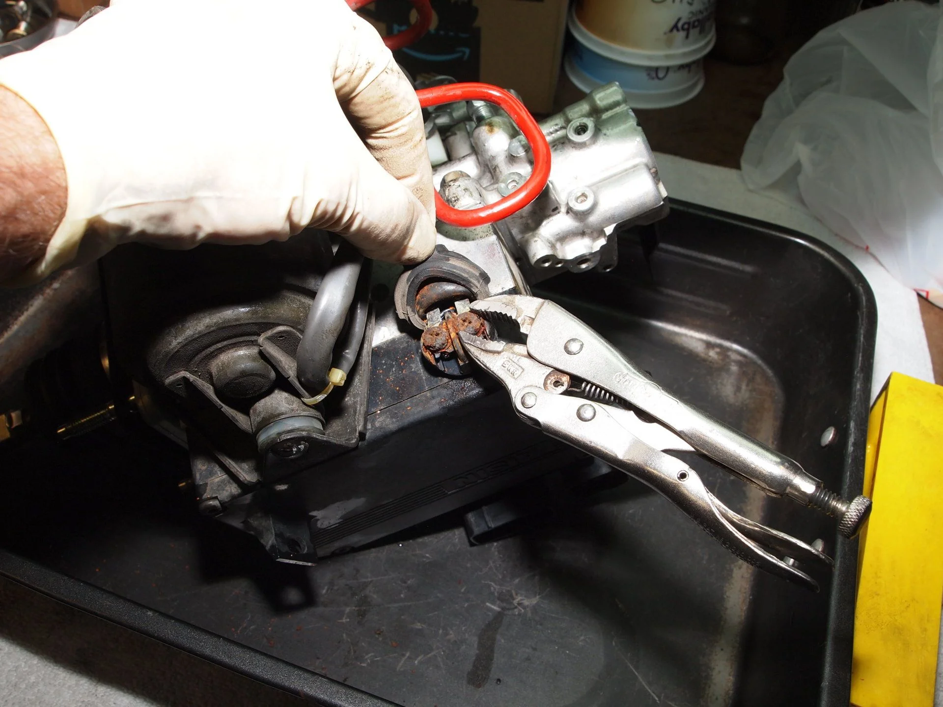

The newest thing I'm checking during my inspection is check the leads for the ABS to booster pump. Here is one ABS unit I swapped out for a mud member this summer.
Leads are in very bad shape (Rust) This was from a clean 98 no rust w/150K miles. Edit: After leaving exposed to air, it dried in a matter of hours. I'm now convinced after seeing 100rds of master. Rust (corrosion) is a result of brake fluid getting into boot and on wires. This increases resistance. Which damaged motors commutator, causing premature booster motor failure.
I use a mirror to check by pulling boot back. On The king which I had 14 years the leads were fine. I note that because I washed engine bay at least 7 times over the years, thought that washing may be cause. Nope appears not the case.
