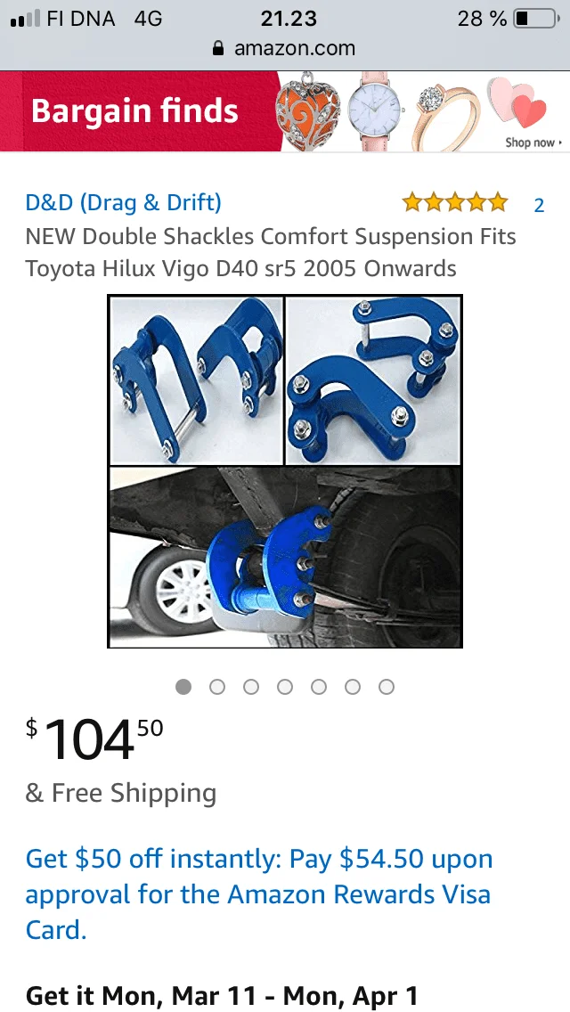

These are quite cheap, but made for Hilux:
1906710
I think I’ll make some own versions of those, I could use shorter shackles but get them reach when needed. Some limit brackets for preventing those problems Downey said.
