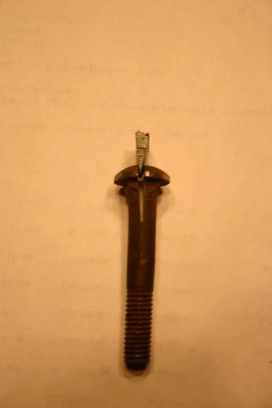

One night after much frustration I dreamed this up. It took all of 3 minutes with a hacksaw...Grind the head til it fits into the bearing, saw a weddge from some junk steel, put a nut on it, drive it into the hole in the pilot bearing, the wedge spreads the head... put a large socket and washer and nut on the threads and draw it out. No mess, no slipping out like other carriage bolt methods... it just comes out.
