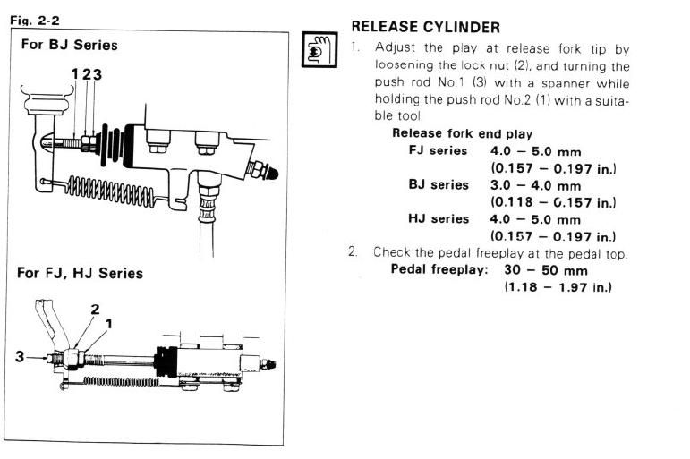

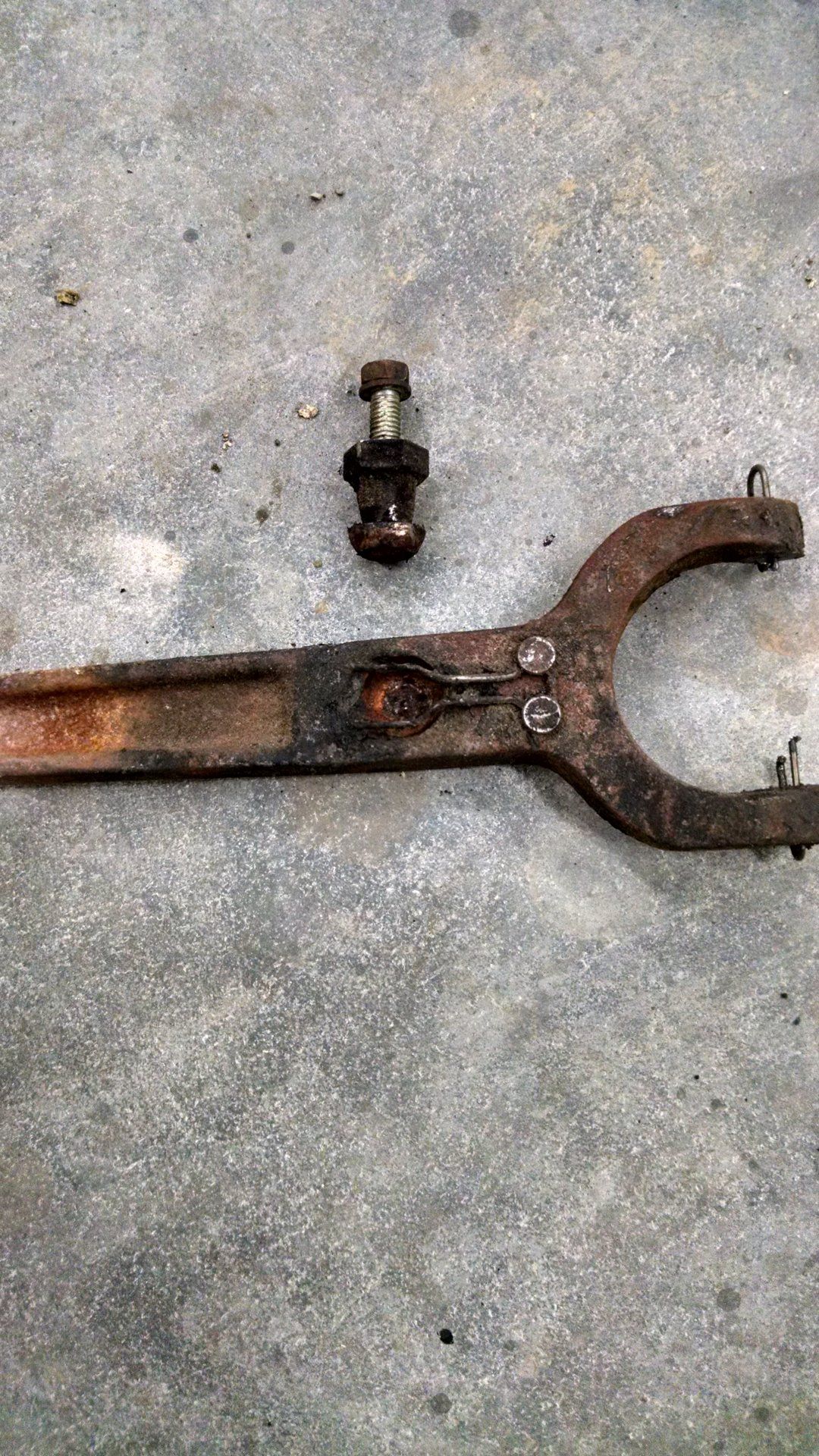

What am I missing? the only thing I can see that is an issuue is maybe the clutch fork is loose. I noticed that I can push and pull form in and our pretty easy. Is this supposed to have this much play in it. if not how do you set the tension? Granted I am just shooting in dark now but thought I would throw that out there as a possibility.
