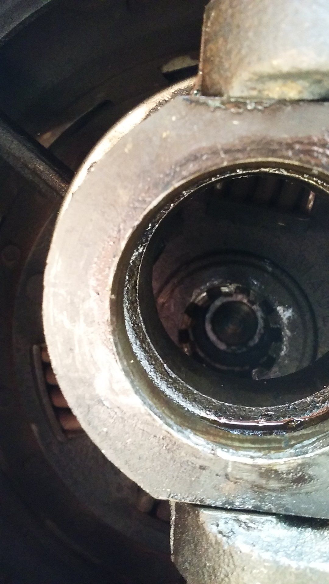

Is the engine currently out of the rig? If so, post up a pic of the pilot bushing.

From what I can see from the picture it looks as if the clutch disc is not centered. It's very possible it can be the angle the picture was taken at.
I tried to get pilot bearing and you can see it at the very end. This is going to be the best shot.
Well, with clutch and throwout all sitting in the way there isn't much we can do. If you pull that out of the way and get a real pic of the pilot bushing I believe we will see the problem.

Pic stolen from web ..... post up a pic of the bushing that is pressed into to the back of the crankshaft.
Looking to see if 30 hours and 3 days of trying to wrangle the engine into place has mucked up the bushing, thus making a tranny engine mating impossible.

Is it all buggered up from your attemted install? A small burr or blemish will keep the pilot from sliding in with ease and self destruct shortly if you do manage to cram it in there.

That pic is looking forward from behind and viewing through the throwout bearing, the clutch, then at pilot bushing? How is the clutch hanging in there currently?
