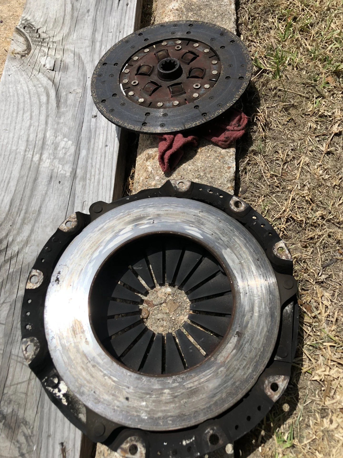

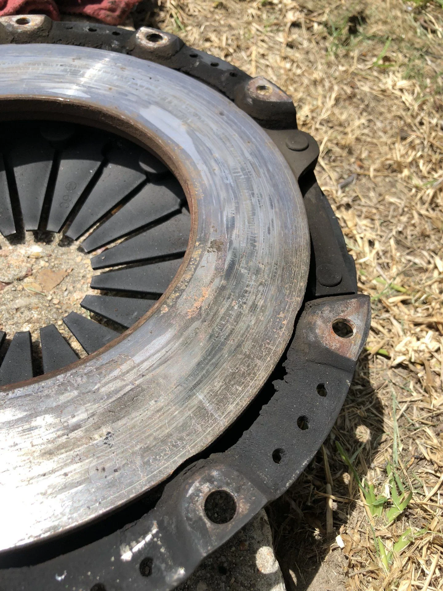

My clutch had 300,000 miles on it and it didnt slip. I put an aisin in with the h55f.
The pressure plate was hot spotted to death, but it all still worked.

Yeah you can't use that pressure plate but I'm sure you know that. Hotspots what causes chatter on the clutch disc. I think it was very rarely that I would ask the customer that they would have to replace a flywheel. I always sent the flywheel into a machine shop to have it turned. Sometimes I shake my head why was I in the auto mechanic business in the early 90s I really didn't make much of an income it at all. But it's good to do something that I'd self-taught and I did hundreds of cars and those several years before I switched into information technology.

I resurfaced the flywheel and used an Aisin Clutch from rock auto. 25k since my swap with no issues.
