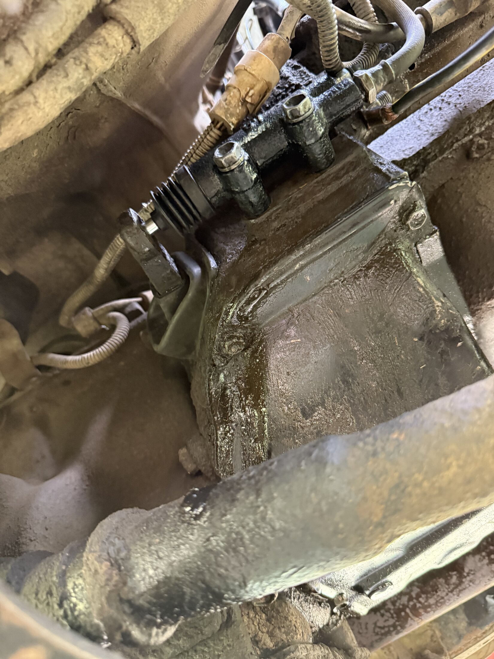

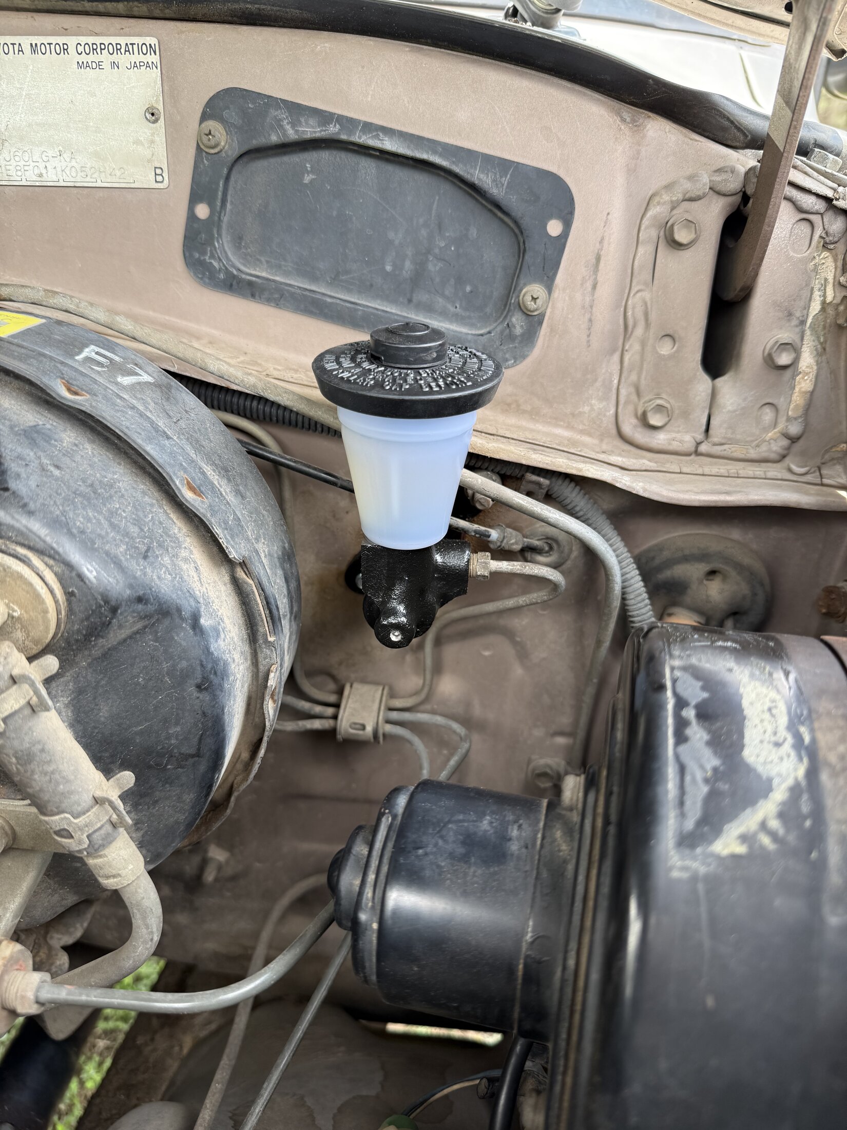

Was having the exact same issue. Fluid was leaking down my firewall behind my clutch pedal. My master cylinder bit the dust. Replaced both the clutch master and slave cylinders with Aisin and some questions answered by @CenTXFJ60 and I’m back in business. Drives “like new” again. Easy job, took about 45 min to replace both and then another 15-20 ish min bleeding and you’re good to go. You got it!
