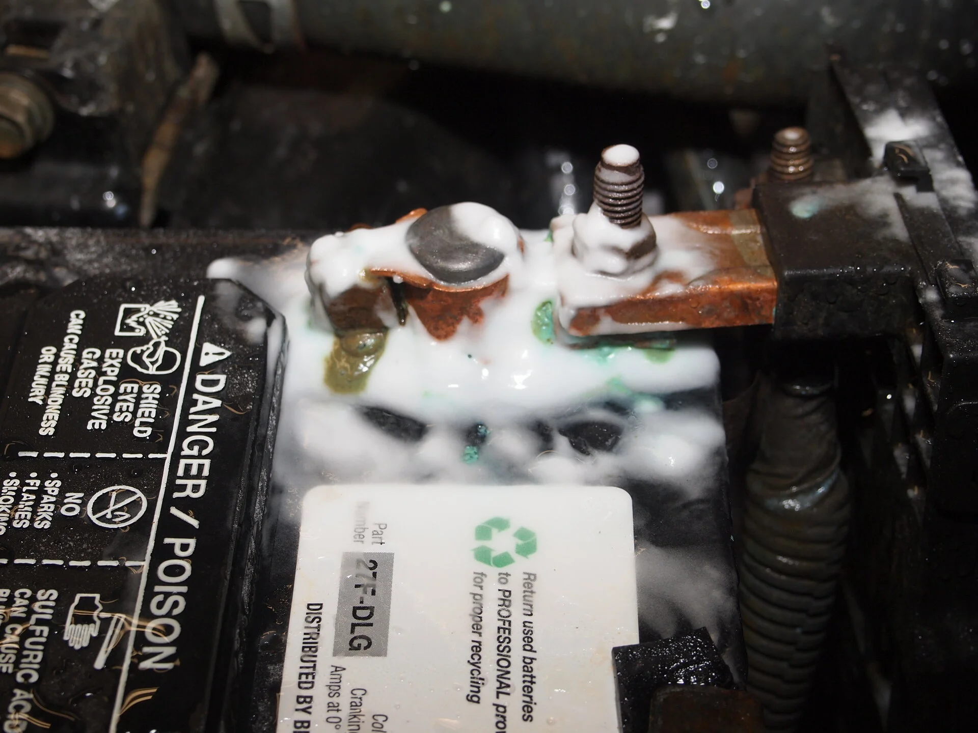

Mist battery with water, than poor baking soda all over it while wet. Than misting the baking soda with water, making a slurry. Baking soda will neutralize acid. Rinse slurry off and repeat. You'll know when acid is all gone, when no blue appears in slurry.

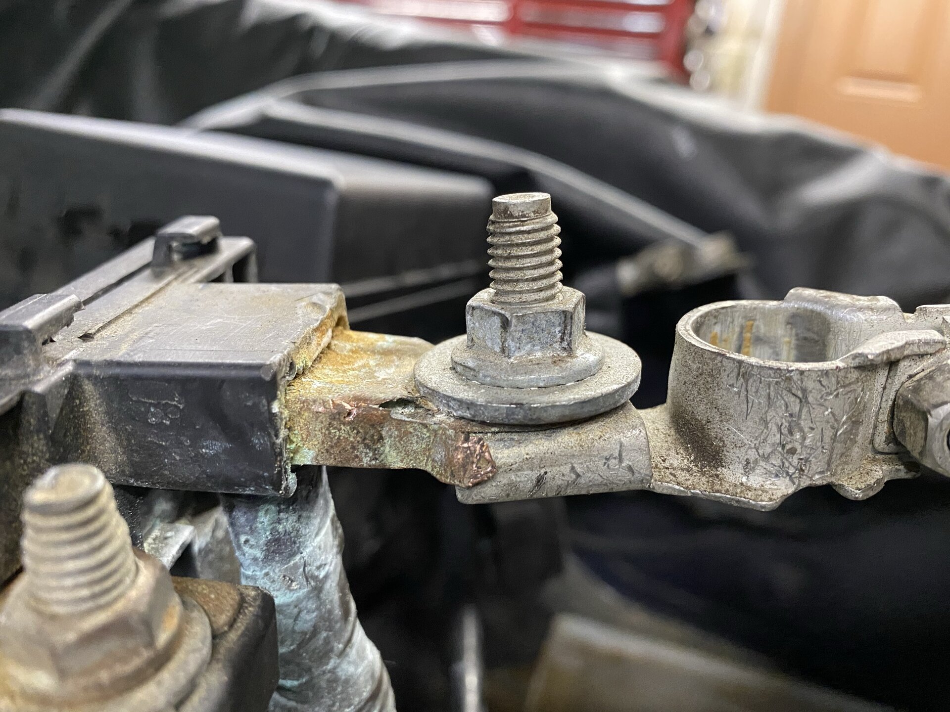

Clean Battery" also. Always dampen battery lightly with water first. Then sprinkle with baking soda. Some pre-mix water & baking soda, and pour over battery. Baking soda neutralize the acid. Otherwise acid will run with water onto metal parts, and eat them.

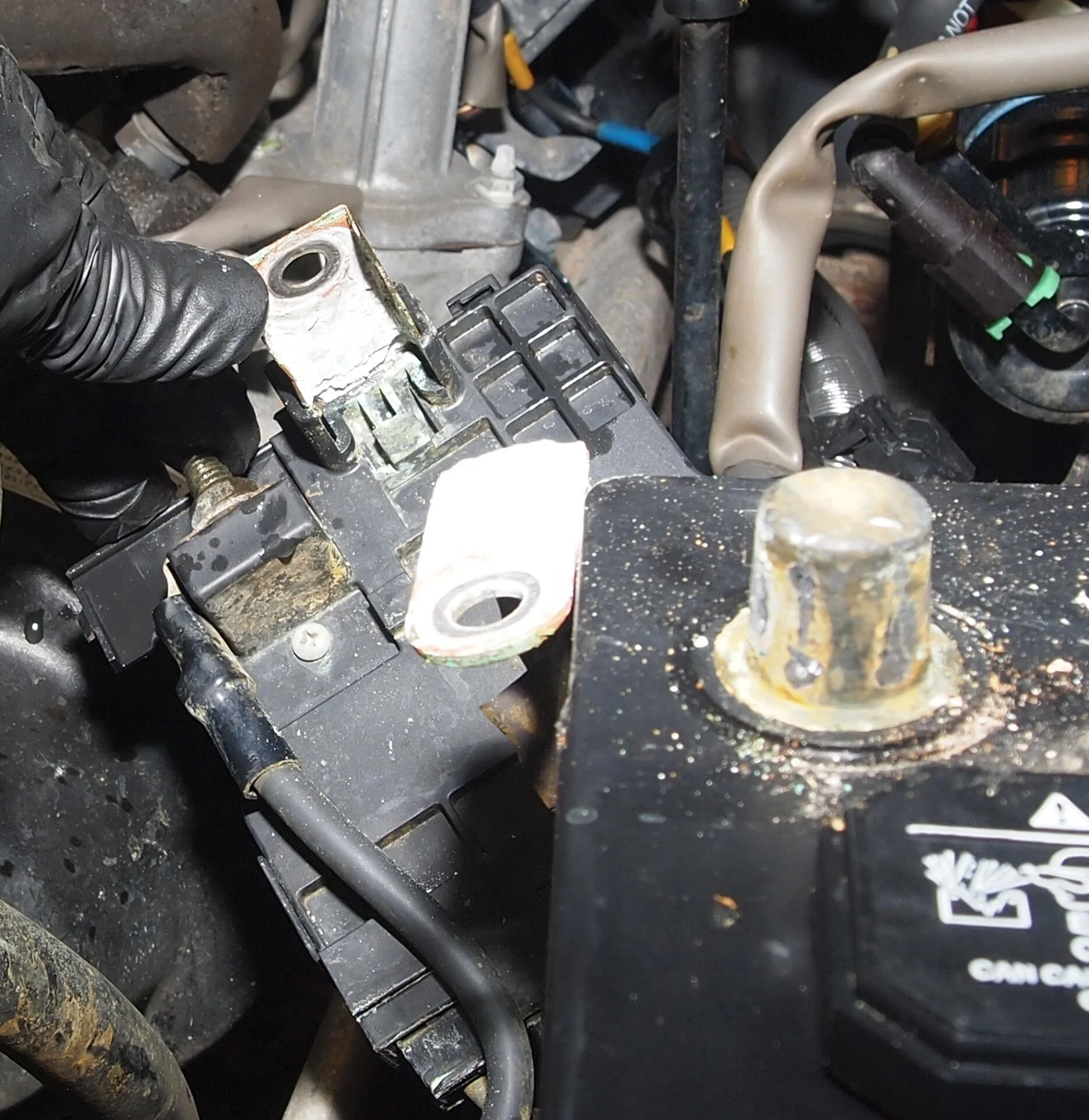

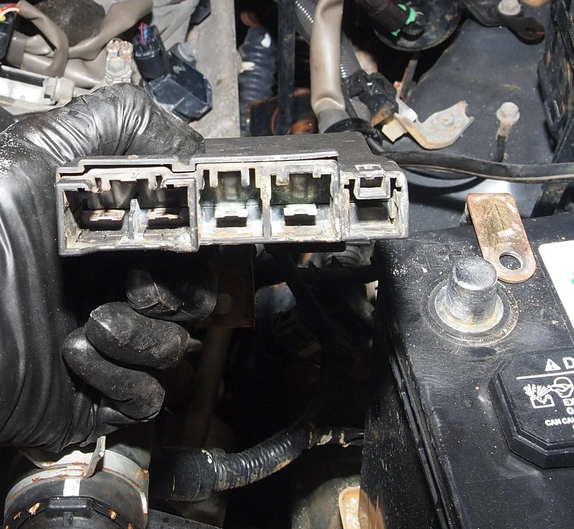

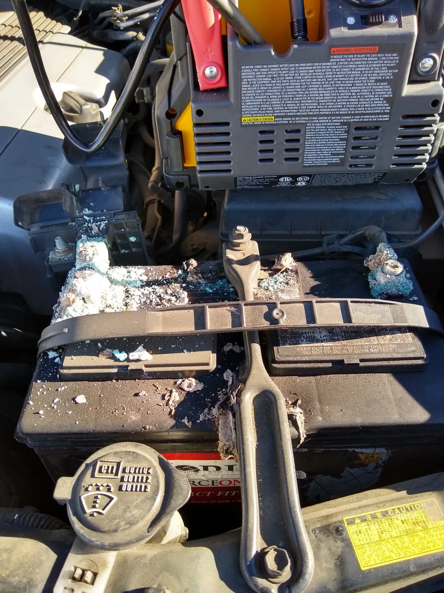

Do not let the white powdery substance build-up on battery cables. It grows and will getting into wire clamps & block, damaging & increasing resistance reducing voltage..
Baking soda solution clean, all standard lead acid batteries. The blueish green is acid, not yet neutralized.
