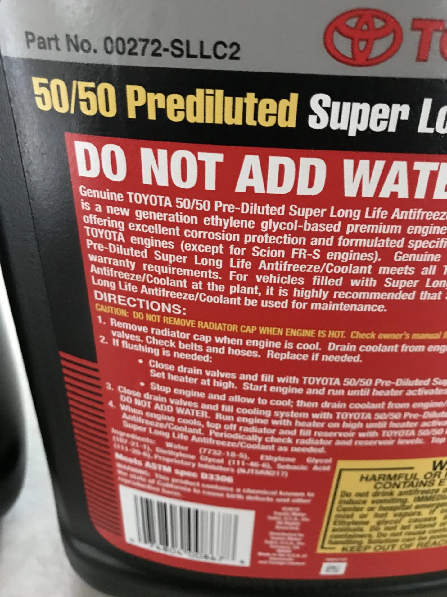

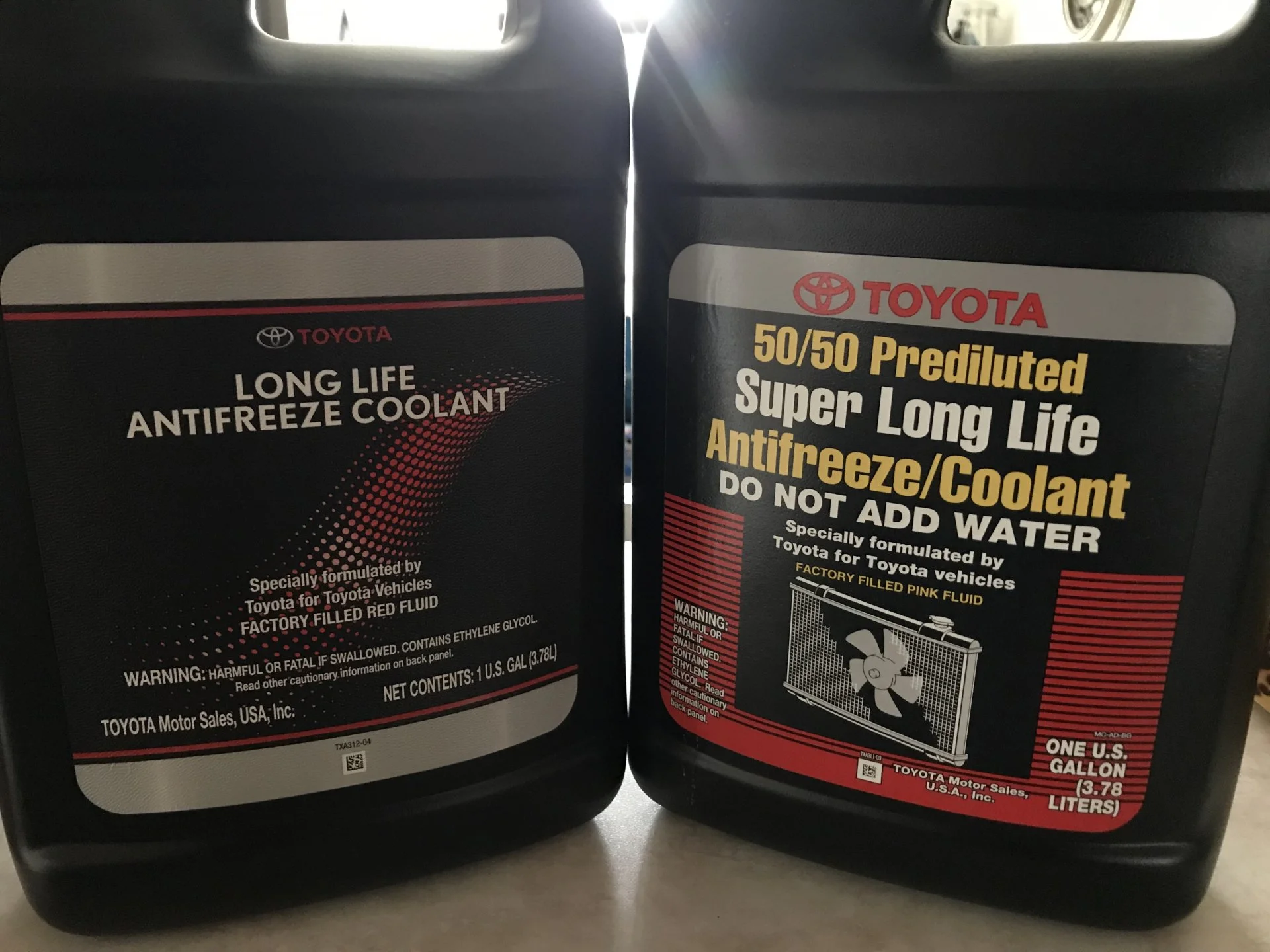

Hey y’all so I’m here going through my cooking cooling system and doing some base line. I have been flushing it out with distilled water (on flush #3) and I need someone to just give me a quick sanity check. I was able to get the Toyota red (undiluted) which I plan to mix myself. I calculate how much distilled water remains in the system once I drain but the question is on the coolant itself. I have this 50/50 which I was told is Toyota red but it says pink on the bottle. I really don’t trust the order takers at the parts counter. (Remember the Toyota service technician that told me the factory lockers were “after market”🤯)
can someone confirm I’m good with using this and the “pink” is really Toyota red and turned pink with the 50% water plus 50% Toyota red?

Thanks George, the issue with the green coolant I have is I’ve read it contains certain additives which are not compatible with the rubber gaskets in the found in the Toyota cooling system. I’m fine with debunking this and settling it.
rather stay on this course, I’m fine with the few dollars more, may be helpful for the small group of 80 owners who are in this same boat
Just stick with the red, I wouldnt mess around with the pink. Also being in Florida where you most likley don't see extremely cold temps you might consider going with a 60/40 or 70/30 mix. More water will give you more cooling.
Please do you search and there are many threads cover this in details. For what I can remember. the Toyota long life read (Part#: 00272-1LLAC) is the OE coolant for these rigs. That's the one I have been using for the past 20+ years with peace of mind. Unlike the pink coolant that Toyota switched for later model, they did recommend to replace the red coolant every few years.

Cackle cackle... Special toyota rubber gaskets.... Nope...
Anyhow, I ran red for many years (original owner of our 80). All that is special is the cost/availability.

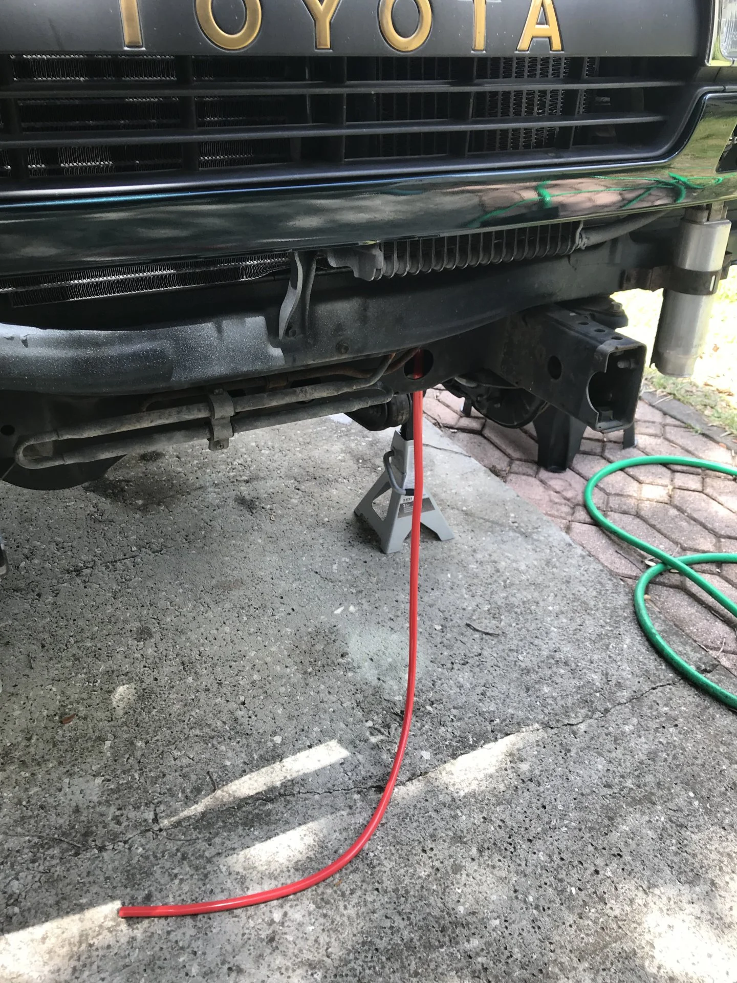

Thanks y’all - I’ll prob order the radiator and sand bag it then. I got a 1/4 and some extra new gas hose to catch and measure what is coming out. I’m on flush #4. That $13 drain cock replacement from wits end is perfect.
not using any chemicals, just regular old distilled water
