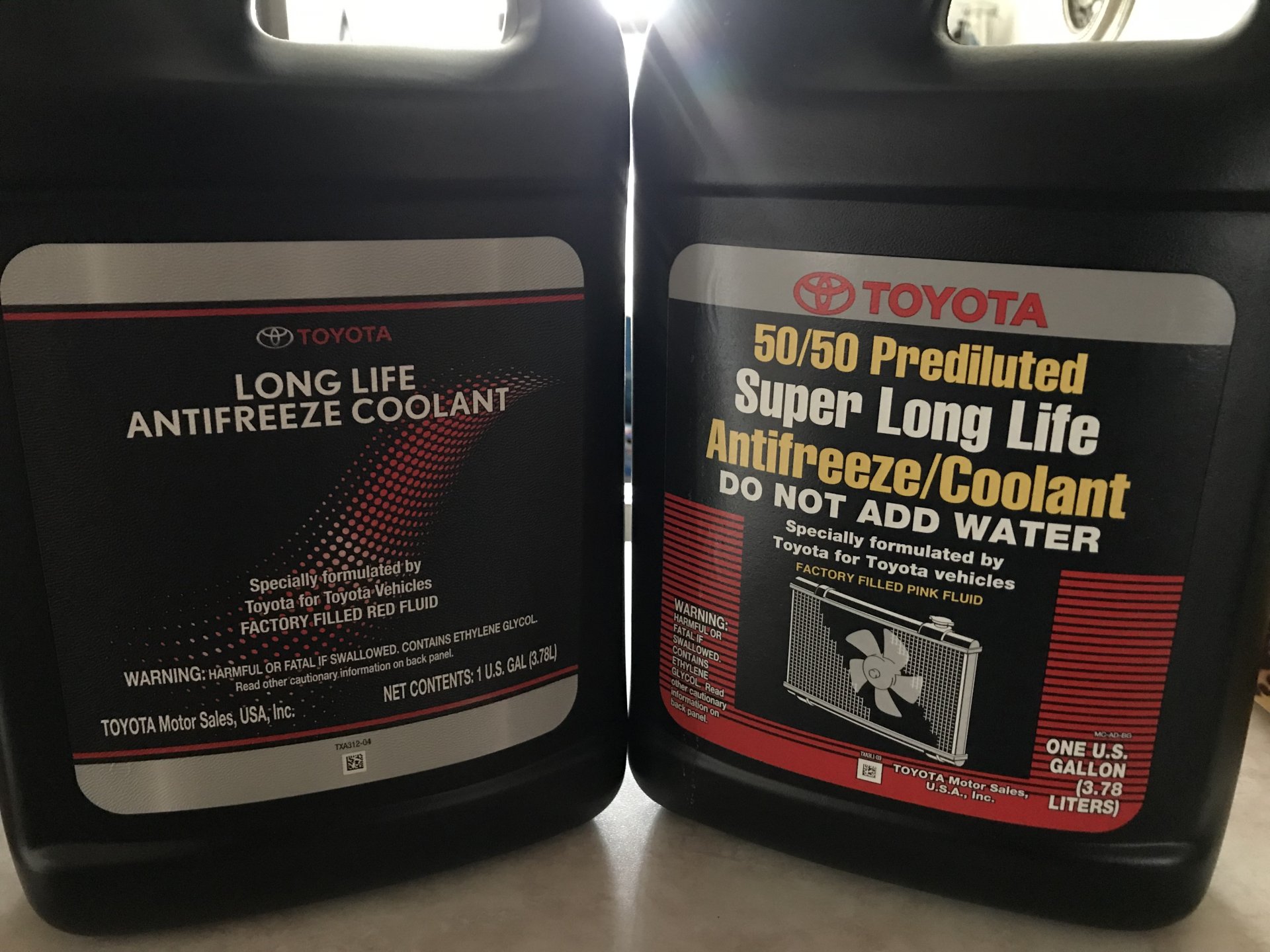

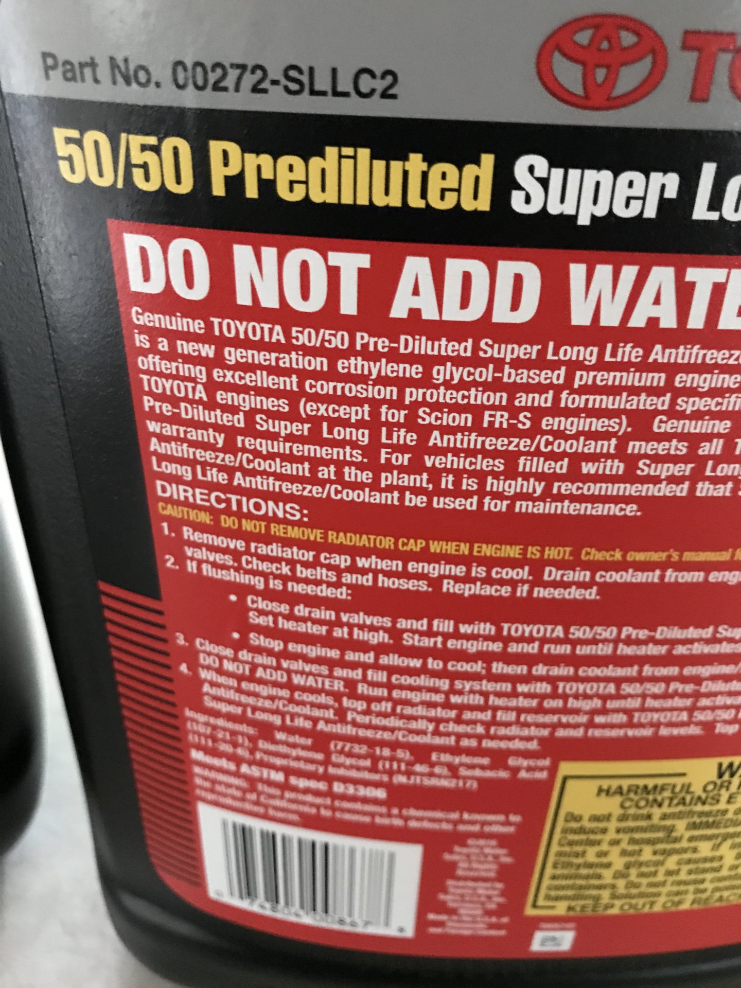

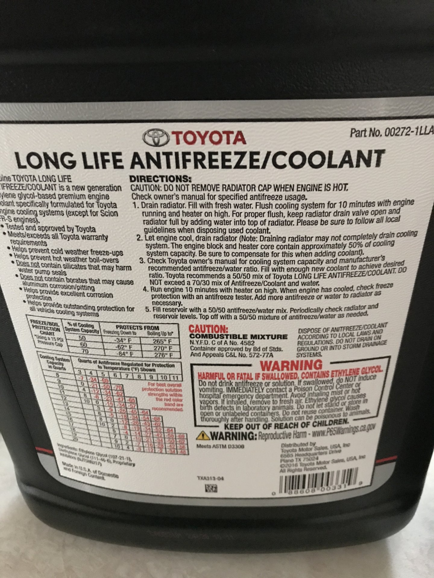

Just to clarify to all for those who wish to remain in the red coolant category:
Super Long Life Coolant - Toyota ( 00272-SLLC2 ) (Also says "pink" on the label) is not the same as Red Toyota Antifreeze Coolant (1 Gallon) - Toyota (00272-1LLAC-01)
The latter, toyota red, is designed for the older toyota models and must be mixed with distilled water (either 50/50, 60/40 or 70/30).

Hey y’all so I’m here going through my cooking cooling system and doing some base line. I have been flushing it out with distilled water (on flush #3) and I need someone to just give me a quick sanity check. I was able to get the Toyota red (undiluted) which I plan to mix myself. I calculate how much distilled water remains in the system once I drain but the question is on the coolant itself. I have this 50/50 which I was told is Toyota red but it says pink on the bottle. I really don’t trust the order takers at the parts counter. (Remember the Toyota service technician that told me the factory lockers were “after market”🤯)
can someone confirm I’m good with using this and the “pink” is really Toyota red and turned pink with the 50% water plus 50% Toyota red?
Thanks y’all
