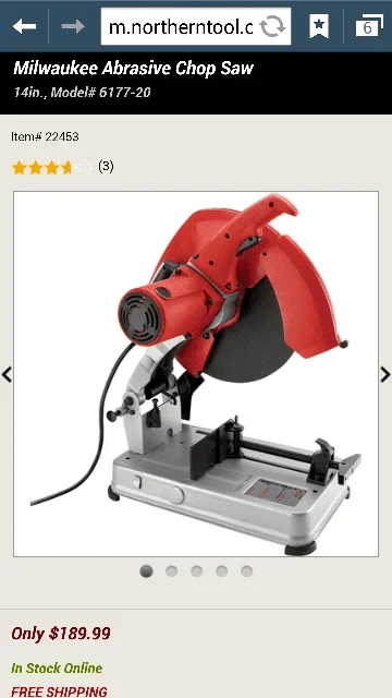

I'm looking into getting a 14 inch chop saw instead of a cutting torch since my garage is attached to my house. I don't want the danger of my house exploding. I know I won't be able to do everything I can with with a torch ( bend metal, cut shapes, weld, ect.) but I want to be able to cut metal for most of my projects and if I NEED to use and torch, I have 4 at work...
My problem is I've only used the Dewalt pictured, and it is excellent. It cuts anything I've thrown and it! ( 2 inch round stock is the thickets I've had to cut)
Here are the 3 I'm looking at:
If anyone has any knowledge here, I'm all ears! I'm not limited to these three, so if someone has one that they love, I'd be willing to hear!!
