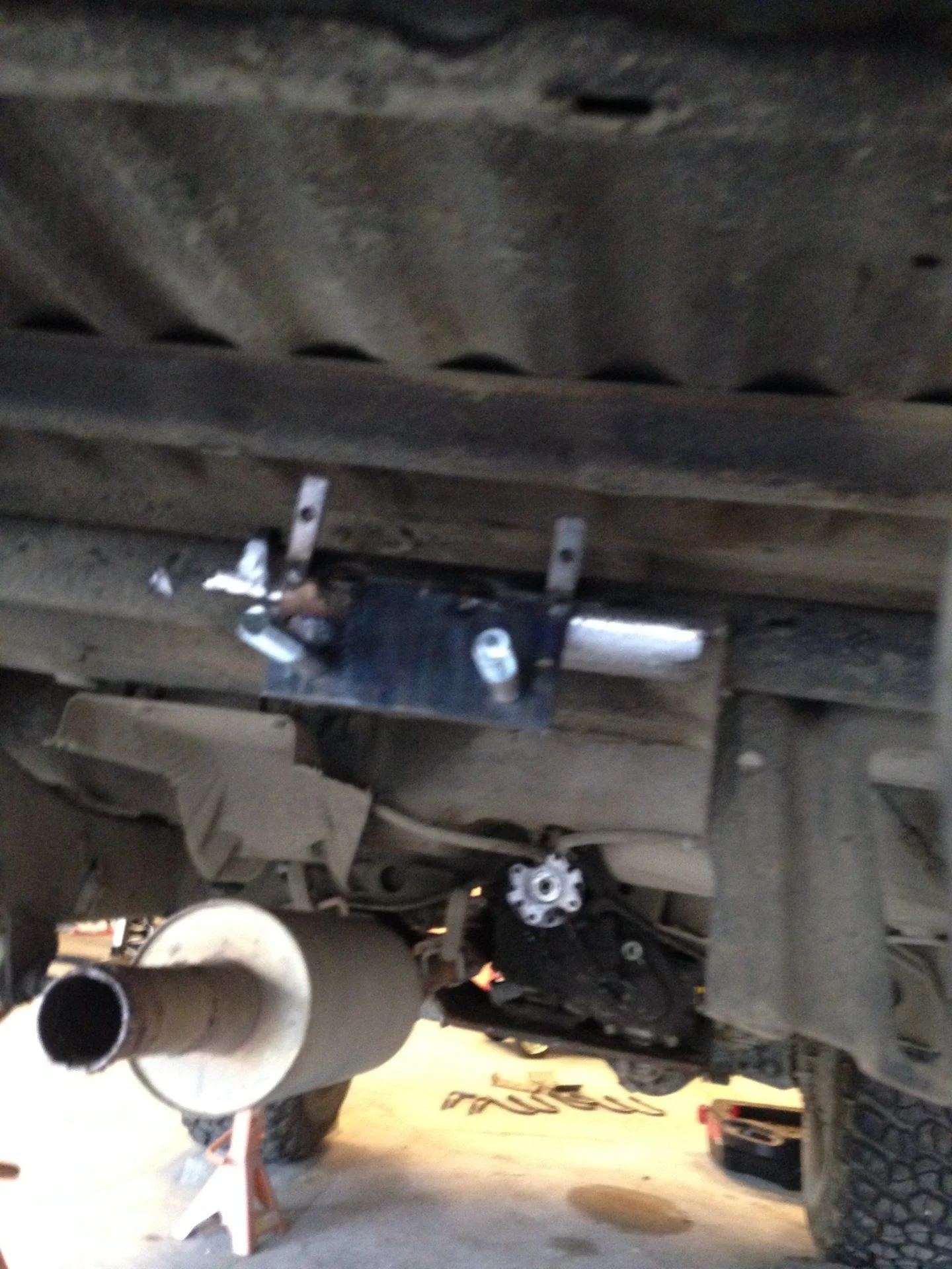

Do I have to remove the gas tank to weld on the passenger side spring hanger?
No you don't have to, but it would be easier to weld if you do. You can get away with only welding three sides of the hanger and by filling a 9/16" hole in the middle of the hanger with weld. It will work. Just make sure you keep the gas tank skid plate on and shield it also.

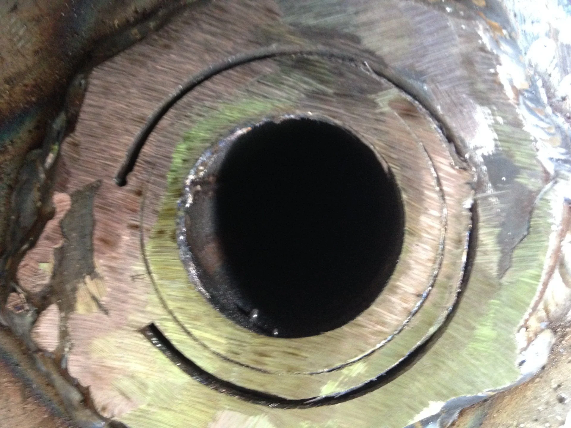

I sleeved fuel tank support. Some have had problems with them cracking, obviously not a problem for yours. Mine are pushed more inboard.
