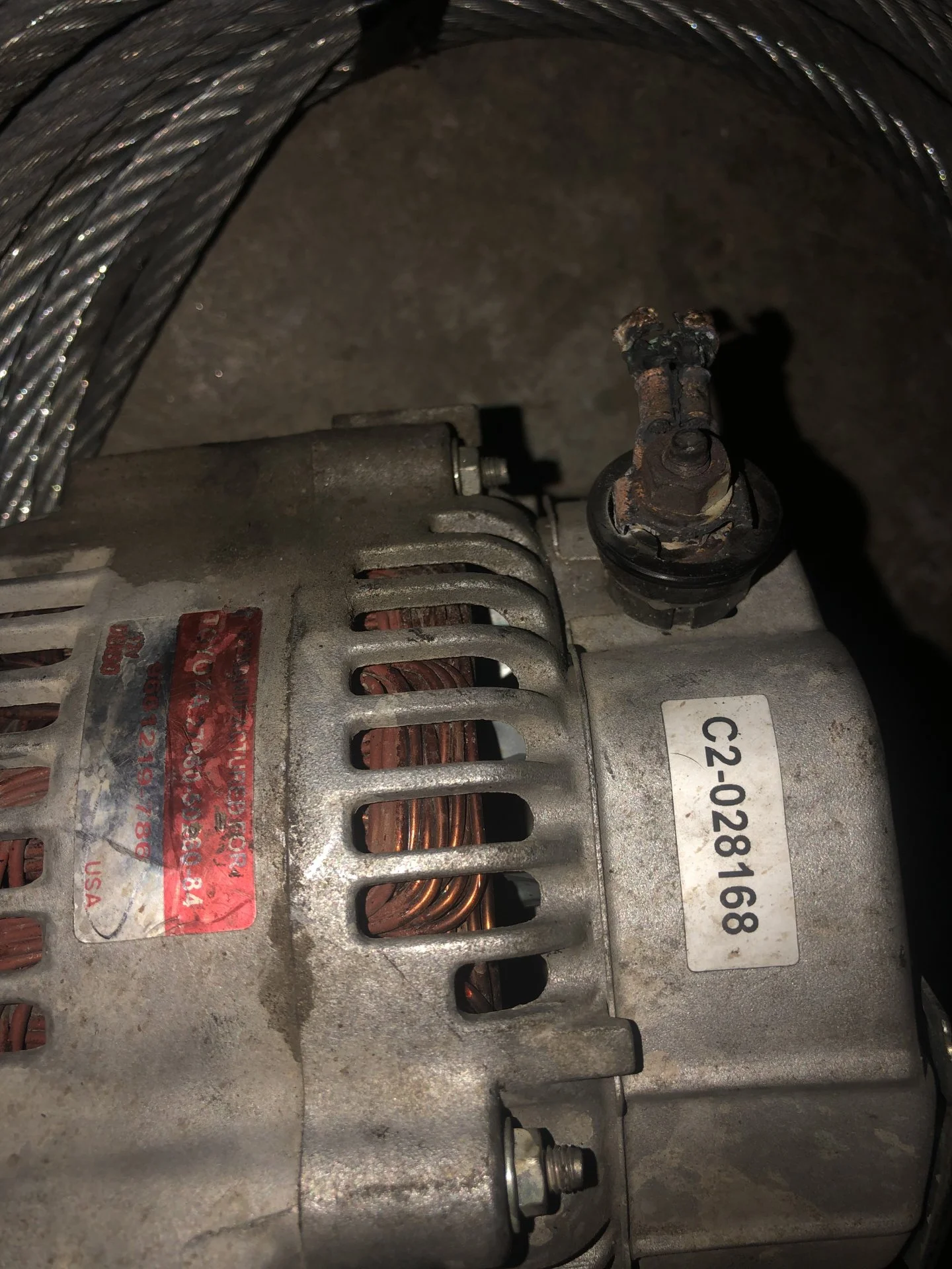

So I was having intermittent charging problems and went to have the alternator tested and was told the voltage regulator was bad. It started working again and I went to replace the alternator and found the charge wire was corroded and broke off. I’m going to upgrade to the 130 amp alternator and wanted to see what other people have done to rebuild the cable as it is not cheap to get from Toyota. I don’t know what gauge it is currently if anyone knows or what gauge they would recommend. Not interested in doing the biggest thing like 1/0 but either replace same size or upgrade just enough for the 130a. Are all years hundy have the same gauge? 2000 model.

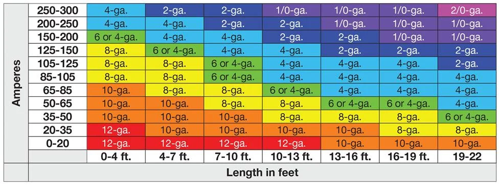

Best I can help is with this link here. If you decide to run new wire, there's a formula for the length of the wire and amps which will let you know what gauge is needed.
>> Looks like at 4-10 feet of cable length between 150-200 amps they suggest 4 gauge wire.

IIRC the main cable connecting the alternator (broke by the OP @thetoyotaman) is coming directly from the battery right? So would you not just get a 2 ga cable and replace it using the chard that @Mike NXP provided? Yes I am sure routing it back to the Battery would be a Pita.. but it could be done..
I dont think it would be very expensive to get it done.. you will not need anything more than 4-7ft cable. and why choose 2 ga cable? cause in this case bigger is indeed better.. as long as you can route the cable through which should be possible.
Go to a welding supply store and get those nice welding cables. Not sure about pricing but should not be more than $5-7 a ft max at 2022 pricing. Also make sure the wire is 100% copper and not copper-covered aluminum wire.

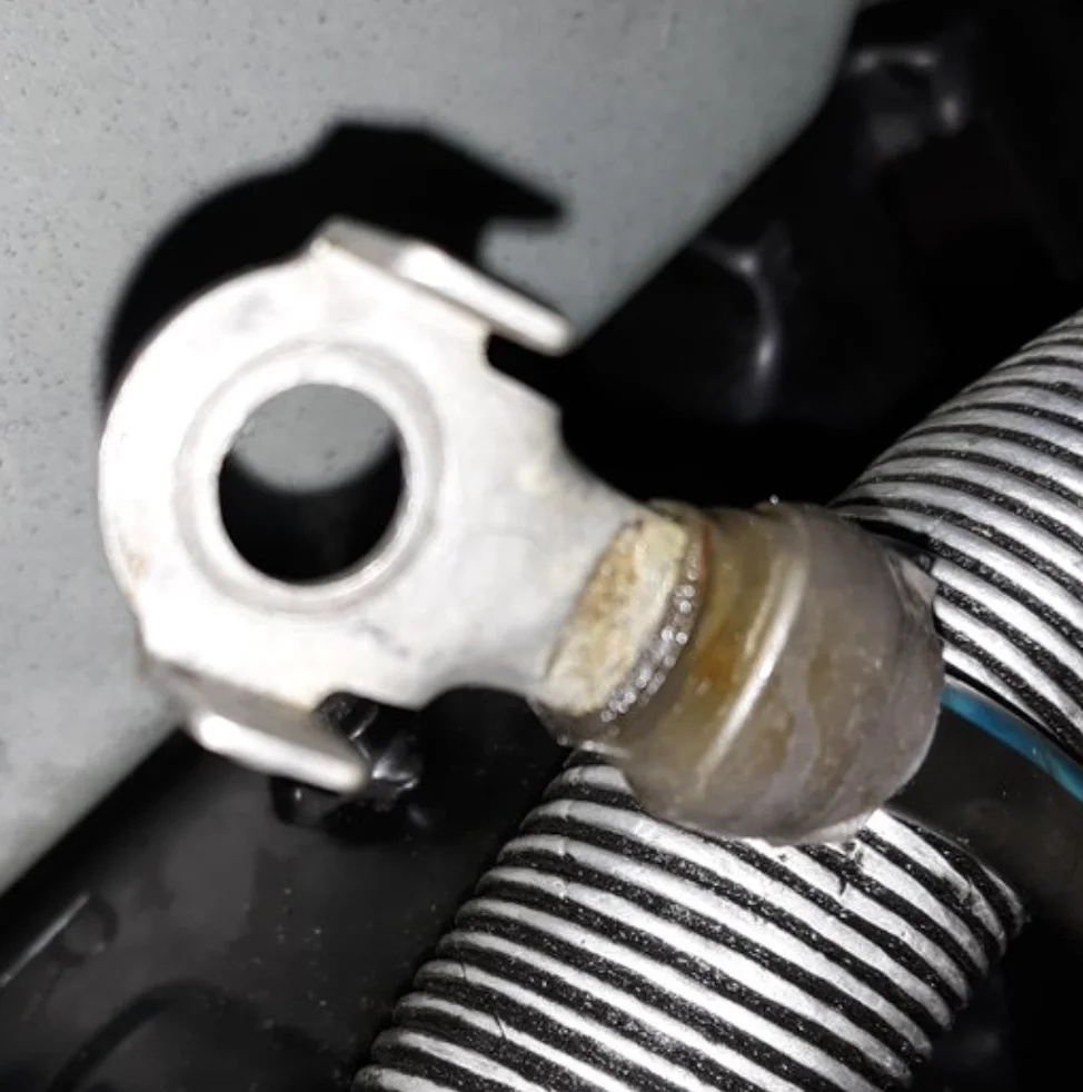

The original terminal has a bit of detail that is nice. Locks the terminal in a right angle with the alternator. Prevents the terminal from loosening and/or grounding the terminal. Would be difficult to find a replacement terminal like that. But if you wanted that feature, I suppose you use the original terminal OVER the new terminal like a washer (cut off excess) and it'll work, granted the 'prongs' are long enough.
Completely unnecessary as most other manufacturers use a standard lug terminal but maybe this is why we buy Toyota.

The terminals I use don't have that anti-rotational/alignment tabs unfortunately. I could take a look. The disadvantage to this type is that I believe the wire strands of the cable are exposed to the elements. Pros and cons I guess.

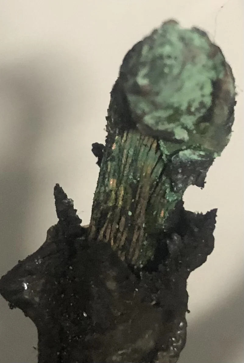

The charge cable is no where near a 4 gauge from the factory. It's small. Actually, 2 wires. What I don't understand is why they are so small compared to the chart recommendations. I typically make my own stuff and this is a good time to invest in a crimper if anyone has an economical one they reoommend. But I like those options. I was just trying to understand why they are so small from the factory and if the chart is really necessary to go by or correct. And why did it corrode at the alternator?
So I was having intermittent charging problems and went to have the alternator tested and was told the voltage regulator was bad. It started working again and I went to replace the alternator and found the charge wire was corroded and broke off. I’m going to upgrade to the 130 amp alternator and wanted to see what other people have done to rebuild the cable as it is not cheap to get from Toyota. I don’t know what gauge it is currently if anyone knows or what gauge they would recommend. Not interested in doing the biggest thing like 1/0 but either replace same size or upgrade just enough for the 130a. Are all years hundy have the same gauge? 2000 model.View attachment 3145338View attachment 3145340

Yes. I cut off the bad end off the cable, crimped on a new terminal, and used the anti rotating end off the Toyota connector on top of the new when I bolted it down and all is good. In the US for the 2UZ-FE there was the option of 80, 100, or 130A over the years. I simply bolted the later US 130A alternator from the 2003-2007 years and repined the newer style connector as mine was brittle and had to be replaced anyways. Working great.
