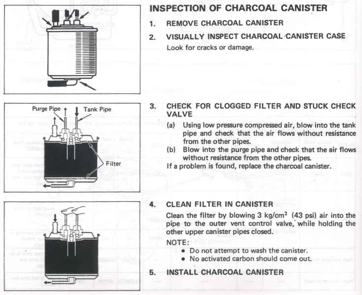

I have an '85 FJ60 with desmogged 2F. I believe my charcoal canister is causing problems. I will test it per the FSM. A search for charcoal canister pulls up several screens of good info. I'm trying to understand what inputs and outputs (vacuum and gasoline vapor?) flows in what direction thru the thing. Meaning what goes into the canister where and what comes out and where. I have not found this info.
Also there is and electrical gadget of some sort at the top of the canister
If anyone can give me a rundown of the plumbing on this thing and the function of the electrical gadget I'd greatly appreciate it.
I assume the "purge pipe" is manifold vacuum and the "tank pipe" is for gasoline vapor from the fuel tank but do not know for sure.
My canister looks like the diagram below: three pipes on top and one on the bottom. The two small ones on top are labeled "purge pipe" and "tank pipe". The large top pipe is not labeled. The bottom pipe is not labeled.
Thanks
Jim
Bottom is vent, it goes into the frame rail to nothing. The one that routes from the driver side is evap/purge, the one from passenger is tank. Just follow them.

At this point, all original charcoal canisters have obstructed or partially obstructed check valves on the "Tank" pipe nipple going into the canister. There's no way to clean them. The check valve is there to prevent air (and moisture) from migrating back into the gas tank. When the check valve obstructs flow, the gas tank can over pressurize and vapor lines can leak )or get blown off or seams in the tank can split.
The easiest cure is to just swap the purge & tank hose, but then that interferes with the EVAP system (which is an emissions system).

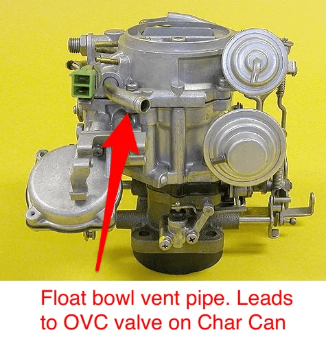

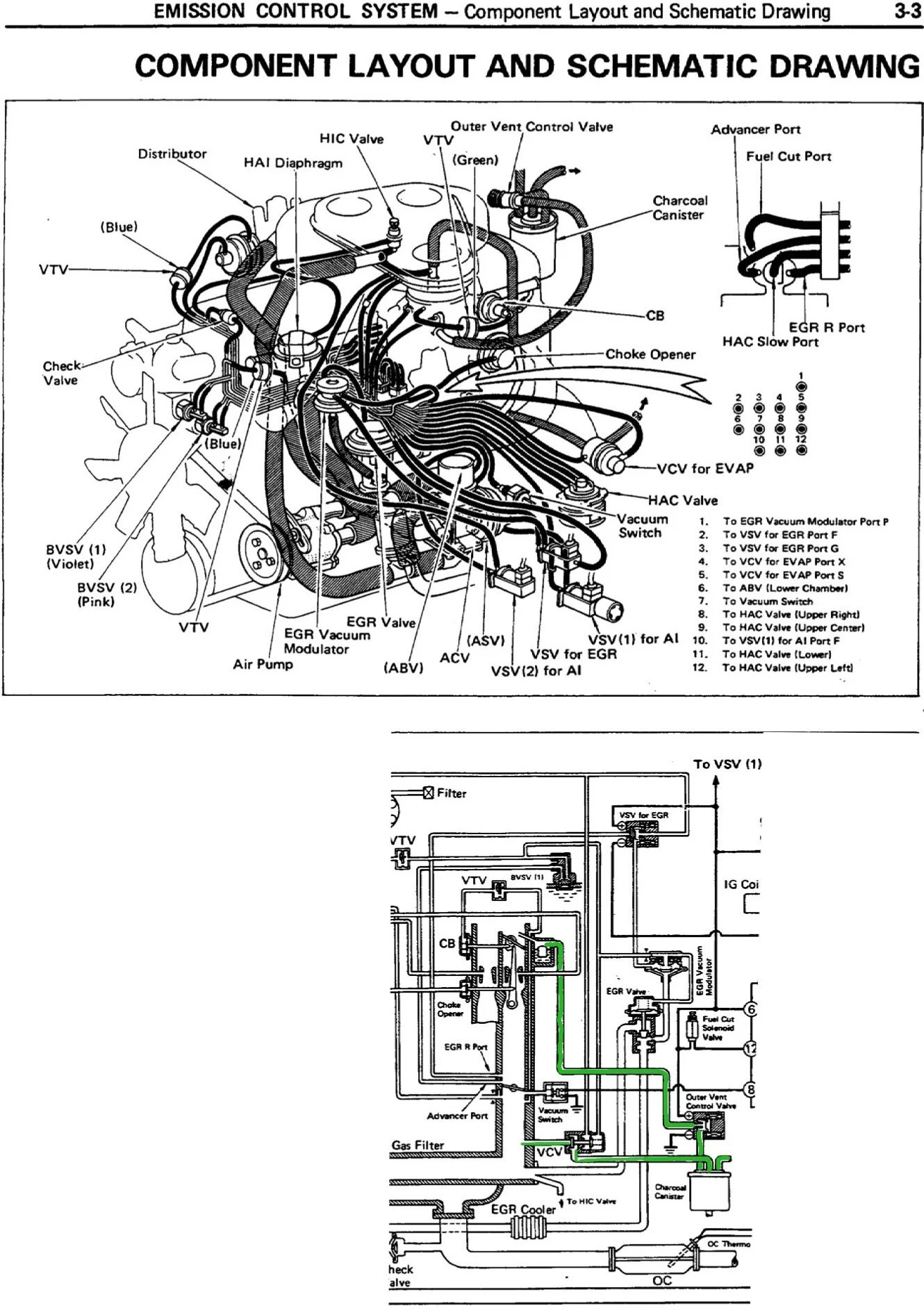

That big solenoid above the char can opens and closes the vent to the carb float bowl. It needs to be closed when the ignition is ON, otherwise starting can be difficult.
Also steep climbs and full tanks can sometimes purge liquid gasoline into the tank vent pipes, which gets sucked into the char can and then sucked into the base of the carb- flooding it. = black smoke.
I feel like a wicked green newb now. Where and what is this on the carb.... flipping urgently through my emissions pages.

The Outer Vent Control Valve above the canister is easy to check.
With the ignition key OFF, pull the big vent hose that connects to the big vent pipe on the side of that carb up top- that goes into the float bowl.
Blow air through it (with an extension hose so you don't get gas fumes in your mouth). Air should flow.
Then turn the ignition key to ON (but don't start engine) and do the blow test again. There should be no flow.

I may need to make myself a flow diagram of this system to understand it.

I went looking at the carb I have in parts right now and I wondered if you were talking that port on the carb. I turned the horn over and can’t see any type of valve inside but I’ll take your word for it.

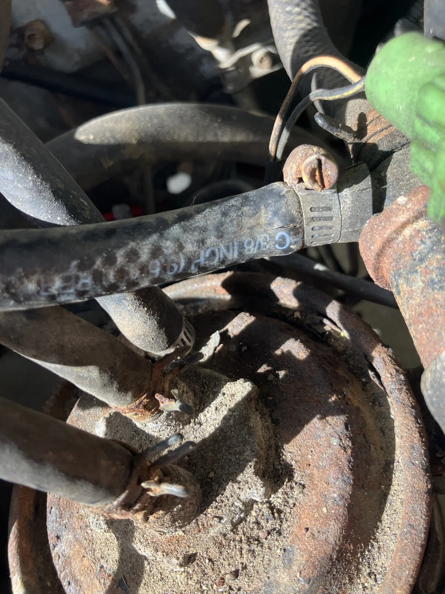

I have a loud pressurized whoosh also…
I have a desmog 60 with city racer carb. Which one of these gets swapped?
I swapped the 2 top hoses with the same clamps. I had the loud woosh when taking off the gas cap and now I don't. Also if I filled it up full and parked it the gas would overflow out the cap. This has been happening for years per evidence of my pic below and the permanent gas marks on the paint all because of the stupid charcoal canister.
Thanks! My truck has been running rough and I’m trying to troubleshoot. Hopefully this illuminates the hooch sound, and I was hoping it would help my idle, but it didn’t.
