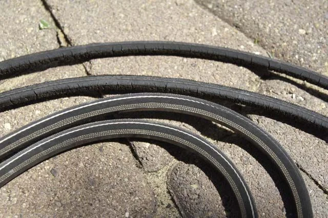

Good for another 20,000 mi
I think I could have gone another 20,000 on the old ones but what the heck I changed the belts today. I found it easier to remove the lower splash apron and go at the alternator adjuster from below.
