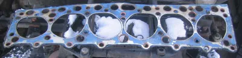

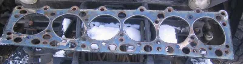

My head gasket blew and I am part way through replacing it.
I need an extra set of experienced eyes to let me know if something is wrong.
The pics are top and bottom shots of the bad head gasket as well as an overall shot of the block.
Please speak up if you see something wrong or need more info.
What I have so far: The head is at the machine shop and they said it has magnifluxed just fine. Not sure if they are needing to deck it or not. Also they are checking the seating of the valves.

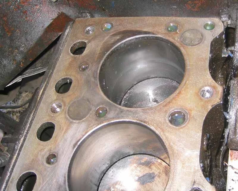

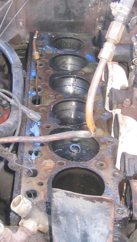

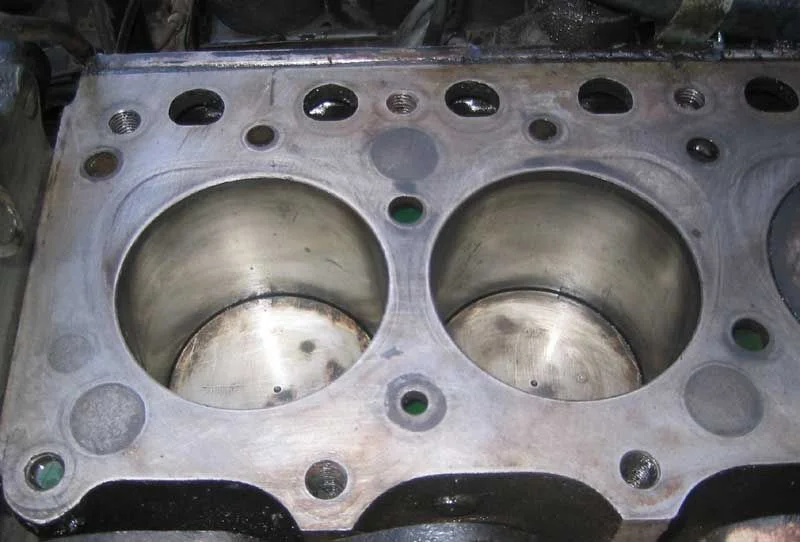

Cleaned up the block and put a straight edge across. Didn't see any warpage.
Couple pics of the 1&2 cylinders as well as 5&6. Battery crapped out before I could get 3&4.
The only thing I could tell is a small mark in 6 that I have a pic of.
Where exactly did it blow the gasket?.....is it between cylinders? I had this problem so I had the block resurafaced as well. The head was also resurfaced. After a year and half of driving it blew again. I have no idea if it was machined incorrectly or the bolts bottomed out. Or to much compression pressure....or a combination of the above. I have not taken it apart yet. My opinion is if have the head and/or block resurfaced make sure your bolts won't bottom out. just my 2 cents. Good Luck

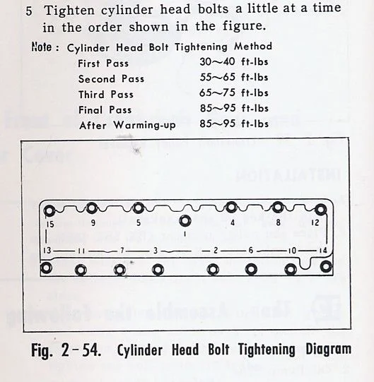

There has been discussion before on this, but I do think retorquing is most important. I did this after 50 miles of driving, but my engine was entirely rebuilt.
I retorqued the head bolts using the FSM sequence and found that they had all lost 10 lb/ft of torque. Then retorque the valve train and readjust your valves.

I agree with the retorqueing of head bolts.....just like the manual says after you run it. I also used toyota head gaskets and yes they are better quality than the felpro one and the Japanese one that I have lying around. Cleaning the thread and lube the bolts during installation also should be done. That way you have a genearal idea that each has pretty darn close to torque the manual says you need.

I've blown 2 head gaskets in the last 3 months after my rebuild. The first gasket came from SOR when the engine was rebuilt, and we figured it was flawed. Replaced with another one (I think toyota) by a mechanic. That lasted about the same amount of time.
Both burnt off back by Cylinder 6. I'm still working out understanding why.
