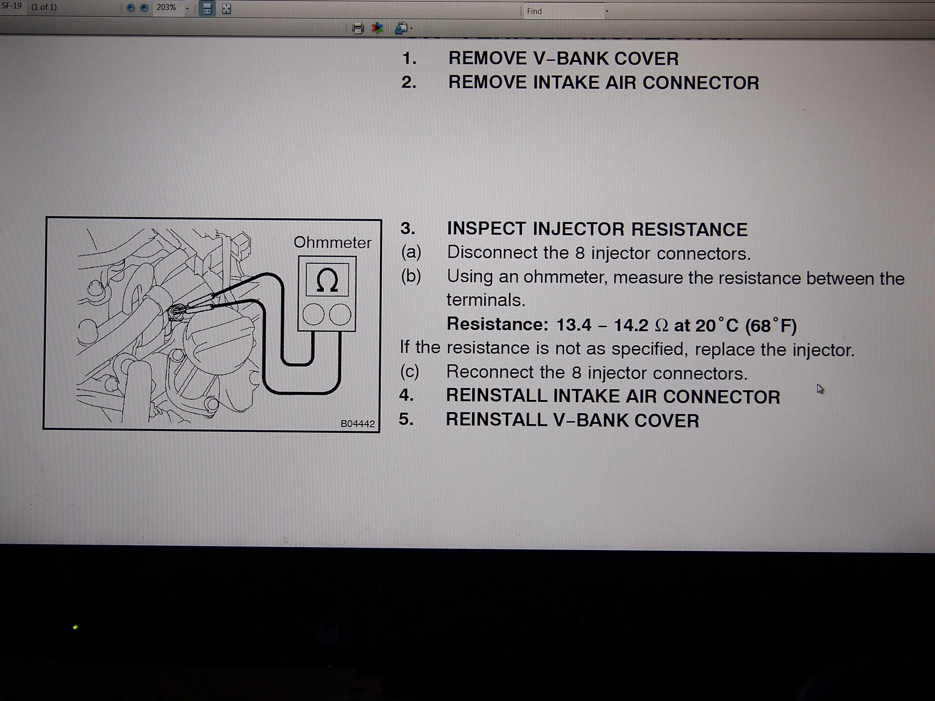

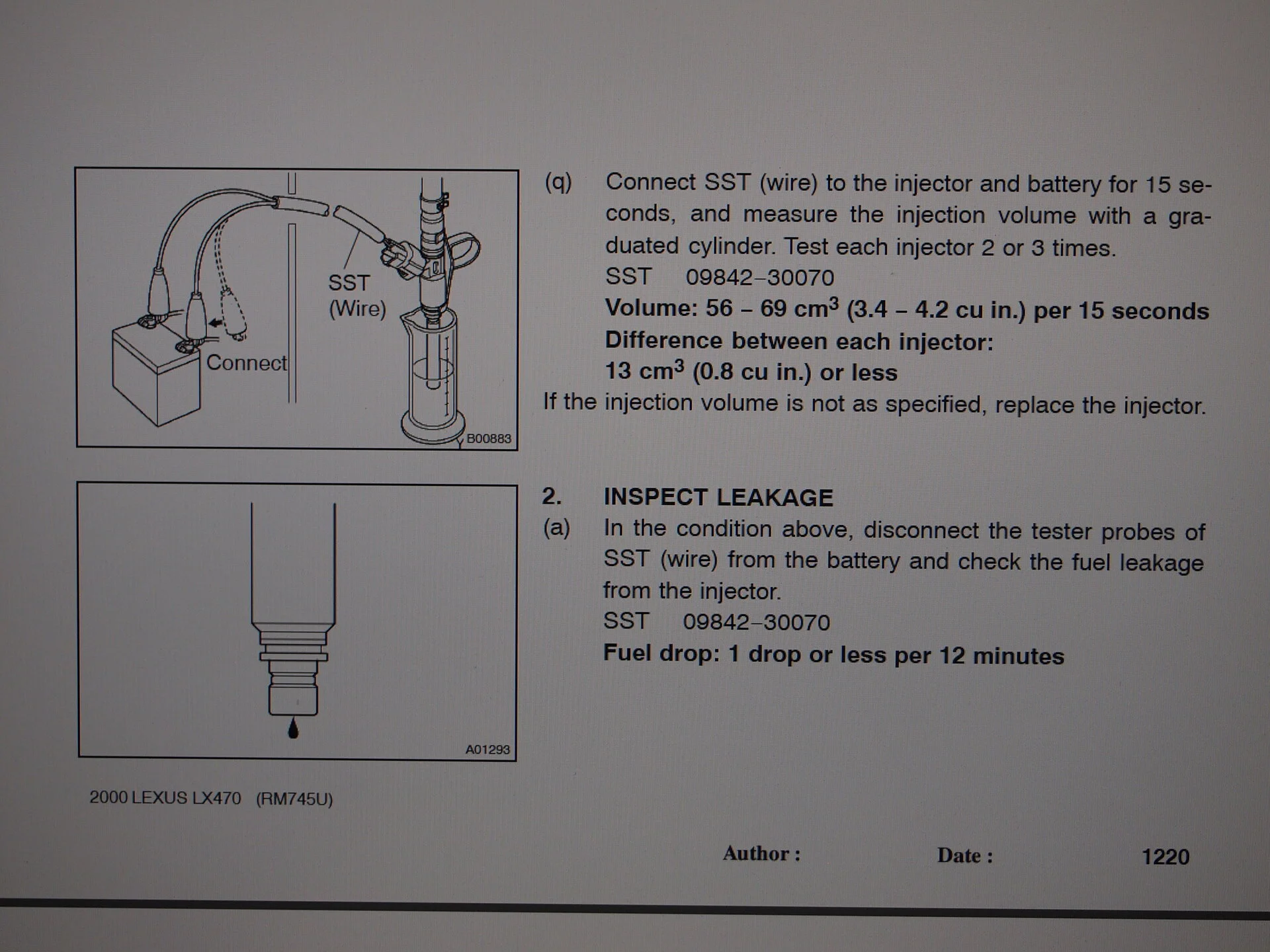

- Cleaned fuel injector electrical connector and measured 15 ohms for the injector (same ohms as good #3 cylinder)
