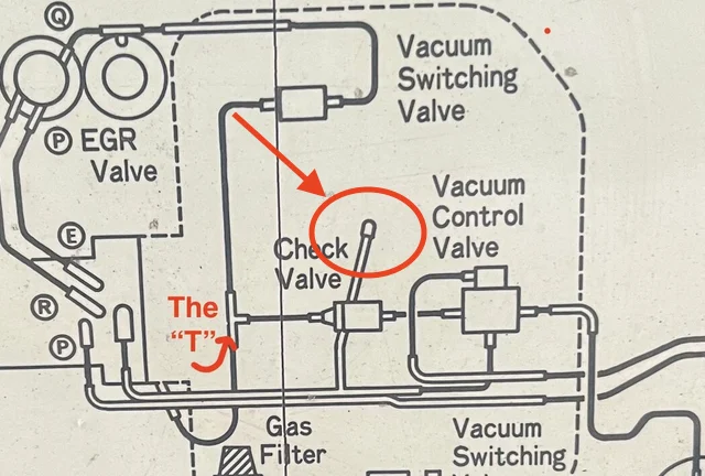

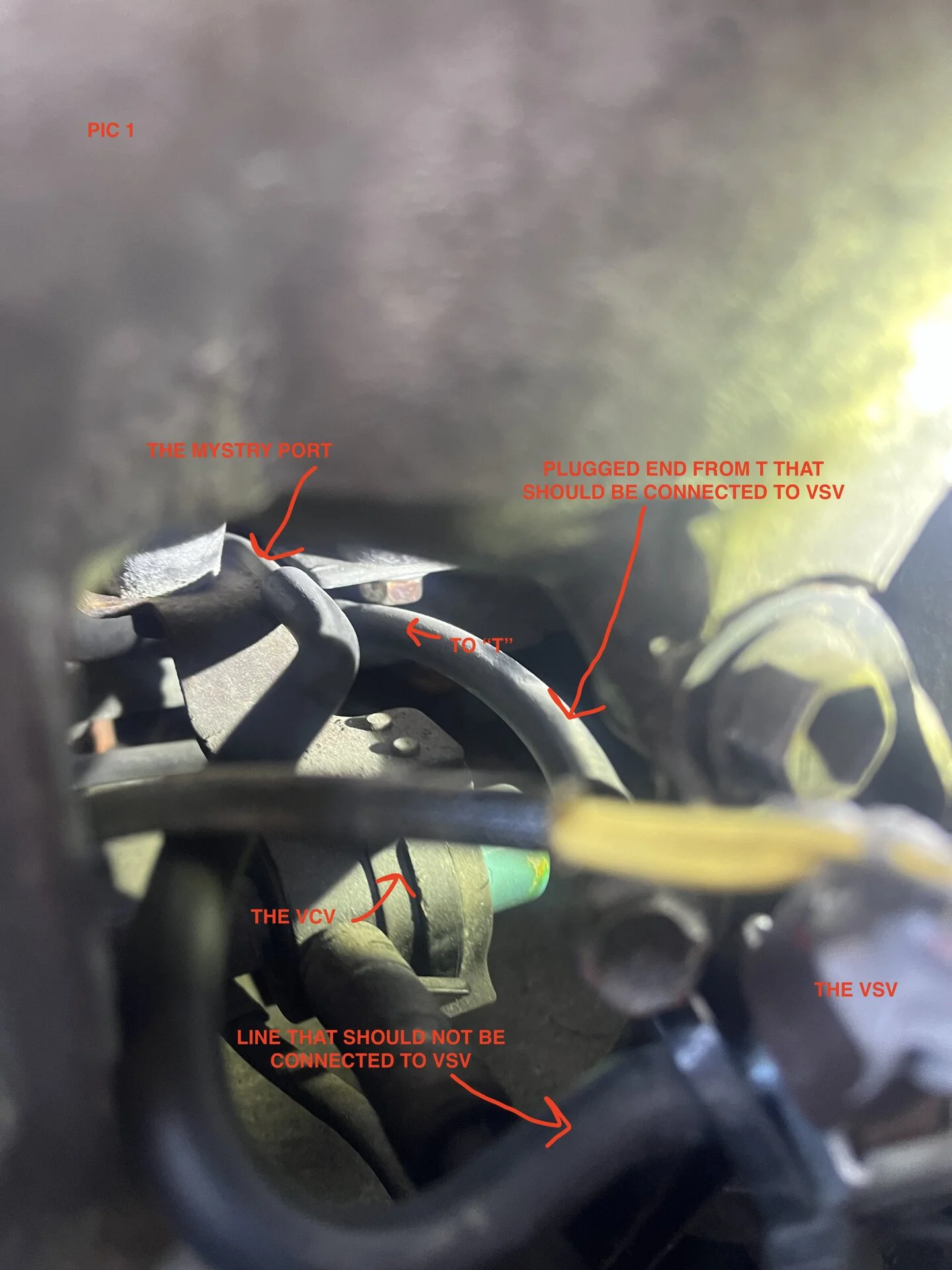

As title states, some vac lines are connected improperly. Specifically,
  • The line from the "T" (see diagram) to the VSV has been plugged
  • One end of the VSV correctly goes to the EGR, the other goes to a mystery(to me) port.
I know I need to connect the plugged end from the "T" to the VSV.
I do not know where the line that is currently improperly connected to the VSV goes and need help identifying it and routing it to the correct location or what to do with it.
Pics:
Please let me know if you know where that line is supposed to go.

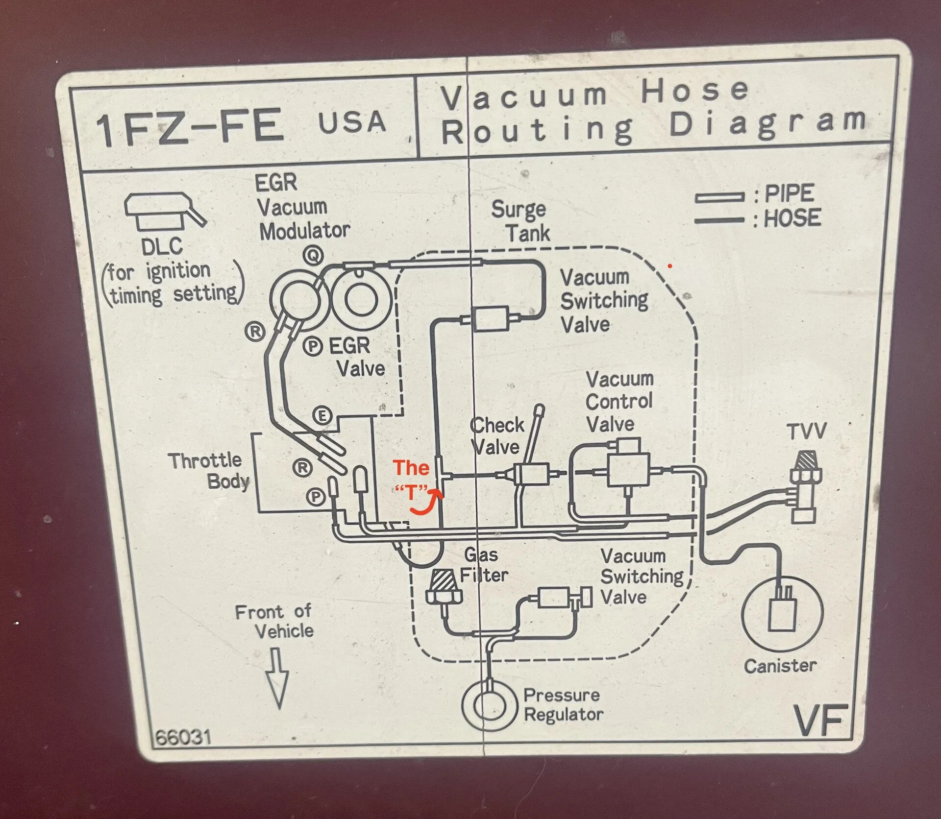

That's your issue right there. Download it from the resources section. Free-fer-nothin.
Pages EC-2 and EC-3.

The best diagram (below) shows the VCV but does not show the bracket its mounted to. In my pic above my VCV is attached with a bracket that has a metal hardline port on it. Similar to the one for the VSV.

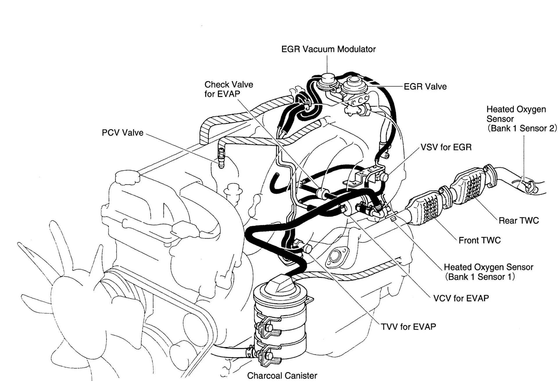

SOLVED! Turns out this hard line is the port that should be capped. see photo from the diagram under the hood. Not sure why this isn't shown in the EC-2 diagram but that's what it is. I had to remove the bracket to access the area below the intake manifold and press my head down in the engine bay as far as I could to see where the line terminated.
Plugging this line swapping the other to my VSV has solved my rough idle and *so far* the CEL.
