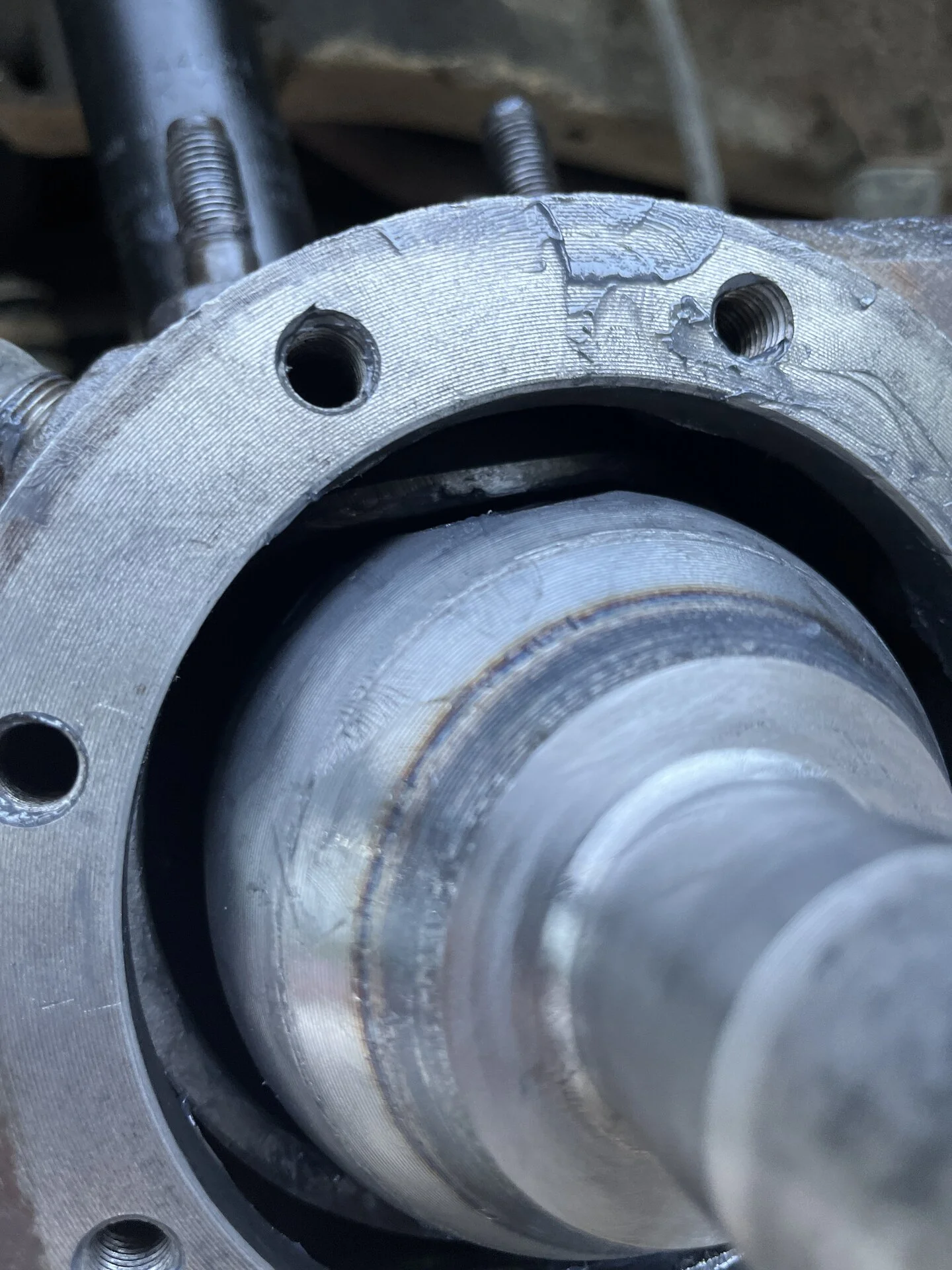

The inner axle is going to sag a bit so you have to manipulate it a bit to get it level with the side gear in the diff. AND rotate to get splines to line up. AND....have the flats aligned to clear the flat spots on the knuckle ball.

So in the video he says it maybe helpful to rotate the driveshaft. Do I need to rotate the driveshaft in the perfect way such that the splines in the diff are perfectly alligned to accept the splines in the axle while the flat spots are perfectly up and down? I think the issue maybe that I have the splines aligned (b/c it goes in 90% of the way) but the flat spots are off by a few degrees such that they are not perfectly up and down. I'll try banging on it with rubber mallet while rotrating. Thank you!

These pictures kind suck, but I get it in this much and it won't rotate at all even with rotating the driveshaft. Had wife rotate driveshaft while I wiggled axle and it just won't budge in. The last one was taken at an angle, the flat spots are more up and down then they look. Maybe slightly off center. But I can't rotate it to get them perfect up and down.
