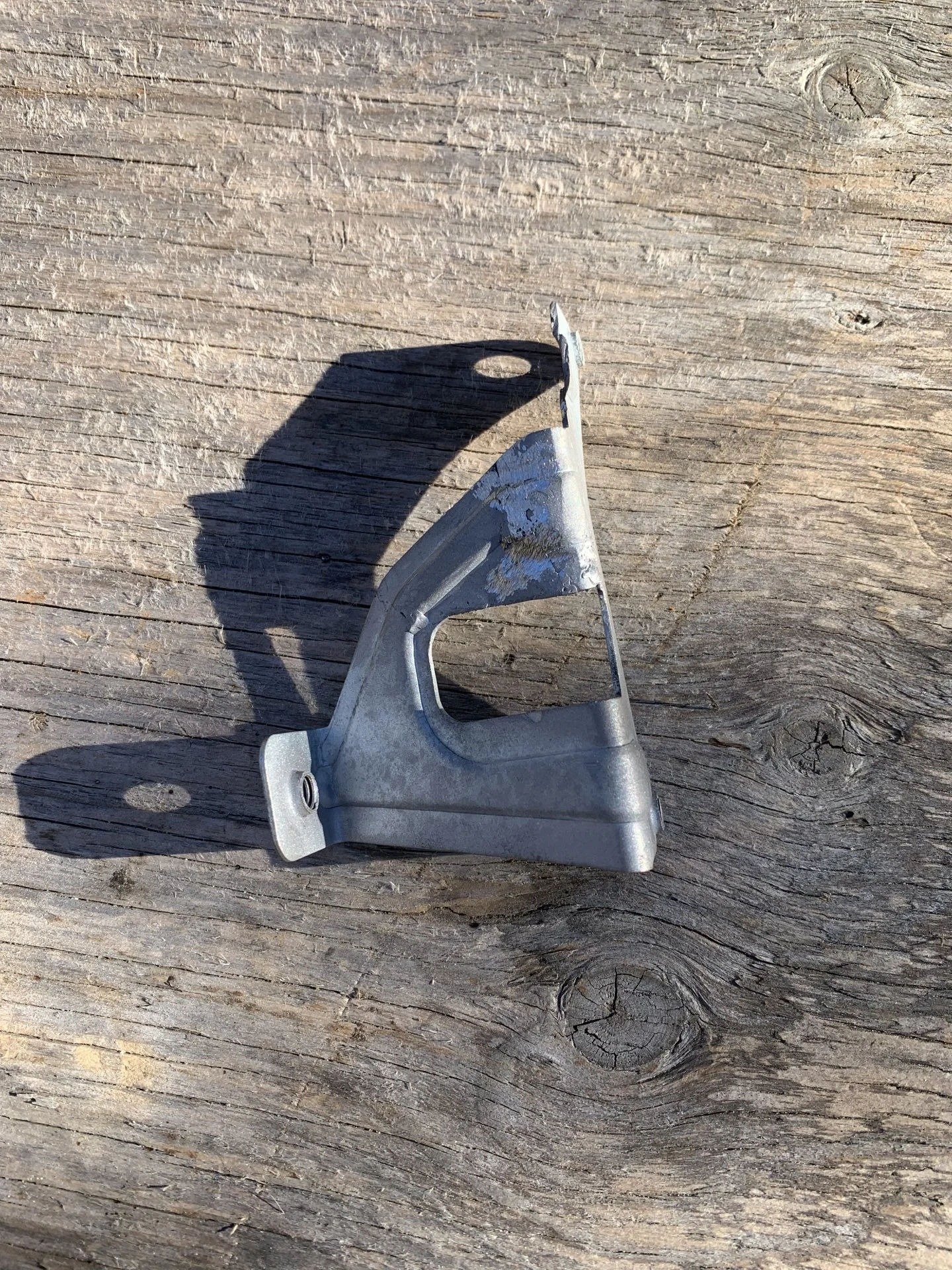

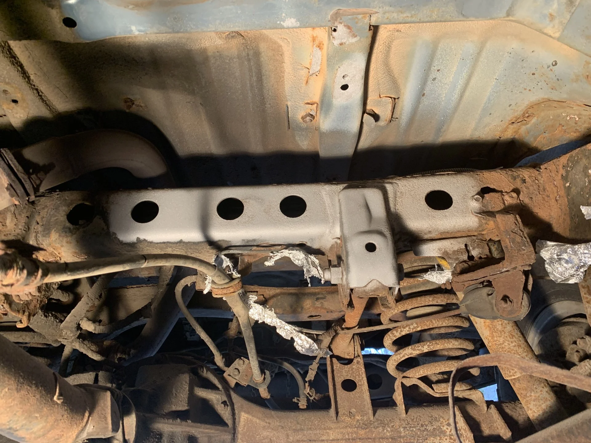

Added another small piece to make it look a little more like factory. I know - I’m crazy. Will media blast and apply a bit of body filler to smooth things out, and then paint.

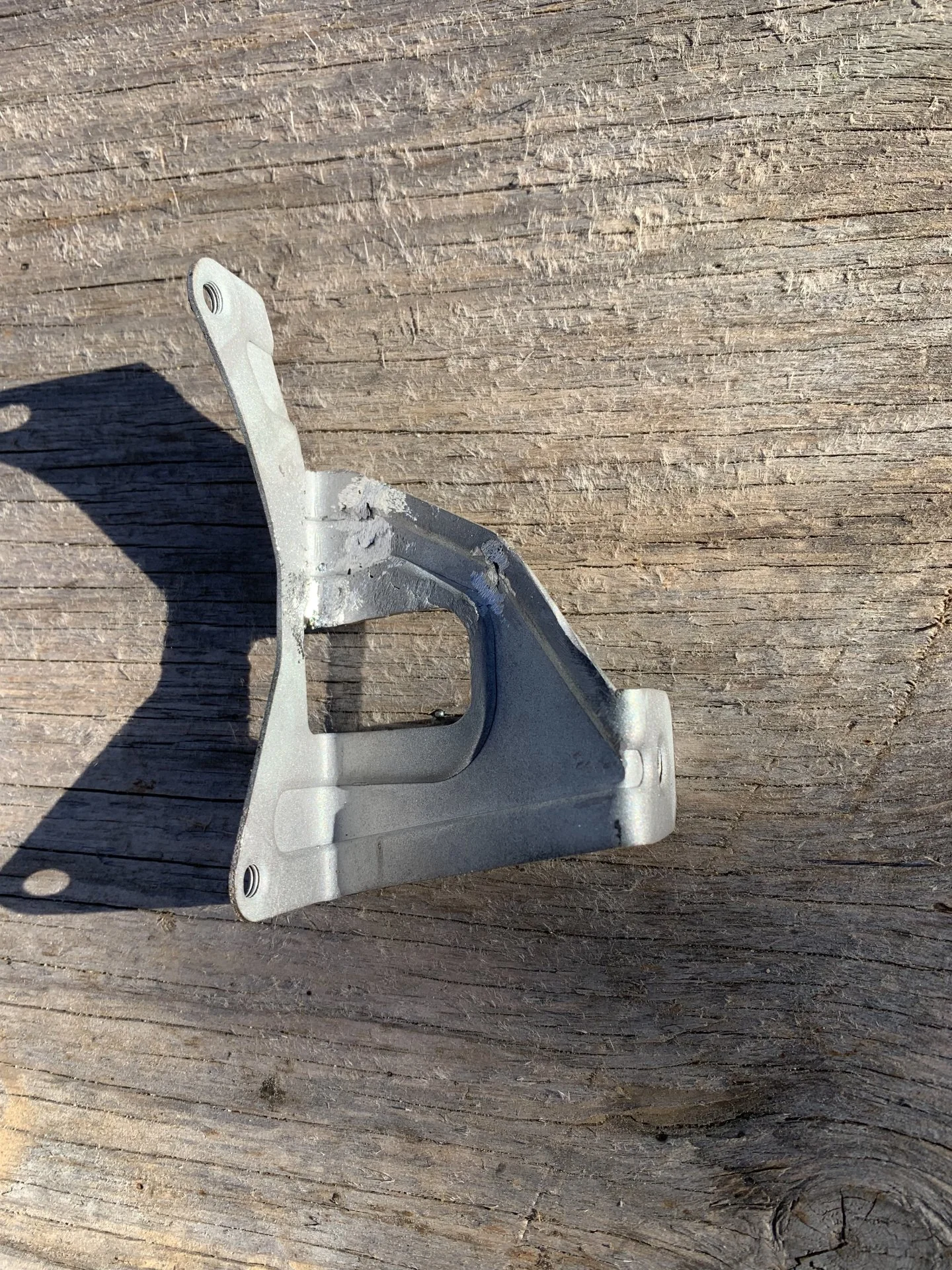

Media blasted. Added some filler.
“Finished” bracket. Looking not too shabby for a hack job that no one will ever see or appreciate. Lol!
If I may offer a suggestion for your patch weld in repairs?
You are making them too tight, you need at least .030-.040 smaller. If they are too tight when you weld the metal will distort and be very difficult to work back down to minimize the amount of filler.
Also it may cause oil canning of the panel to the point that it will constantly flex and the filler will eventually fail its bond to the metal.

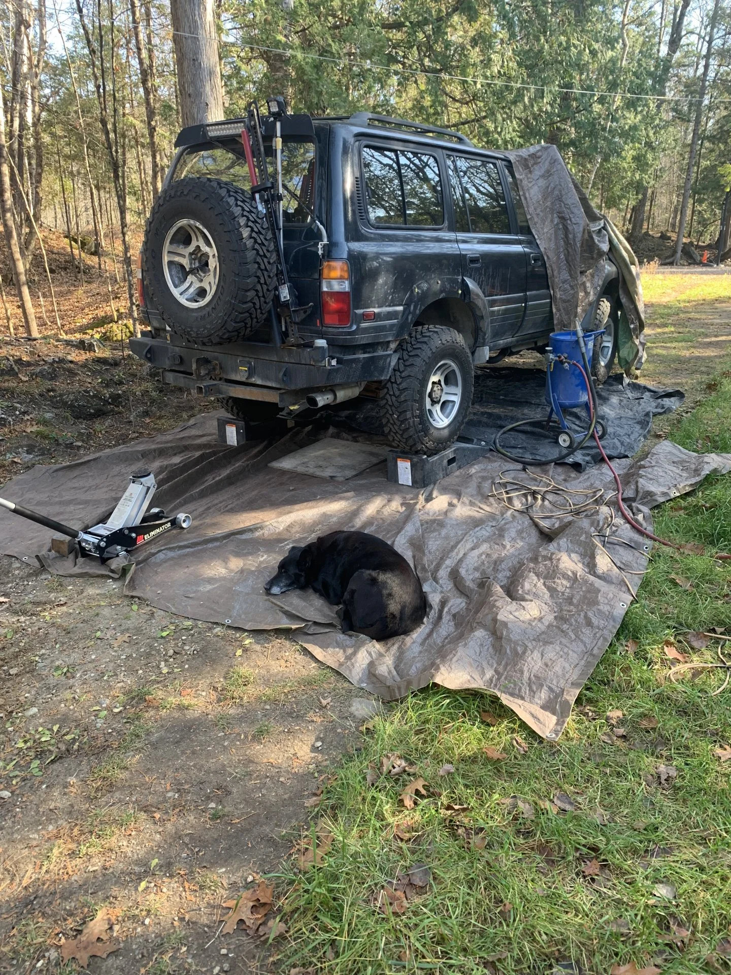

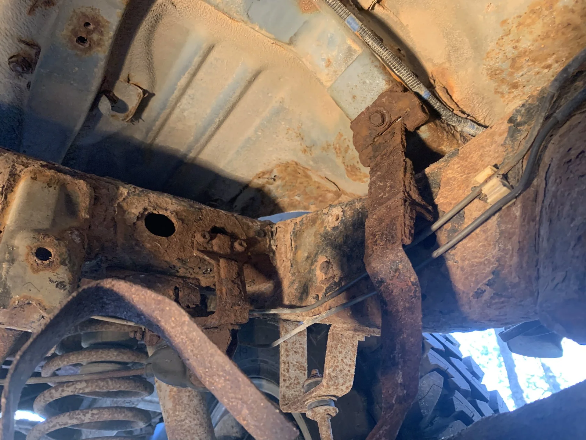

To sum things up so far, after removing the trio of fuel lines and fuel tank, I decided it was best to media blast the rust on the rear of the frame and underbody before reinstalling the fuel lines and LRA tank. I just started to blast this afternoon, and I am having multiple stoppages every few seconds, so I’ll stop and remove the media (glass bead) from the pressure pot and sift it to remove any large debris. Already found a golf ball size hole in the drivers floor board under the main wiring harness. I knew it was wet when working on the wiring for the HAM radio, but never saw a hole. Will continue to work on it tomorrow when my daughter can give me a hand as it is a major PITA to get up from underneath the truck to address the stoppages.

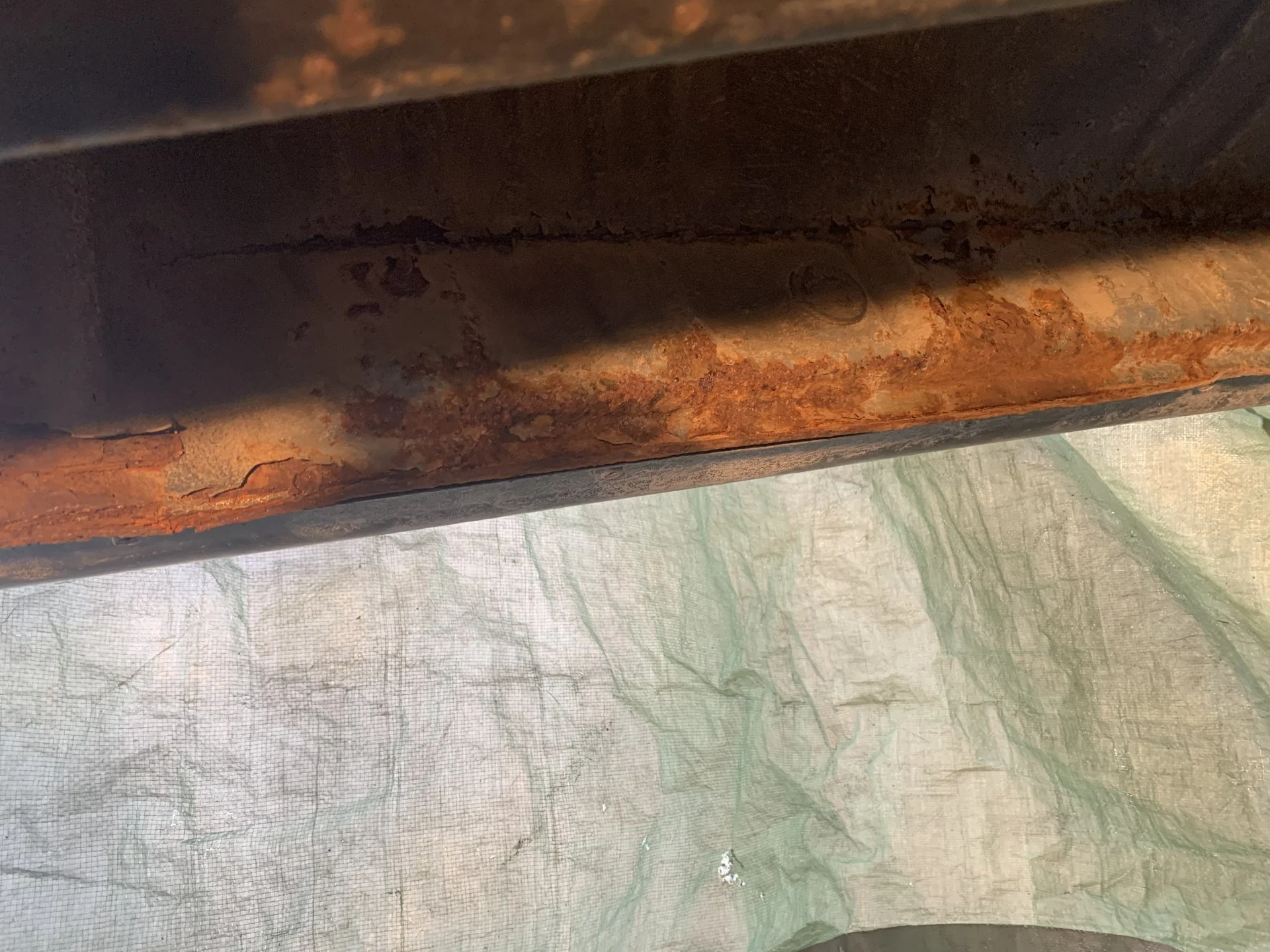

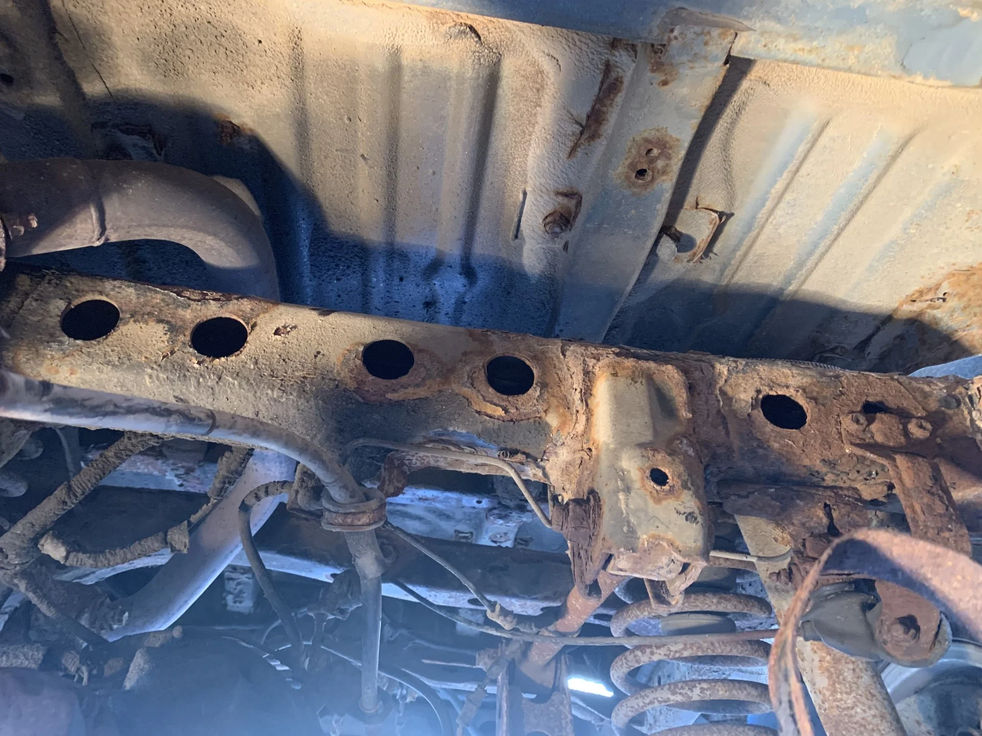

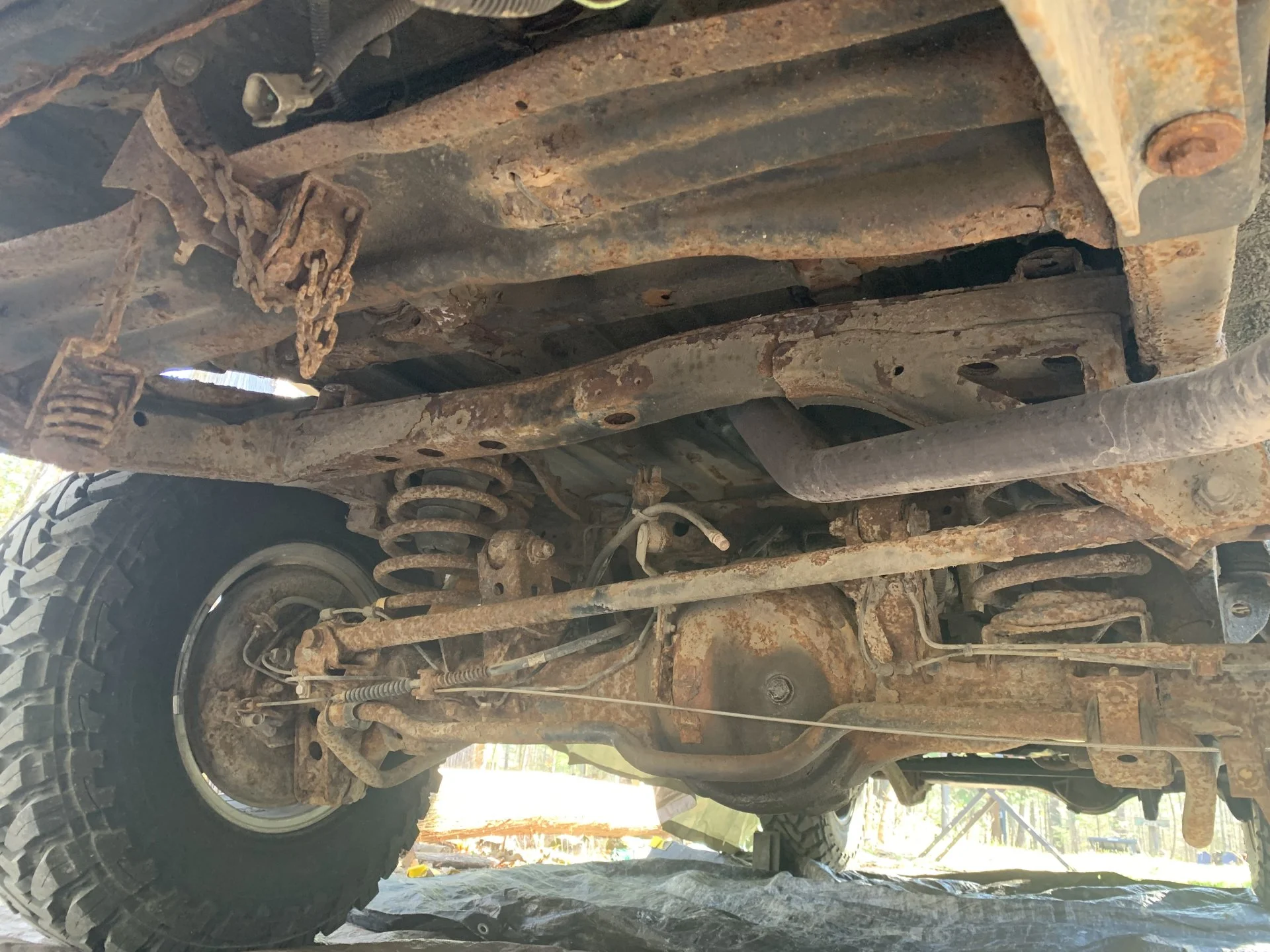

The kind of rust I’m dealing with. Been dreading this moment for the last 5-6 yrs.

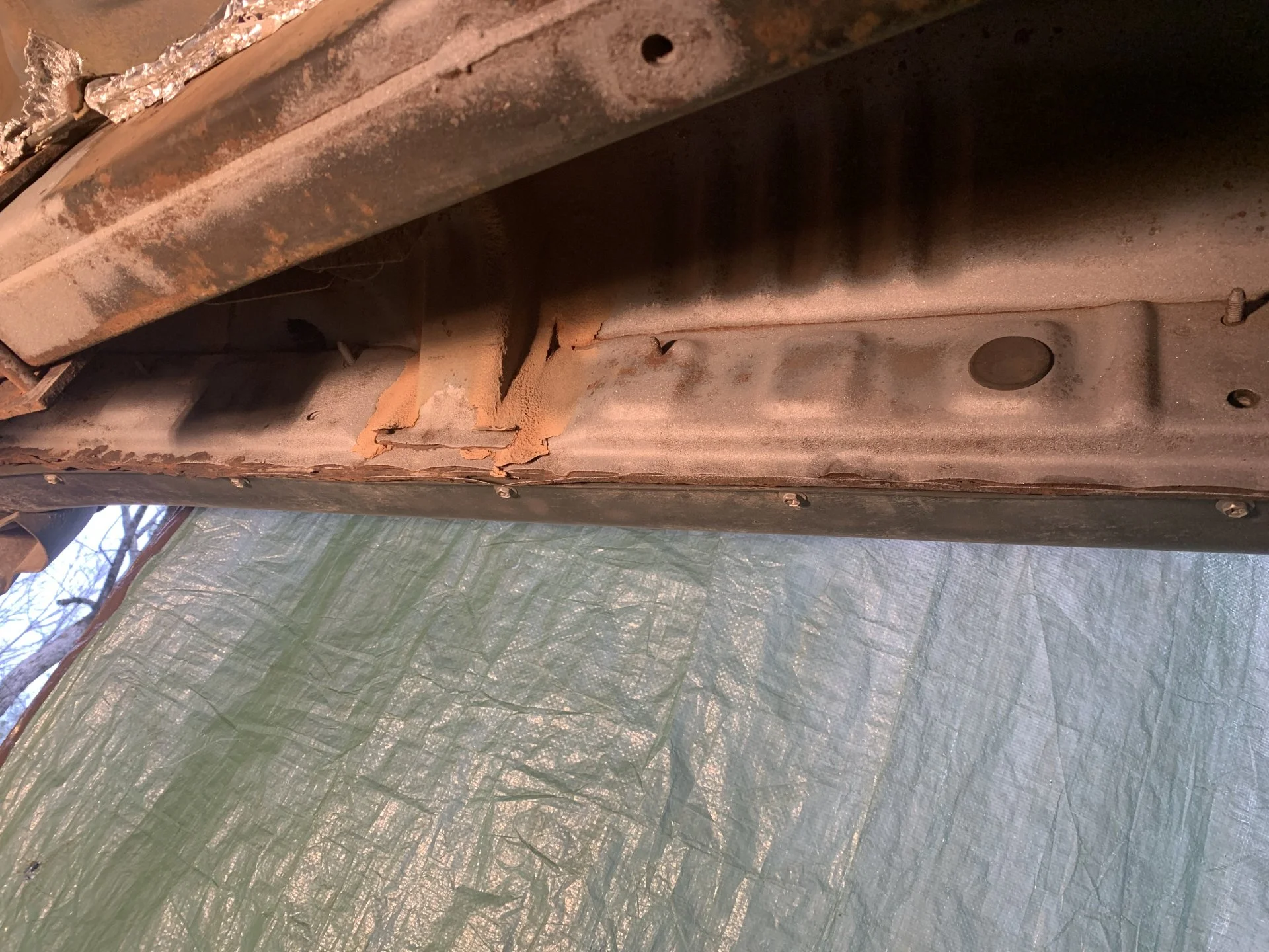

The rearmost is the worst.

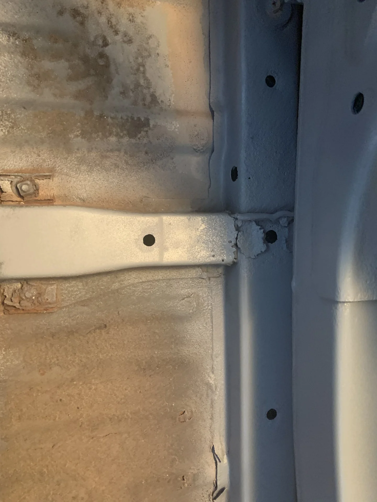

Got this direct to metal coating g that is supposed to mimic the factory e-coat. Will spray whatever becomes bare metal with it followed by a 3M undercoating product.
The 3M rubberized undercoating. I really don’t like these types of products, but I’ll try it out on a test piece. Also got this seam sealer to use around the body mount supports and body support channels.

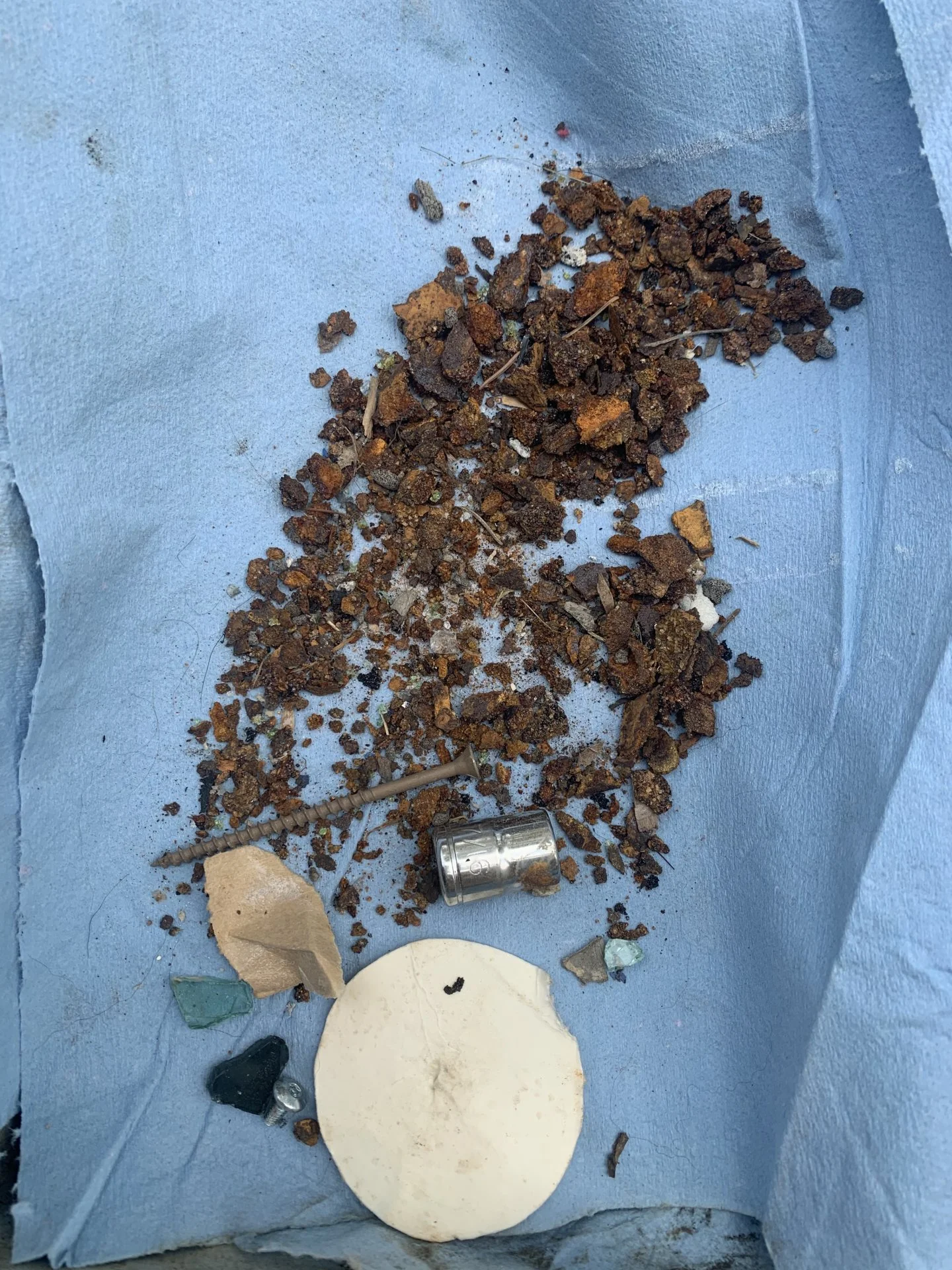

Had to take of some other stuff. Too bad because we’re having super warm weather (21C). Decided to empty the pressure pot and this is was what I found. Crazy! I need to make a proper lid for it to keep stuff from falling in. There was plenty of chunks of rust/debris that I freed up, but the inside of the walls look fine. There were bits of glass, a deck screw, a 7/16” socket, small machine screw, cardboard, and a piece of paper amongst other crap. No wonder it was blocking up every few seconds. Too late in the day to start blasting, so started working on the fender. I’m going to apply a grey primer coat to the inside surface.

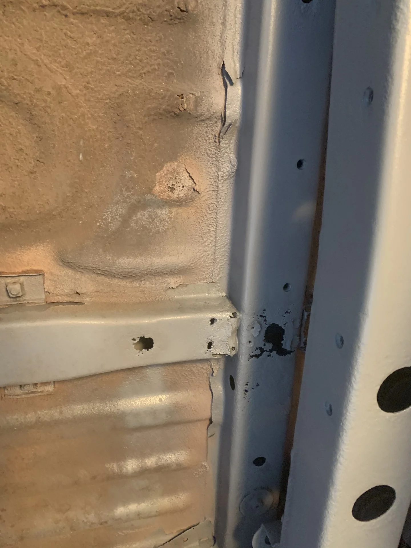

Just got back at it. Still having stoppages, but can go for several minutes. Looking good. Used up about half of what was in the pressure pit. Using 20-30 grit glass bead purchased from Princess Auto at CAN$14.99 for a 50 lb bag. Found some more rust around a grommet towards the rear in the floor. Will have to either close the hole, or cut a patch with a hole in it for the grommet.

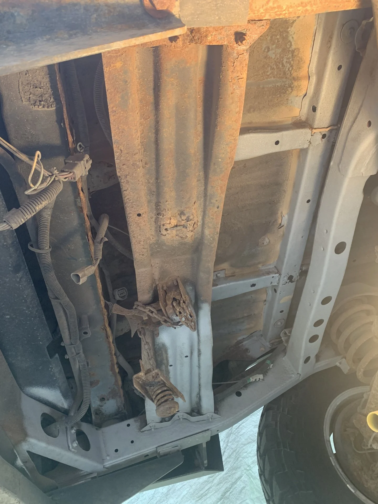

Been slow going for some reason. Had a couple of stoppages, but it is taking way longer to clean up the frame on the other side. Almost gone through the 3 bags of glass bead, and hardly have anything to show for it. Recouped about half so far from the ground. The temps have really dropped from the record setting temps we had the last three days, and it will continue to get cooler until Thursday. it is also super windy which is making a really tough job even more challenging. Taking a break for now to have some lunch, and will try again later. Have a pretty big hole at the PS rear rocker/ wheel well interface. That will be challenging to repair as I believe there are three different metal surfaces coming together in that area. Have the same issue on the DS, but not nearly as bad.

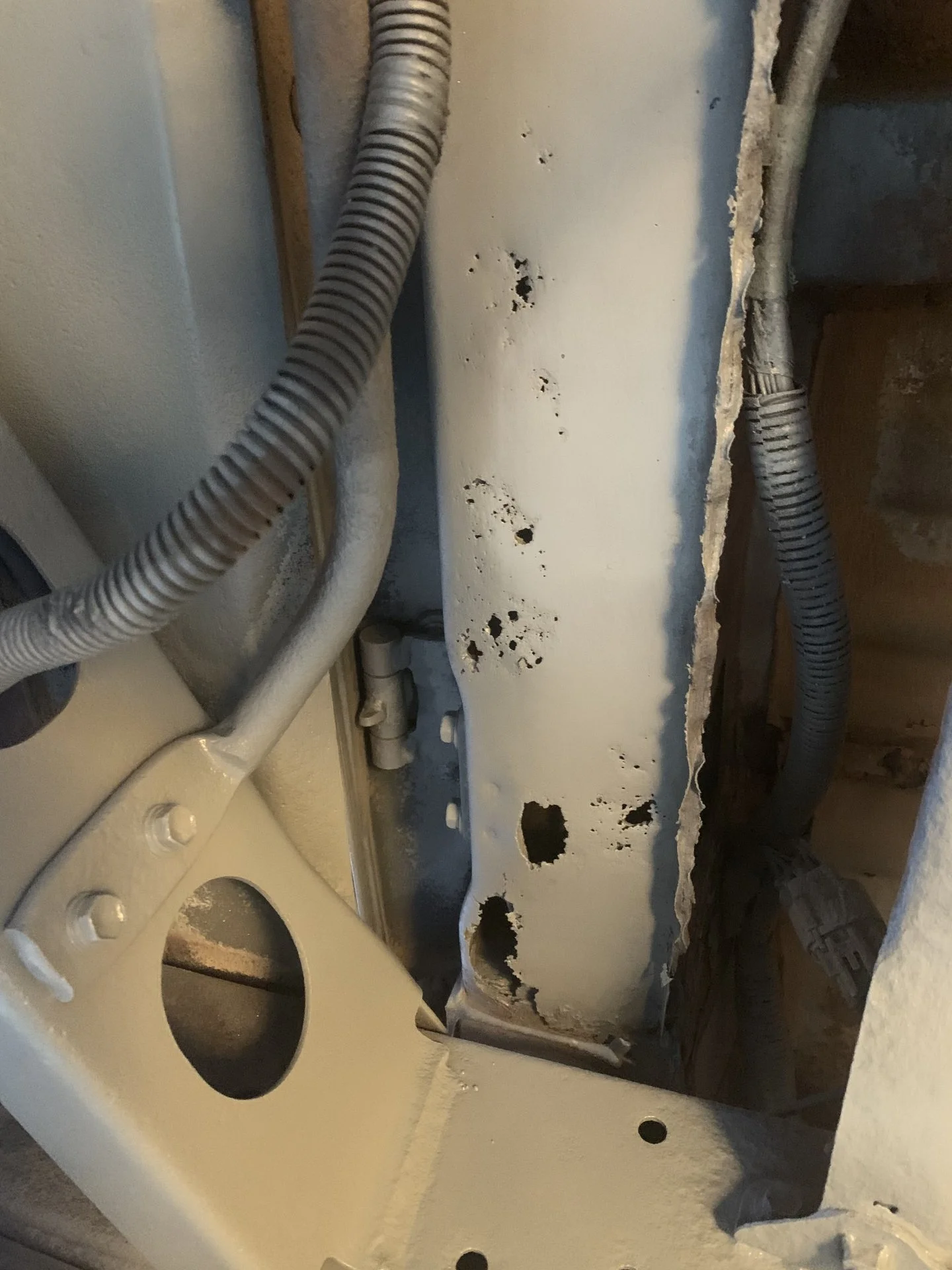

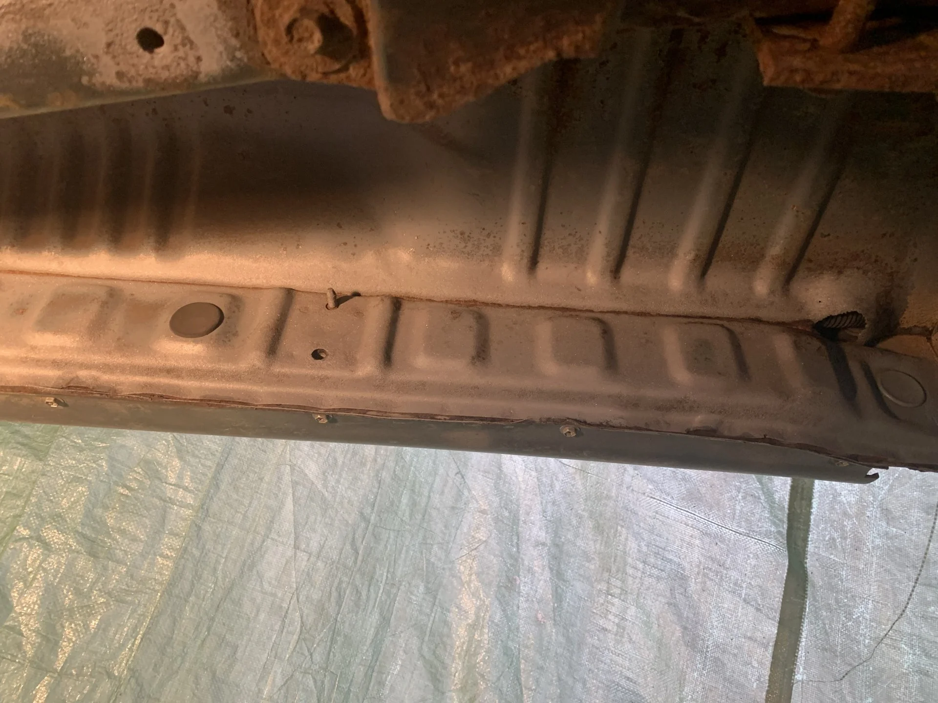

Upped the nozzle diameter to 3/16 from 1/8” and huge improvement in performance in terms of area blasted and stoppages. Going really well. At this rate I should be done blasting what I need/can blast today. Bad news I see rot in some of the floor sub channels. Will be difficult to repair without lifting the body up or off. Damn.
Looks like I’ll have a few sections of floor sub channels that will need to be replaced. Good thing I have a small commercial grade metal bender which will come in handy to make some hat sections. Just managed to sorta finish before the rain started. Started on the diff, but that can wait for another time.
