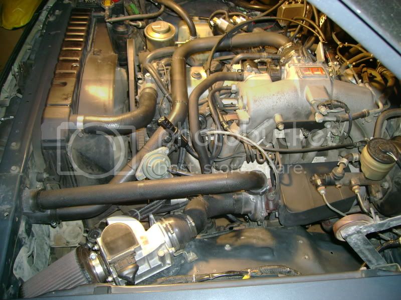

I am wondering how many miles were on the 3FE when you turbo'd it, how hot she gets, and how you think the oiling system is holding up. Looks like you have an external oiler line going to the turbo? Where did you pul that from?
O-k, I am only halfway through the thread, but very interested in reading about this.
130K. I'm running a 160* thermostat but it looks as if it may be too cool during fall/winter. In all honesty, I think the under hood heat buildup is the only difference. I've been toying with a better way to get that area to vent, then I think the 190* would be fine.
The oil feed is teed in at the oil sending unit and the return is gravity fed into the oil pan.

Latest Update (Cooler Intake)
I think this may be the final configuration; although I can never leave well enough alone!:)
