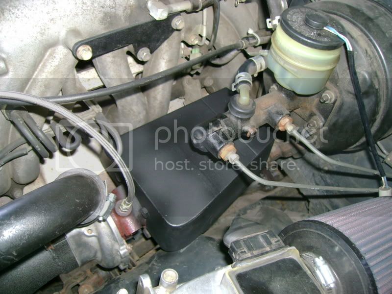

Heat Shield
Turbos tend to add quite a bit of heat under the hood! August in Oklahoma doesn't help matters either. I fabbed this heat shield today from 1/8" mild steel 3" bar stock. Looking forward to reaping the benefits, (hopefully anyway).
