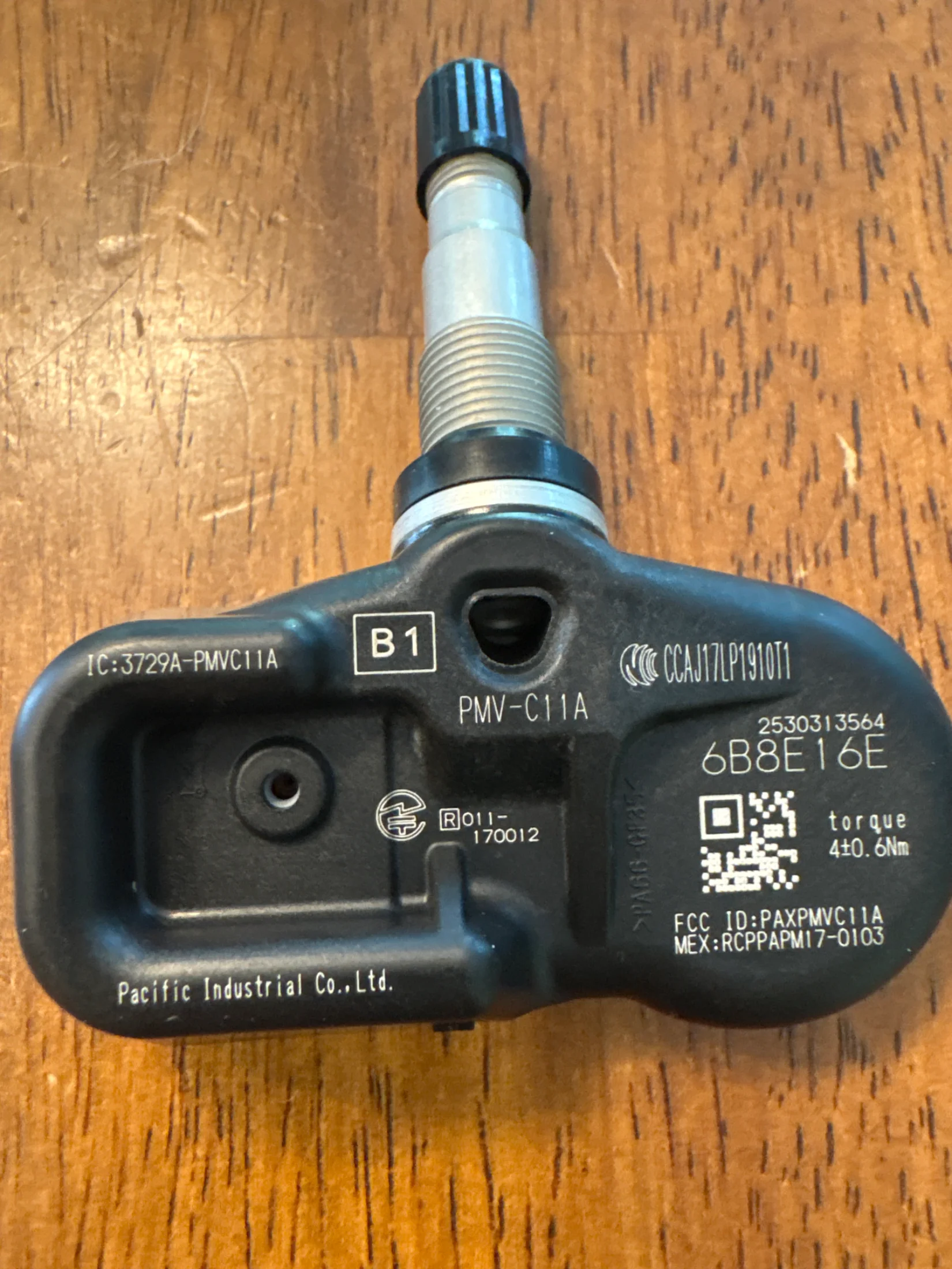

Upon further review, I believe the “extra” sensors are Toyota OEM.
I believe Pacific Industries makes the Toyota TPMS sensors.
I should’ve looked at the package more carefully, but I think there is a good possibility I got two extra sensors at the dealer. I ordered five, they had three and had to order the other two. Neither me or the clerk looked up the wrapped bag too closely and assumed it had the three in it and the parts guy went to the back and got two more.
Is there a chance that they declared two of the ones that were on the truck as 'ok' and only swapped the ones that did not respond to the readers (dead battery, otherwise dead)? I'd look at the hex ID's in techstream and see how different/similar all five numbers are; that may give a clue.
I can’t see how you’d be able to tell without seeing them physically.
Particularly if they cloned the existing ids.
The pic above looks OEM to me, though usually Toyota OEM parts have the Toyota part number on them. I could see tpms sensors being excluded from that practice.
