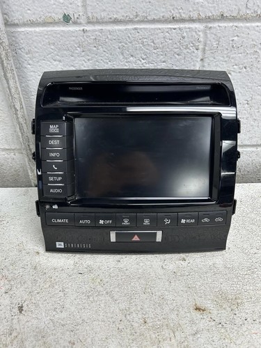

I have one of these 16" Tesla units in my 2015 which I moved from my 2013. Reinstalling a factory unit is simple. The hard part is finding a factory unit if you didn't get it with the truck. Not likely anyone would sell the OEM unit but you never know. The units can be glitchy. Mine works OK but it took me a lot of jacking with it to get it reliable enough. To trouble shoot one installed by someone else would suck. The wiring harness is confusing and half of the wires aren't used and some of the plugs can fit into the wrong sockets. Some have a separate video 360 camera "box" some don't. You also don't know if the PO messed with the firmware. There are "upgrades" available to the firmware but that can also jack up the unit.

Set eBay alerts to find ya an OEM unit.
Theres several on there now, I’ve seen nice clean ones go as low as $400

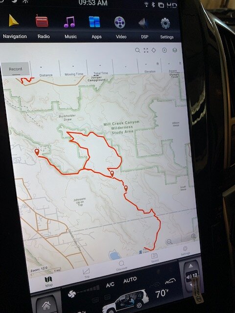

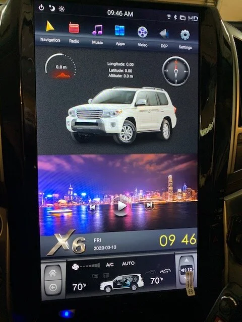

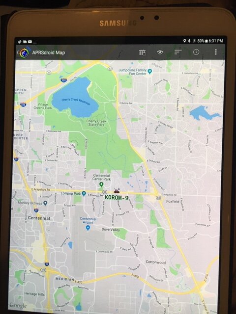

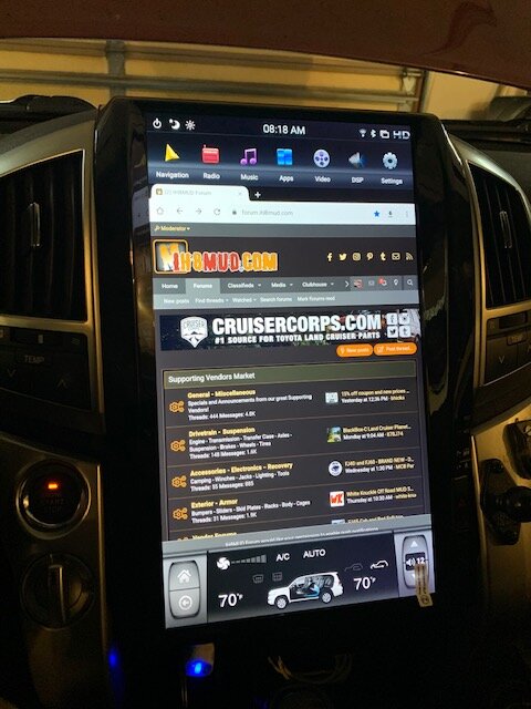

Funny, The tesla head unit was one of the best mods I did. It is easy to plug a factory head unit back in if you have one. I used mine to help troubleshoot an issue that turned out to be the stock amplifier under the drivers seat. I lead a lot of trails at events and having Gaia on a huge screen has been awesome. I have been debating going to a newer model with a new version of Android that has Android Auto
I did have an issue weher it didnt work well and I had loaded too many things in memory leaving very little space for the unit to work in, think like a windows swap file. You might take a look at how full the memory is adelete stuff. My cause was I had loaded too many movies into the memory

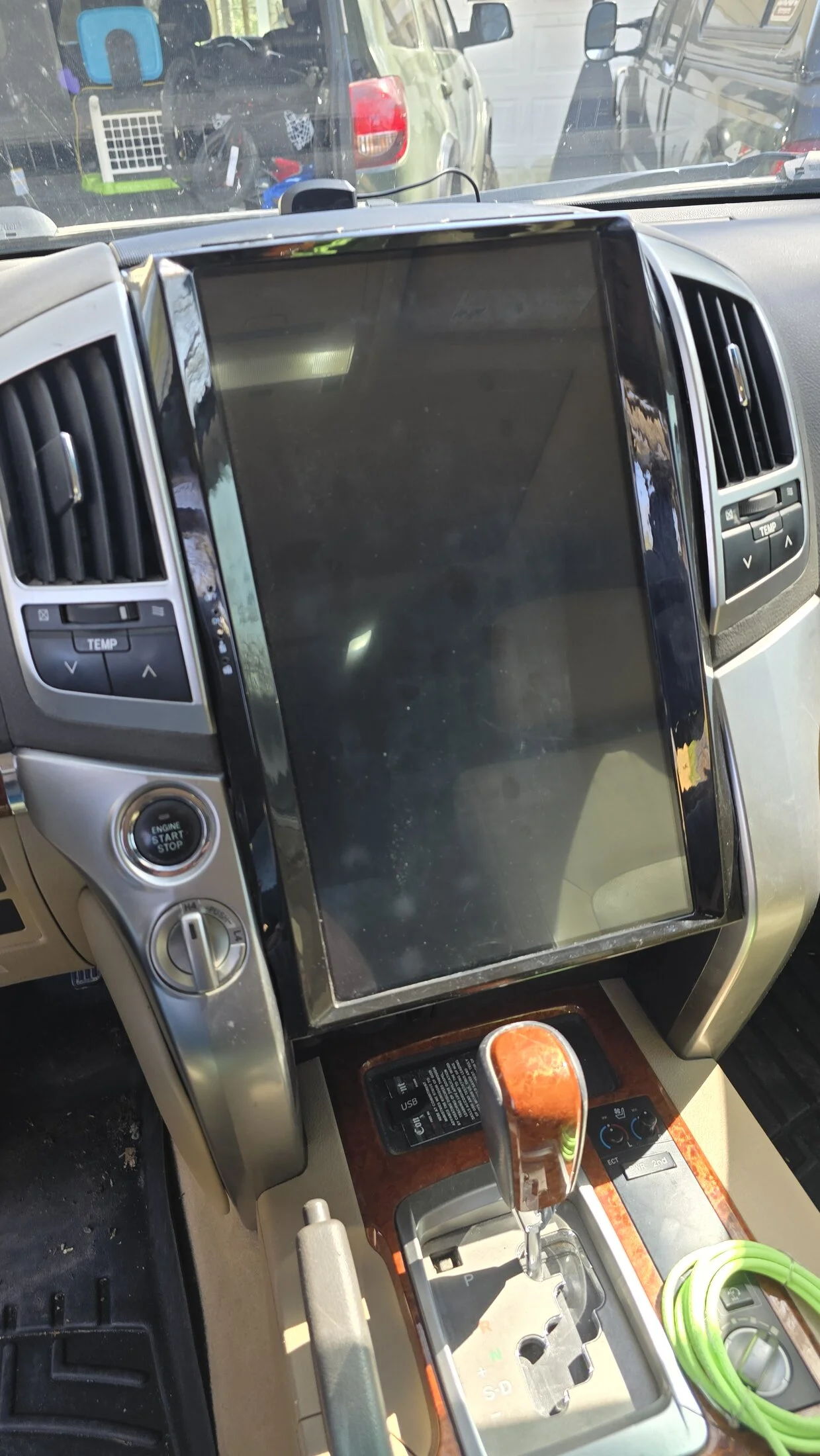

Just a precaution, be very mindful of part numbers, I went back from the terrible tesla screen. What they did on mine was to piggyback the signal from the wires under the driver side seat, changed the OEM amp to another brand and installed some sort of bypass box behind the tesla screen (where all of your original wires plug into and then go into the screen) getting the OEM unit back in is pretty easy, look up videos from the people over at GROM vline and follow the steps to get into your dash. Cheers from Venezuela! (Sorry for any weird sentences, not used to typing a lot in english)
