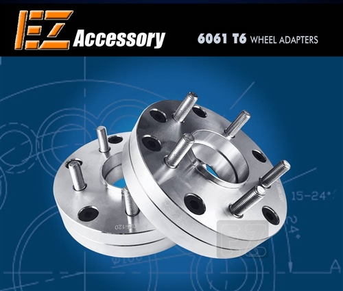

I put 6-lug to 5-lug adapters on my axles and am running the new split rims that came with new tires already mounted and balanced.
I've had no issues with the tires and rims at all.
I did have a "clicking" noise a couple months after mounting. A few of the allen bolts on the adapters were starting to loosen. Use lock tight!
The website I got mine from seems to have disappeared.
I got 4 adapters for $225 after a $25 off sale coupon. The centers were not big enough to slip over the axles, so I took them to a machine shop and had them bored out so they fit right. Cost me $25 extra for them to do the 4.
Here's some I found with a little digging.
I got 5 new take-off wheels and tires for $250. Another $250 for the adapters and $150 for shipping the wheels and tires.
$650 is pretty good for all new stuff. I had holes rusted through my old split rims.
