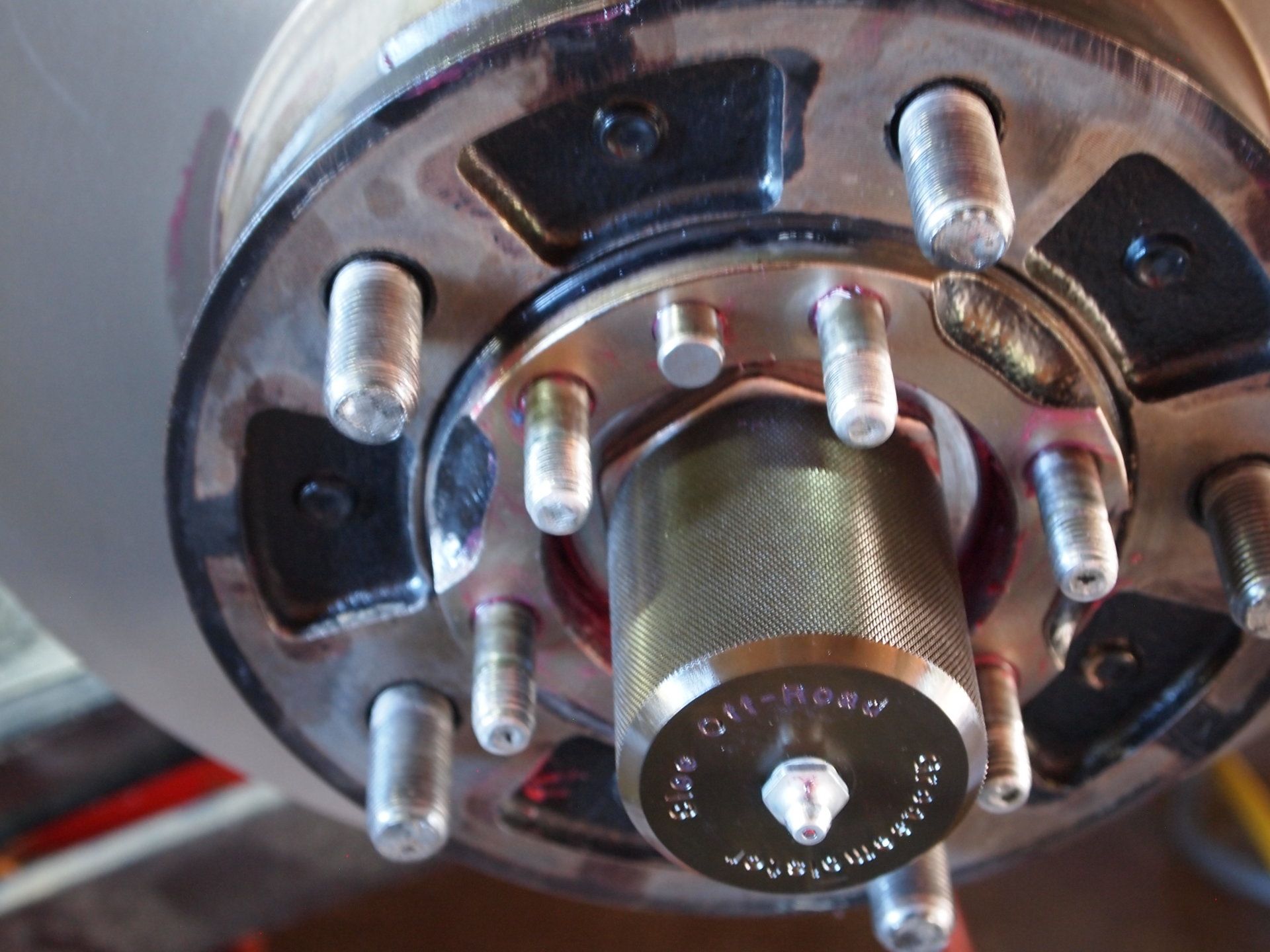

The Slee spindle tool, is a nice method to pump grease through spindle around axle getting grease into back of steering knuckle to axle brass bushing and needle bearing.
Some just press new grease in from back of knuckle while steering knuckle in place. Very difficult to actually get grease into the needle bearings this way. But does fine job of greasing brass bushing, provided no dirty gets in area.
Many on mud have made their own spindle tool for greasing, with plumbing supplies.
Slee tool on and ready to pump grease to axle needle bearing and brass bushing.

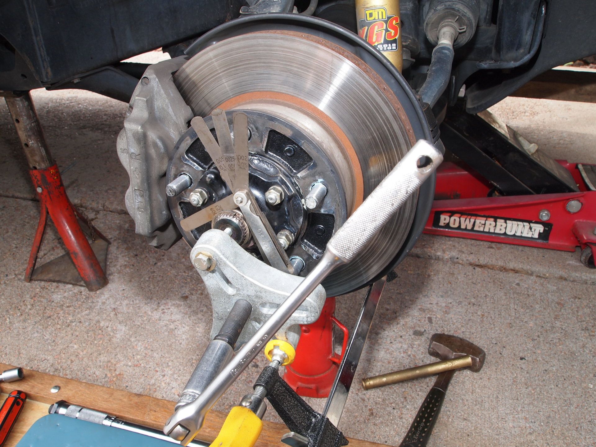

Side Note: Loose wheel bearing can result in chatter (vibration) creating damaging heat. If so loose wheel hub wobbles, the wheel speed sensor may get bad reading. Wheel speed sensors reads the area circled.

After packing axle bearing and bushing with grease. Pull axle out by hand will not settle the grease. So the snap ring gap will be larger than first reading indicates. One can assembly drive to settle and come back and replace snap ring and set gap. I just grabbed up some tools and made a puller. Some in mud have fashion a real simple tool for this.
