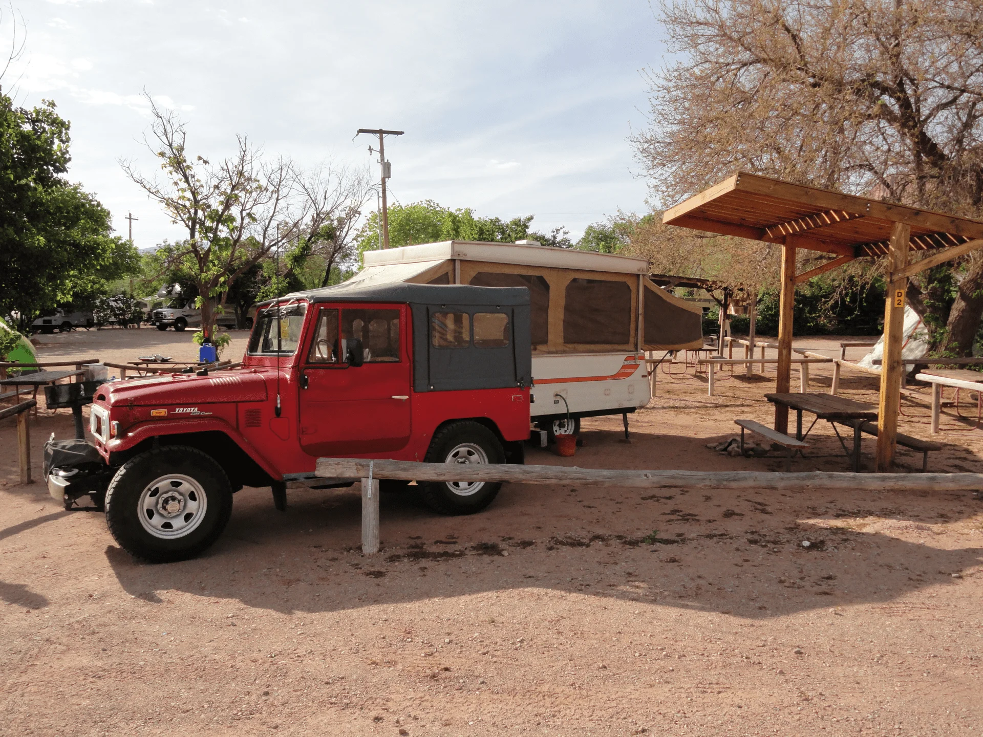

Does anyone have experience in pulling a travel trailer with an FJ-40? My 1975 FJ-40 LVKCJA has a 2 1/2" lift, 4-speed, 4:11 diffs, 31" tires, standard non-power steering, drum brakes, and a 200hp+ fuel injected 2F. The engine, transmission, diffs, and running gear have all been rebuilt within the last 35,000 miles. The trailer is a 3500 lb rated, 17' Casita with electric brakes, sway bar, and a tongue weight of about 350 lbs. The trailer is usually loaded to about 2700 lbs. When hitched to the FJ-40, with a ball extension to allow for a 90 degree turn, the trailer's single axle will be about 13' from the back of the FJ-40.
My concerns:
My concerns:
- is the FJ-40 wheel base too short to safely pull a trailer under any conditions other that flat, forward, straight, and slow
- will a cross wind make the FJ-40 uncontrollable or just very uncomfortable
- will the trailer weight in a moderate highway down hill turn to right or left with a hard application of brakes, cause the FJ-40 to roll or twist out of control
- will the trailer load transferred to the "off-set" receiver plate, bolted to the "C" channel, create too much torque on the "C" channel and cause it to warp or crack
