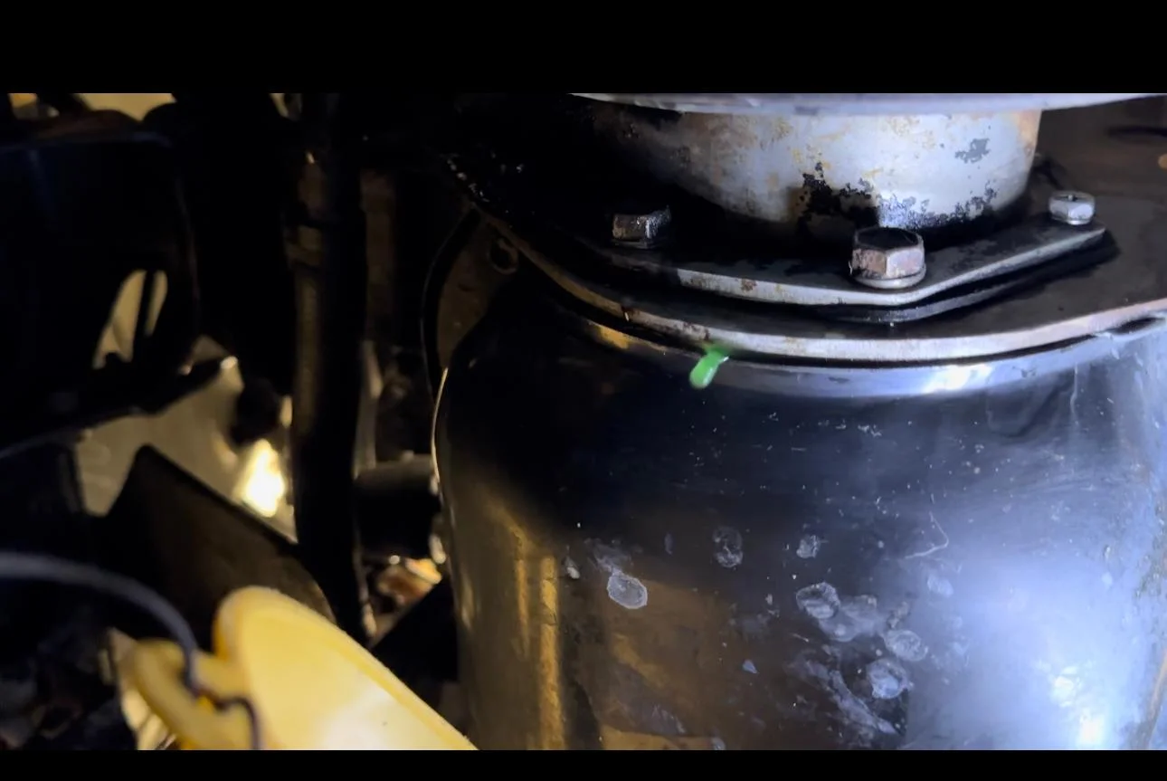

love your humor Dont ask me I know what Im taking of!!! But even picture shows from above DRY Ilooked all day perhaps i walk away for couple days.

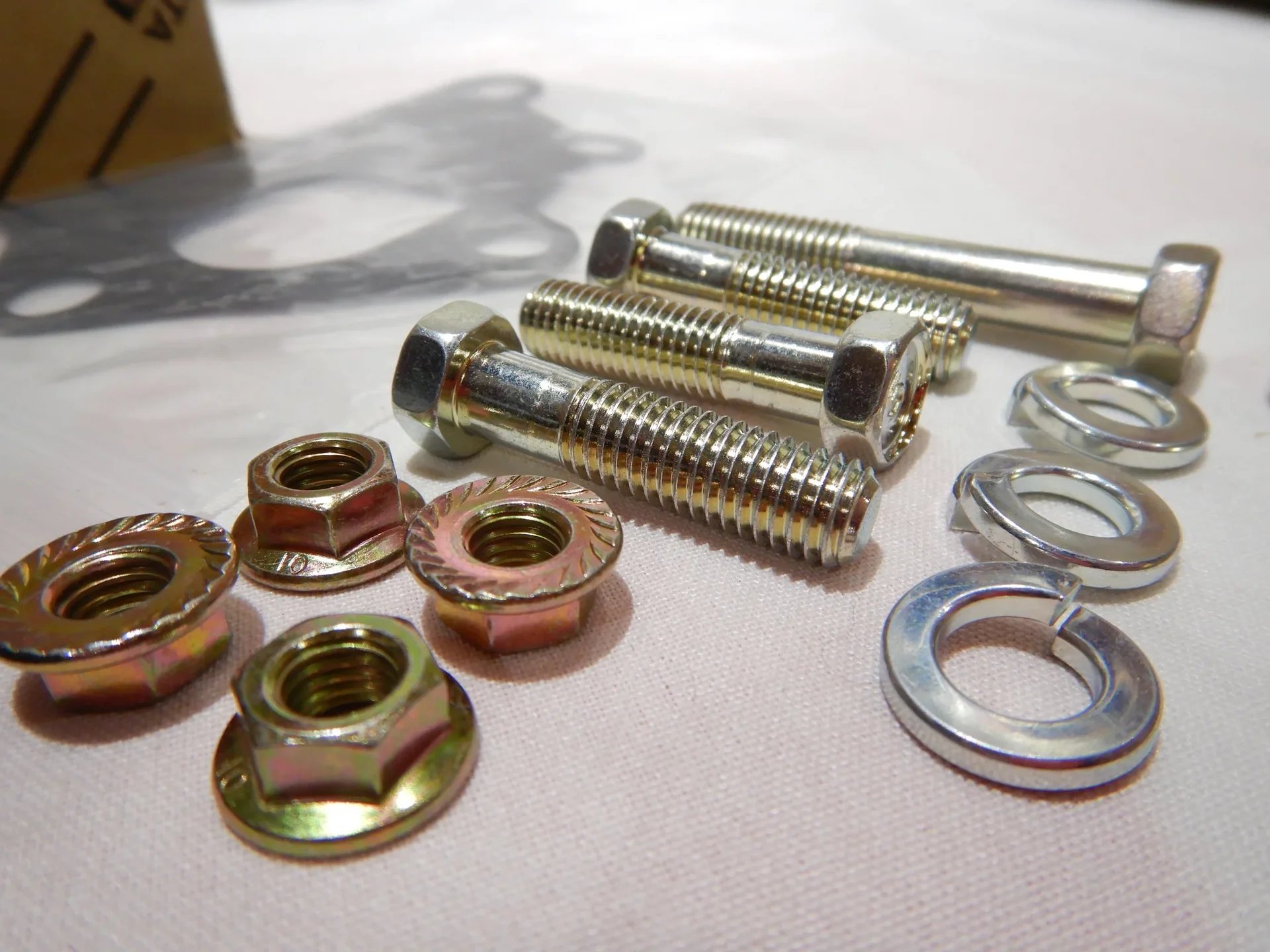

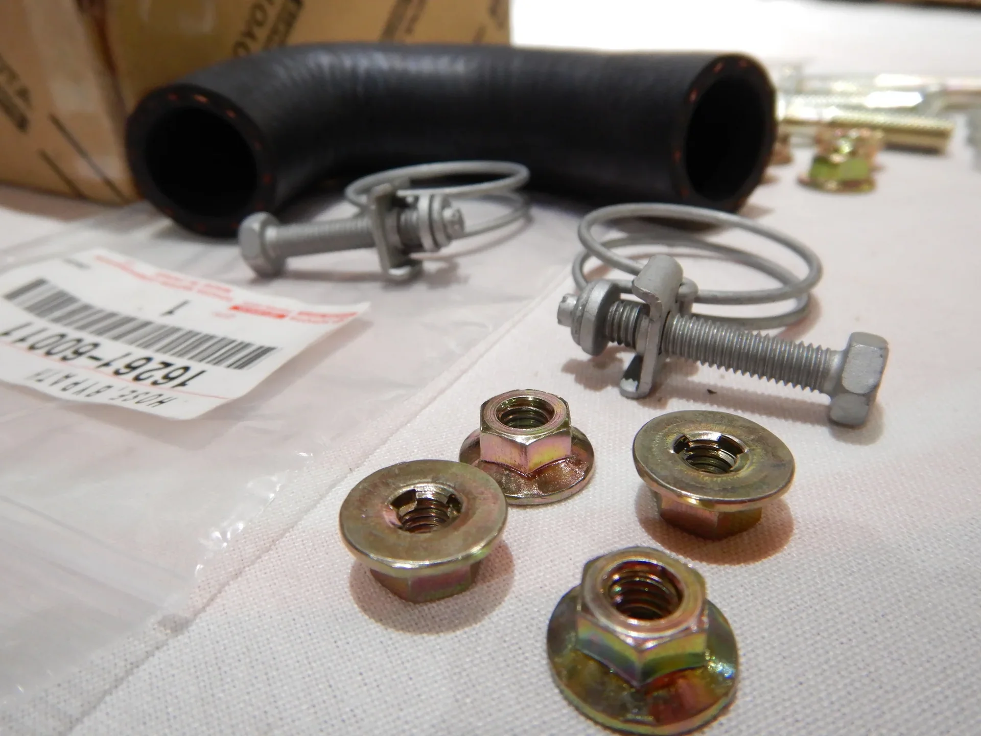

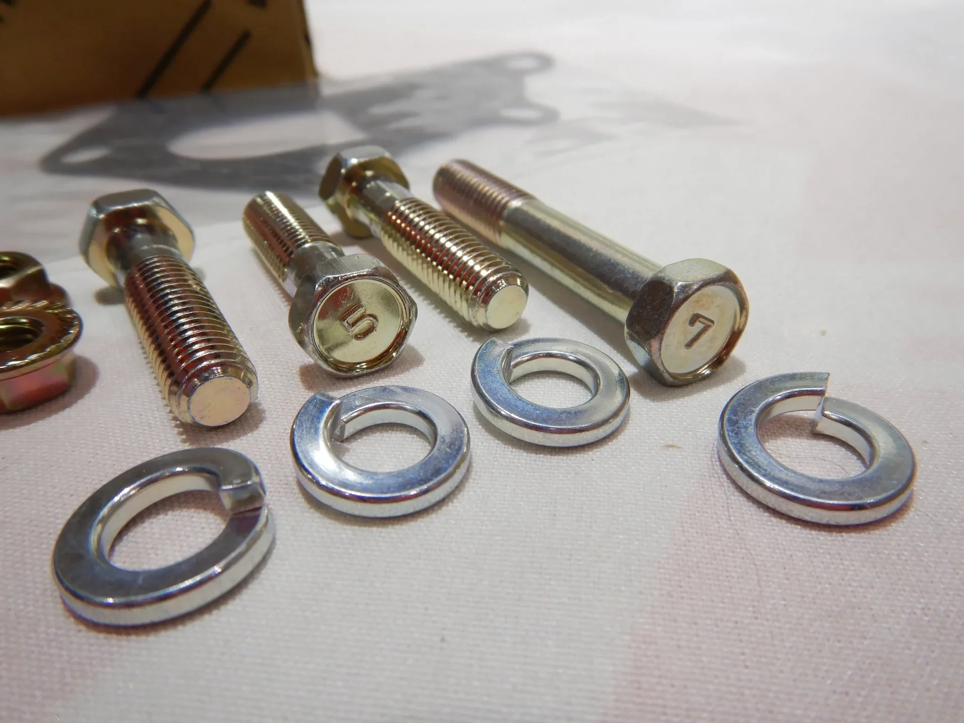

- did you replace the bypass hose and BOTH clamps , using the OEM double wire style / type ?
- did you use ALL new OEM mounting hardware , bolts and spring washers ?
- did you polish very very , like very well the entire block face mating surface , till NO rust and wiped klean with break klean or quick dry solvent ?
- Did you apply TOYOTA FIPG liquid sealer to BOTH sides of a OEM new gasket between the pump and the block face ?
- if1or more answers to my above questions is NO ? , then this is the place to start , and may require you to repeat the step by steps job scope in a entire fundamental way ? this is how you learn and evolve at repairing your 1983 FJ40LV-KCJA
- study the tech images and links below , they cover ALL the key points above , minus the 00295-00103 toyota FIPG sealer , you can get that at your local TOYOTA dealer
- i highly suspect your bypass hose , simply because you actually reused the old one ? this=LEAKS - CITY ! - the below black face image is very dirty and a 1-way ticket to a leak even with FIPG sealer .....fyi
