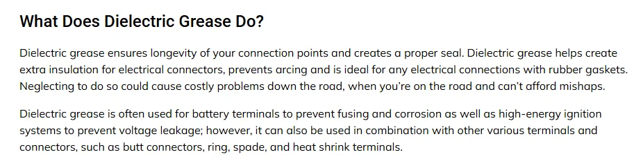

The fuse clips and spade terminals on the back corrode and cause resistance, cleaning those will help temporarily. I am going to use a little dielectric contact grease on mine to help keep them from arcing and corroding.
