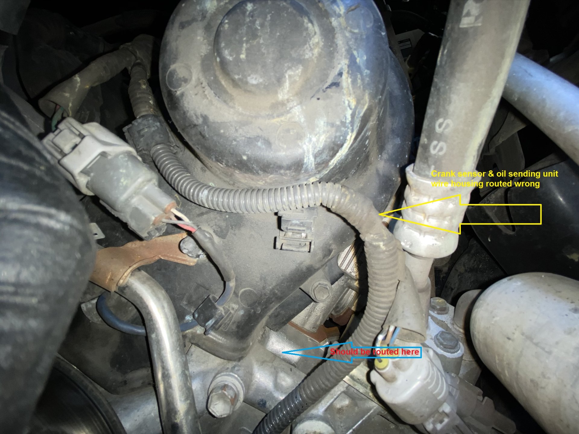

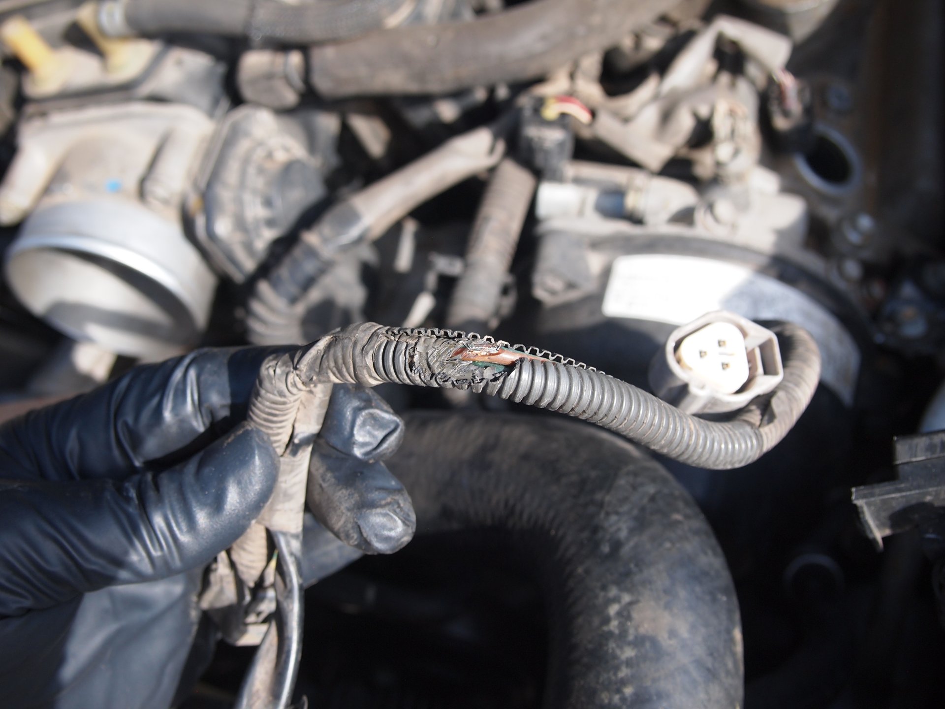

If run okay for 400 miles. I'd look very hard first at; Cam & Crank senors wires. The crank sensor wire is very often miss routed, and rubs on drive belt.
View attachment 3159124View attachment 3159125
If they check out. I'd pull both top t-belt covers, and check timing. If marks off, I'd scope the cylinders.

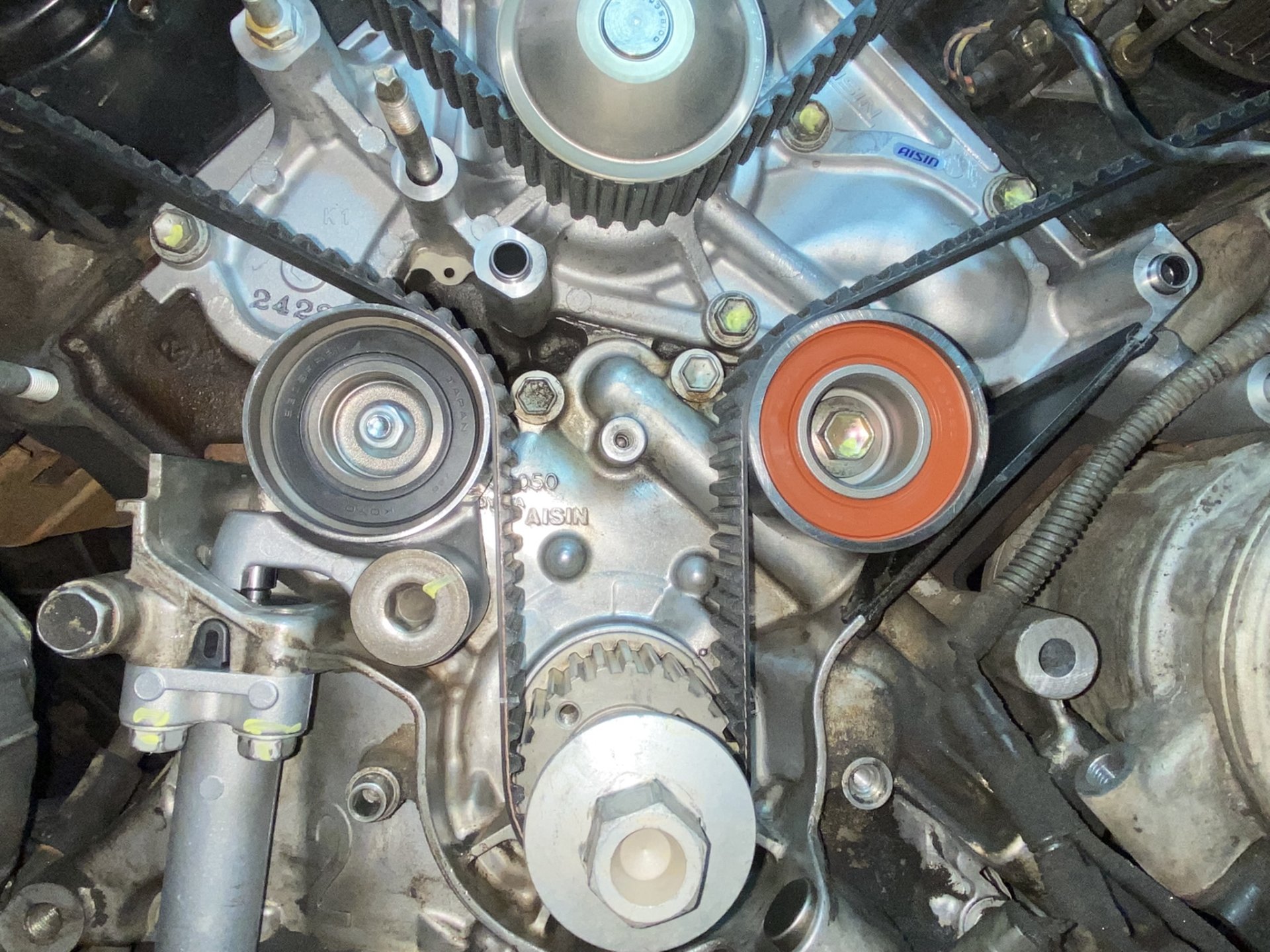

I asked them for pictures i'll share hereYou need to stay actively involved. Ask questions, get answers, be on site, post here if you can. The whole thing still smells a bit fishy.
