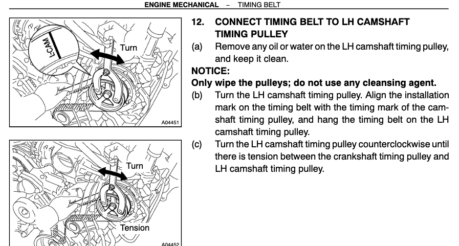

This is a weird question but roughly 400 miles after a timing belt replacement on an lx470 maintained well and up to date just had apparent engine failure. One different mechanic said we can't crank the car and it sounds like valves are hitting or something. Timing tensioner is tight... belt in tact but they couldn't access the timing marks to see if they were off or not.
