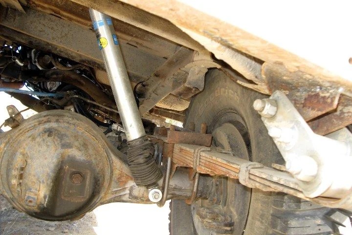

To add fuel to this fire, it's not very hard to narrow an fzj80 ff rear axle. This one matches the stock fj62-width front. The custom short side is dual splined and made by Bobby Long.
attachment.php
attachment.php
