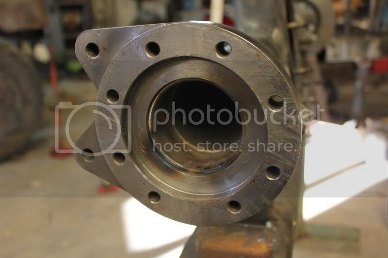

Unless I'm missing something, by running the backing plates/spindles/drums from a drum brake front axle (either early 40/55 or later 45), you could have that if you really wanted :meh:. Backing plate may or may not clear the caliper ears on that kit without some work.
Interesting thought. :hhmm: I'll have to look into that if I happen to end up with a drum brake front axle. ;)

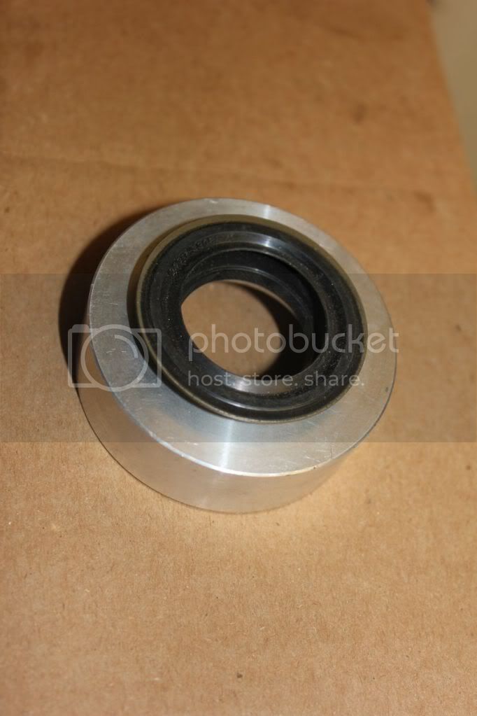

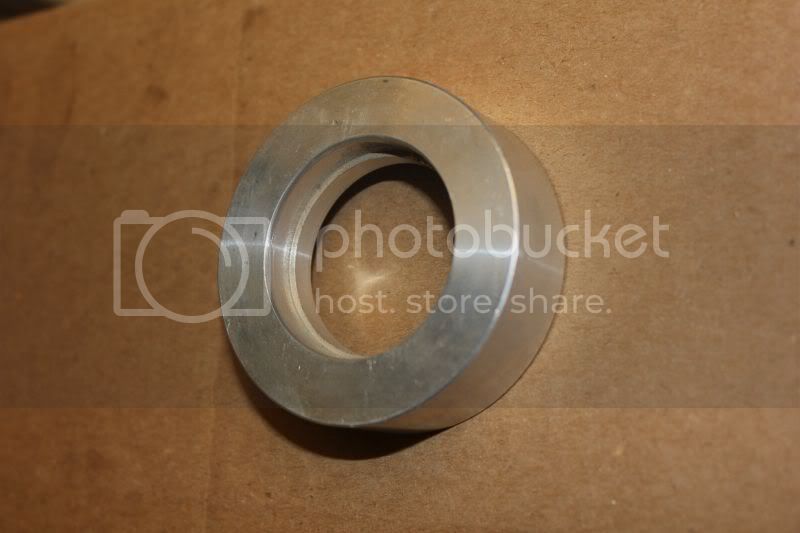

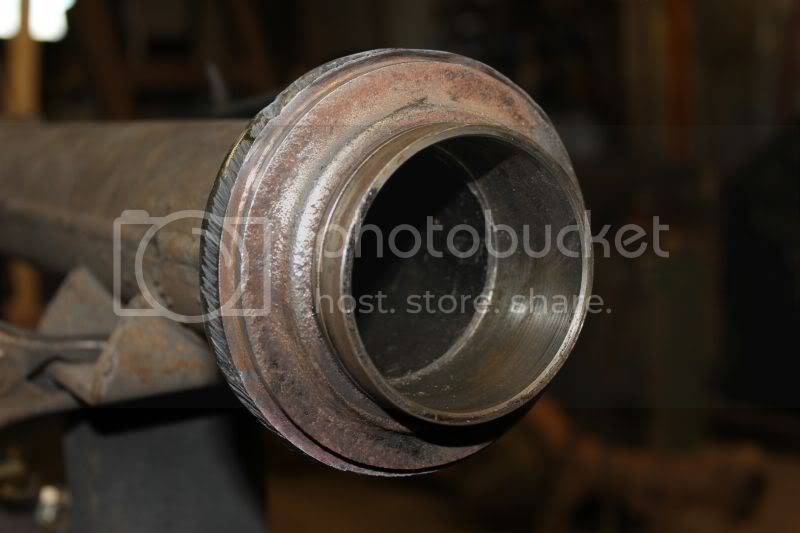

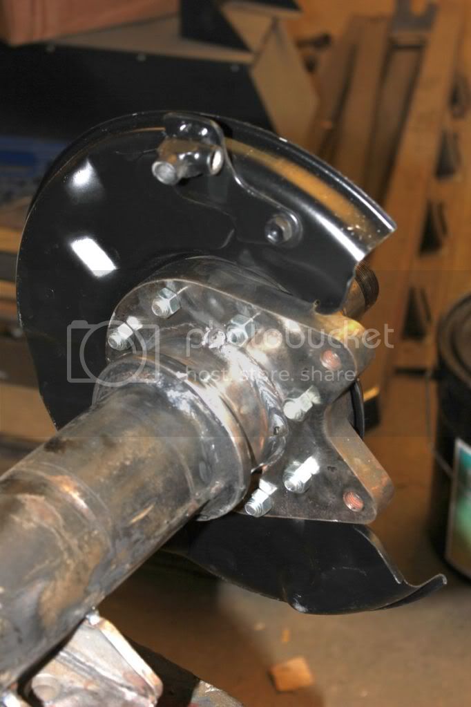

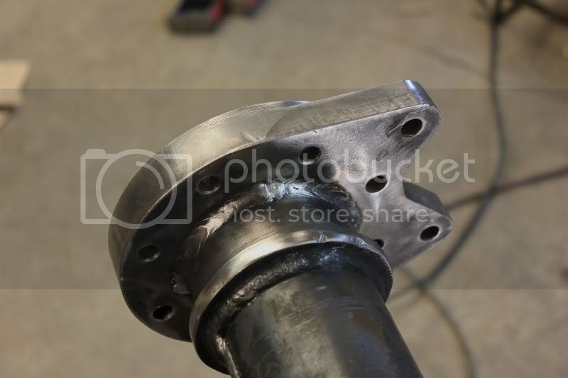

We also make some parts
First remove backing plate mount
slide splindle mount, index caliper ears, on and weld
inslall Marlin's super birfield seal into seal retainer

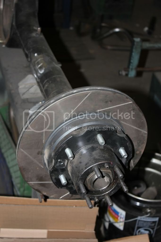

drive seal retainer into rear bearing cup
assemble with Toyota front end parts, spindle, hubs, rotors and calipers
As a plus...or minus, depending how you look at it, the track widens almost 5 inches . A little wider than 60 front....59"
