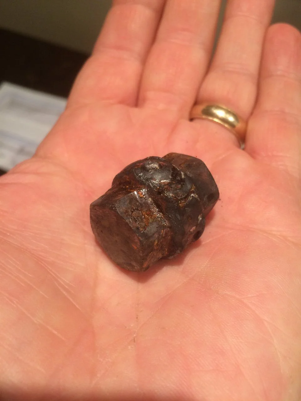

Here's a tool I made for the block drain. It's a 17mm hex - just weld a 17mm (wrench size) nut & bolt together from your old Toyota nut & bolt stash. I still had to heat the drain plug pretty good and use a breaker bar to get it loose.
It's a good sized hole, so be ready to get a faceful of coolant.

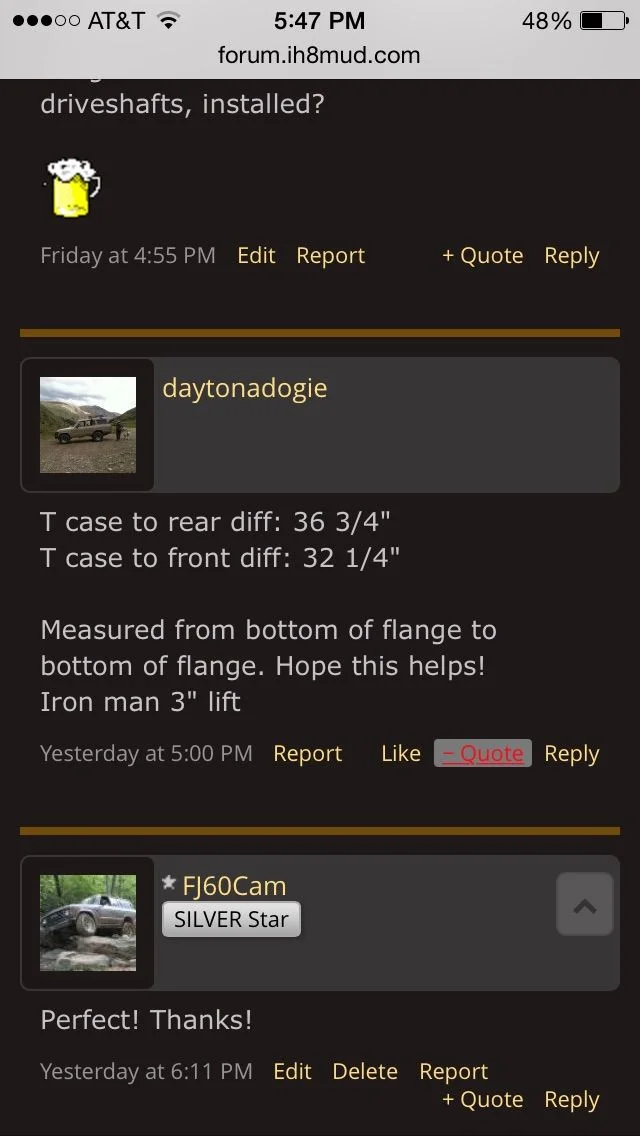

good deal. whats the difference between the driveshafts on a fj62 and 60?
Here's the measurements I received for an FJ62 w/ a 3" lift.
However, I'd like to retract my earlier statement. They might work, but I'm measuring 37.5" for my rear.
The front, I'm going to have skinny tube lengthened (to clear the trans pan), so a stock wouldn't work.
The rear is cheap to modify, so probably not worth trying to find one from a 62.

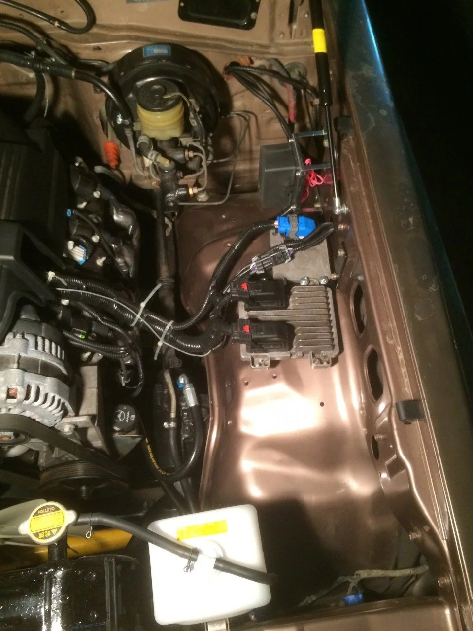

I got the passenger fender wires cleaned up. Everything is now run inside the fender. It still needs to be cleaned up and made permanent, and I still need to route the AC hoses through there.
Most of the leftover real estate will be used up by the windshield washer bottle and my ARB compressor.
Drivers side is pretty much done too. I just need a grommet for the hole in the firewall. The old hole for the clutch master was perfect for passing through the pedal wires, OBD port, and the other needed wires.
