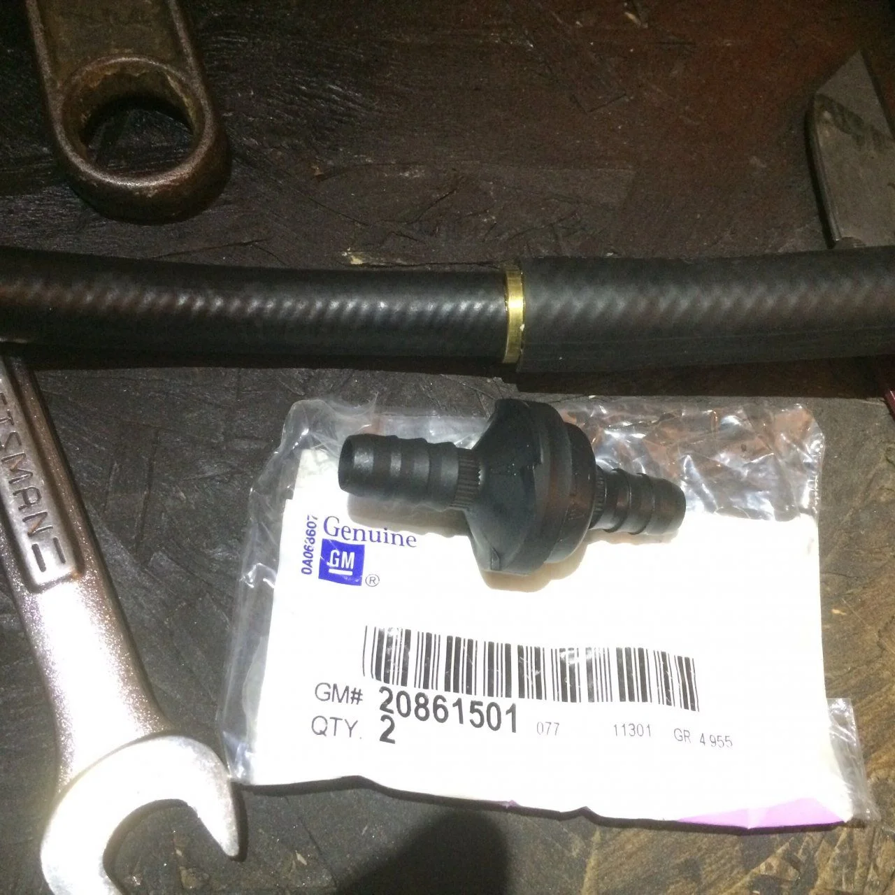

I saw this on some other threads, so you don't lose your brakes if you stall (hopefully a non-issue with the auto), you need a check valve on the vacuum line from the intake to the brake booster. Here that is, shown with the reducer needed to connect the two lines...
I may have spread some bad info. It seems there's already a check valve in the Toyota brake booster....in the 60 series, at least.

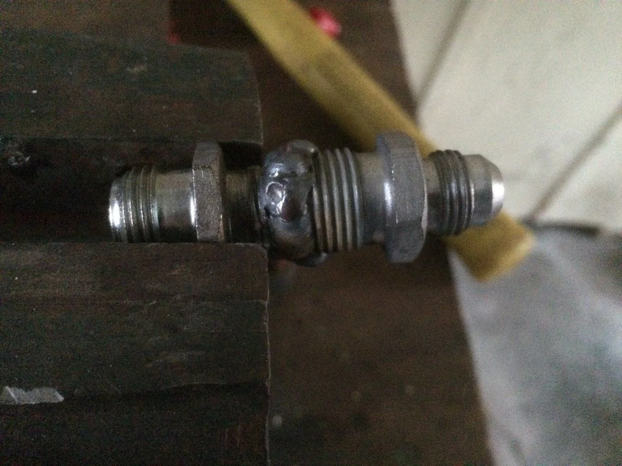

Then things took a turn for the worse when I went to put in my new PS hose. I stripped the AN fitting in the gear box end. I have a new one ordered from PSC, but for the (hopeful) startup tomorrow, I welded the unused low pressure fitting to the stripped one to give me the two needed ends. I'm lucky I at least had that.

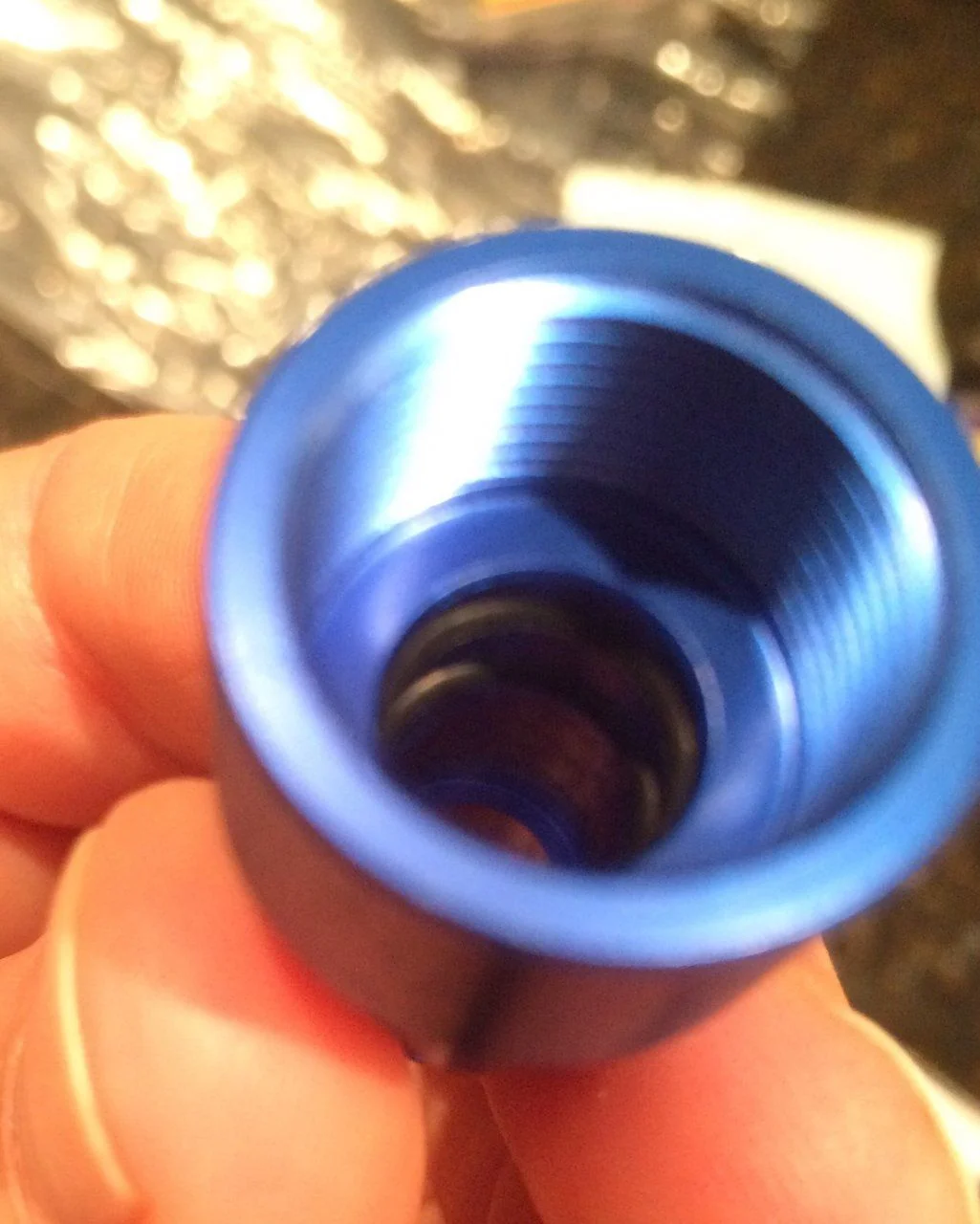

Here's the new filter/pressure regulator & it's fittings...
These fittings have two o-rings that make the seal, and usually a plastic clip that holds them on the hard pipe. The plastic clip made me paranoid, so I opted for the kind that screw together.
