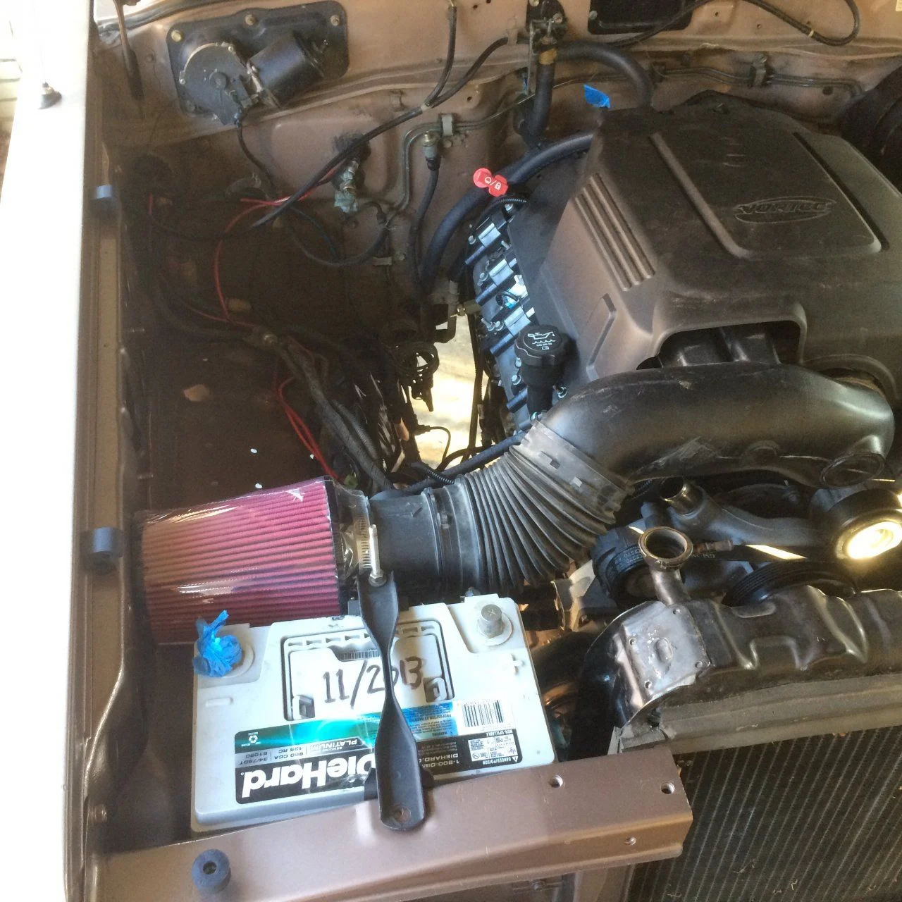

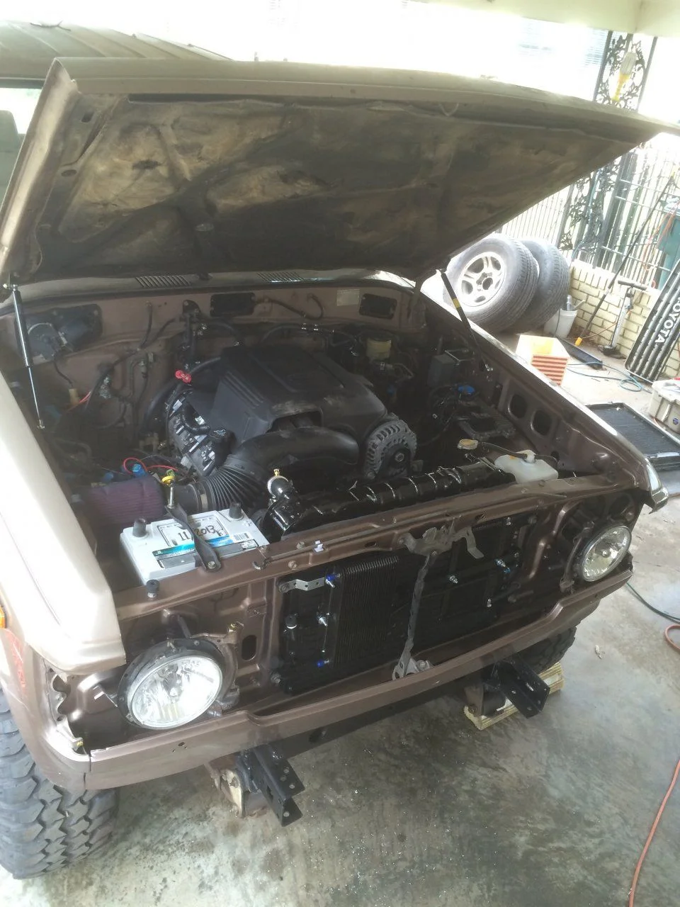

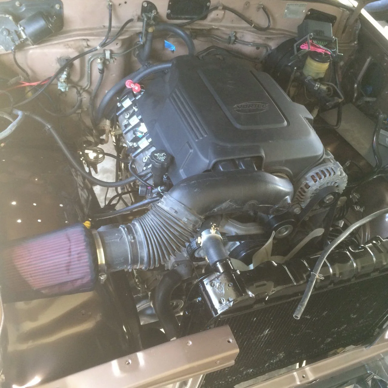

Final intake layout...

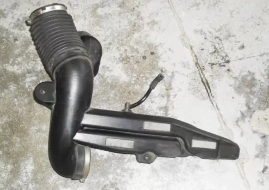

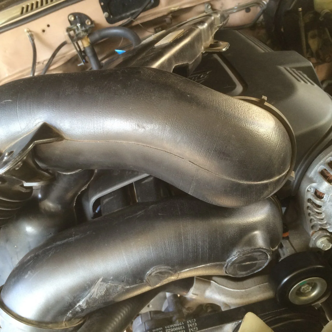

After I modified my intake tube, I stumbled across a pic of a stock tube w/o the front resonator. Maybe from a model with a mechanical fan. I found a cheap one on eBay, to replace mine with something a little cleaner looking.

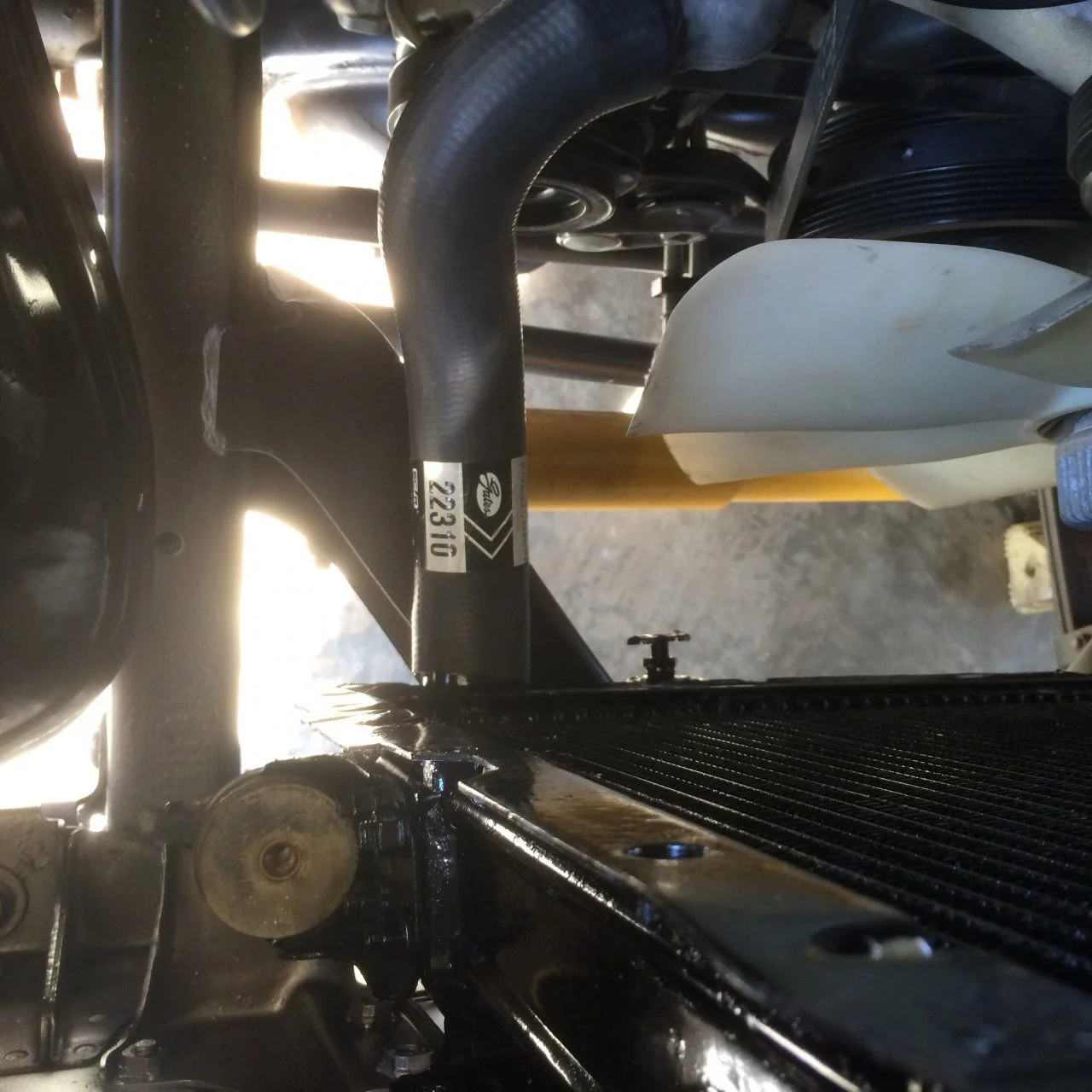

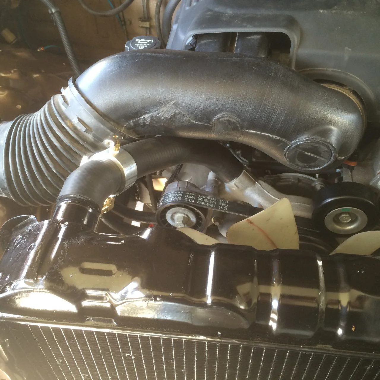

He swapped the lower neck & drain locations (and put in a better, metal, petcock). The works out good because the stock drain location sucks.
I also had him swap the fill neck and upper hose neck, which was changed to 1-1/4".
Grand Total: $85. Quite a bargain to me.
Here's the steam vent fitting. The bleeder is probably pointless at this location.
I got the new intake that came with no front resonator. It must be the intake used on vehicles with a mech fan, since they make contact. I have to do the cut and plug on the back resonator. It will look a lot better.
Clean and nice solution. Glad you did not cut the fan.

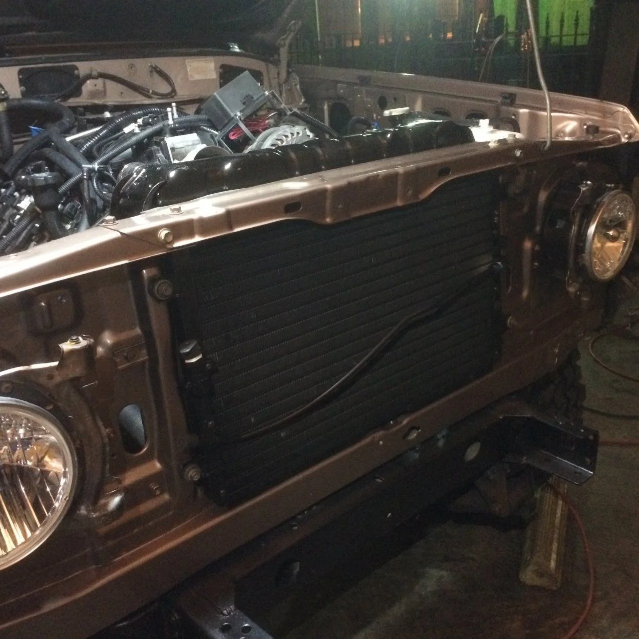

New A/C condenser...

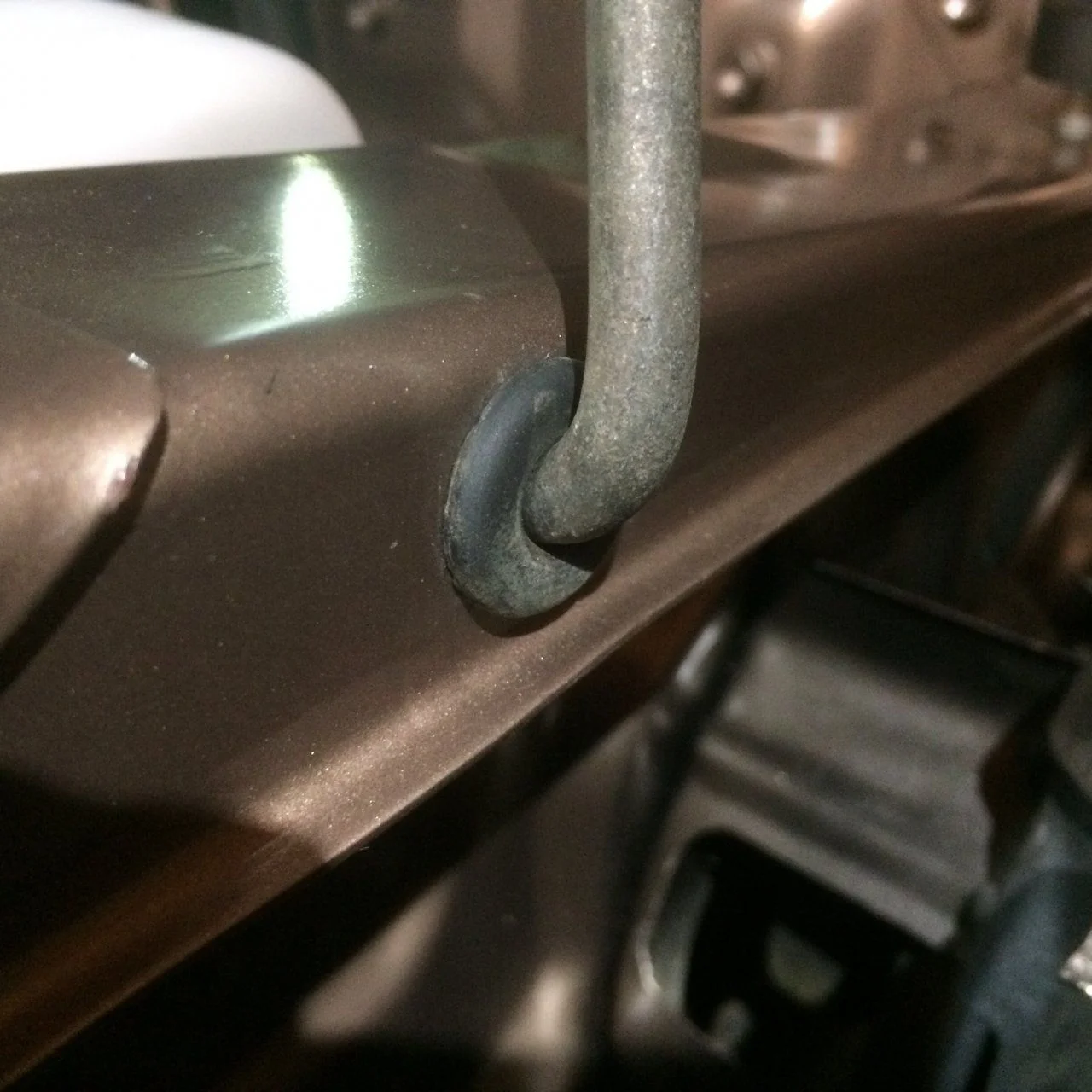

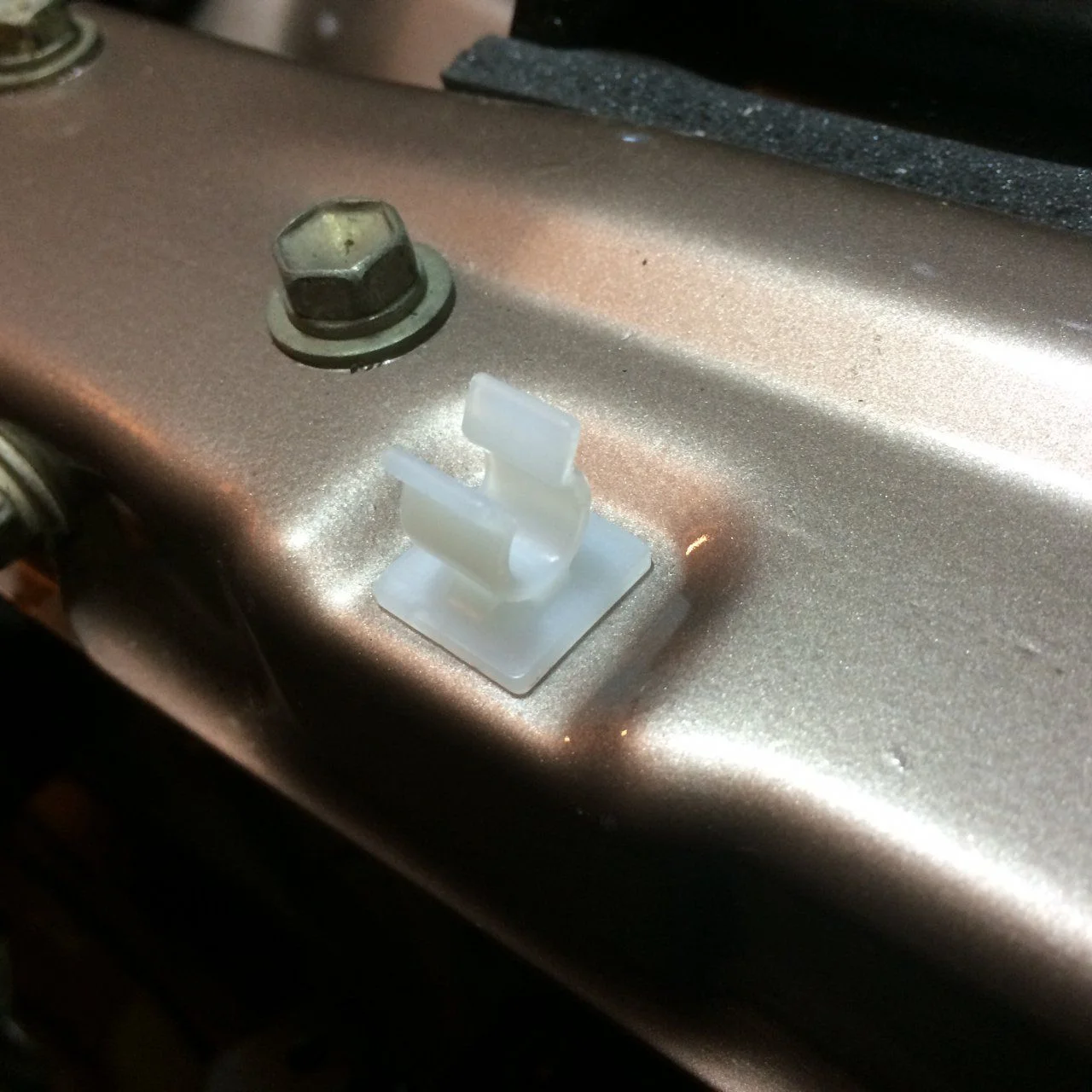

New hood support grommet & clip...

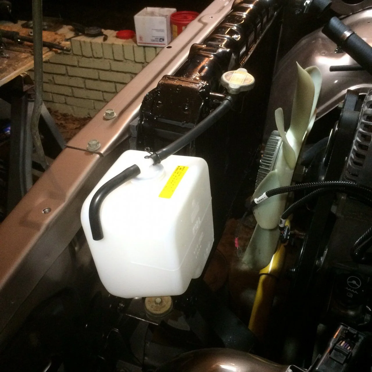

And my favorite piece of new bling, a new coolant overflow bottle & cap...

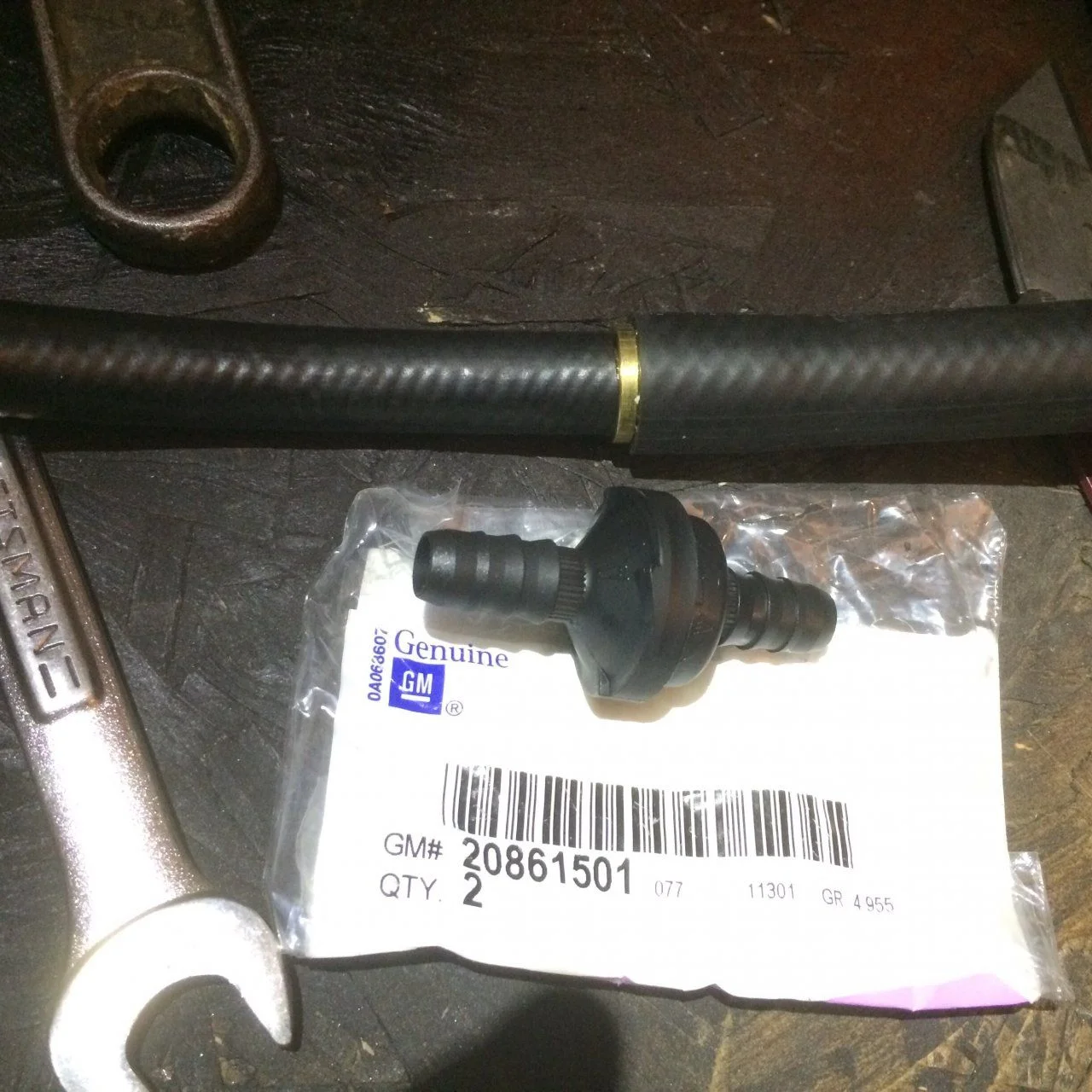

I saw this on some other threads, so you don't lose your brakes if you stall (hopefully a non-issue with the auto), you need a check valve on the vacuum line from the intake to the brake booster. Here that is, shown with the reducer needed to connect the two lines...

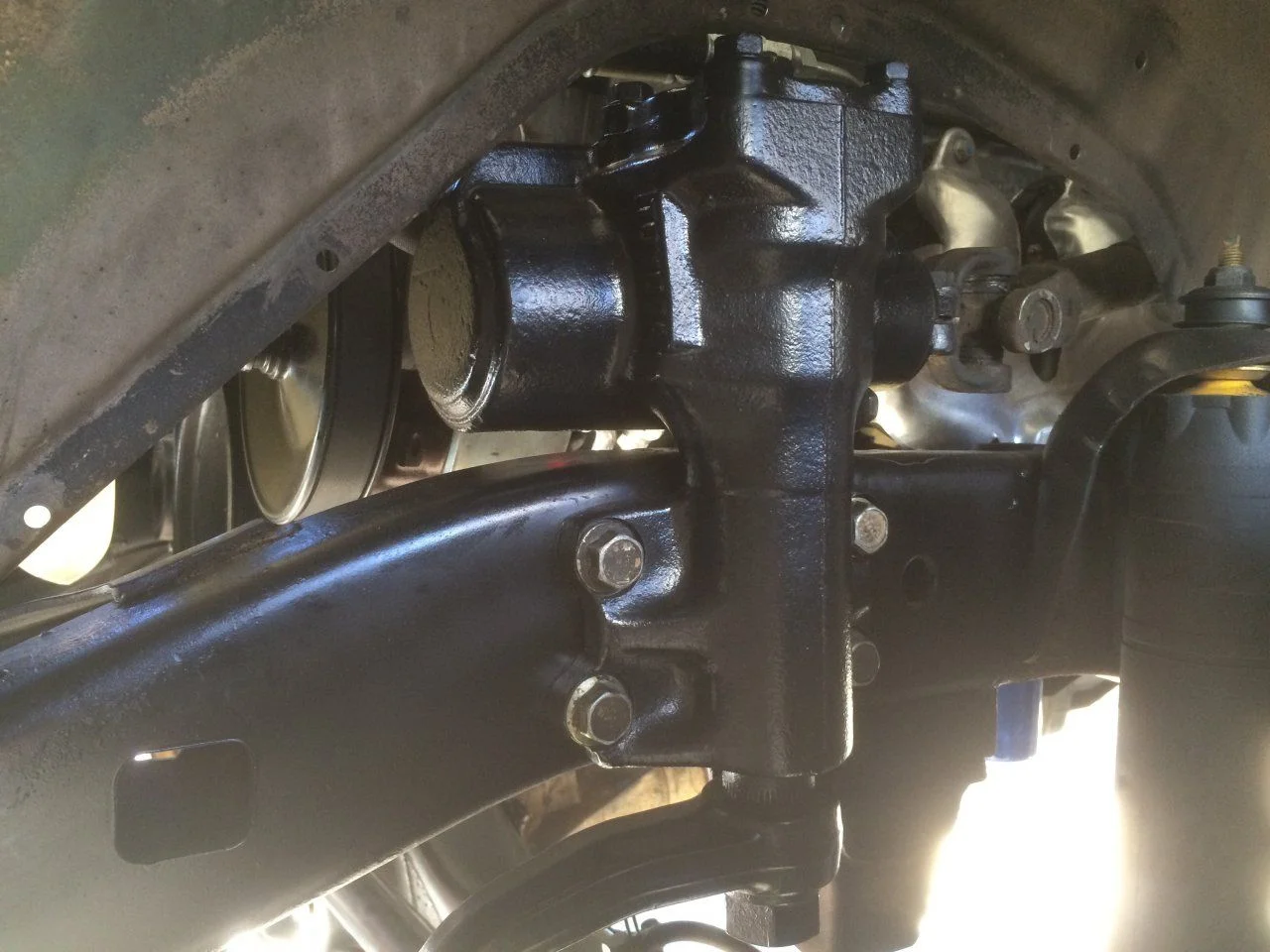

Facelift for the box. I worked fine before, so I didn't rebuild it. The sag pump will find any weak spots though.

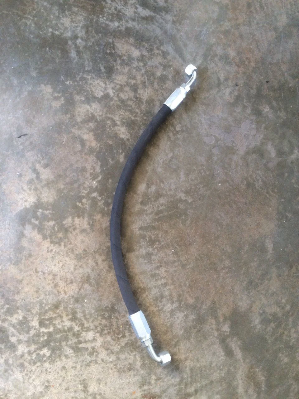

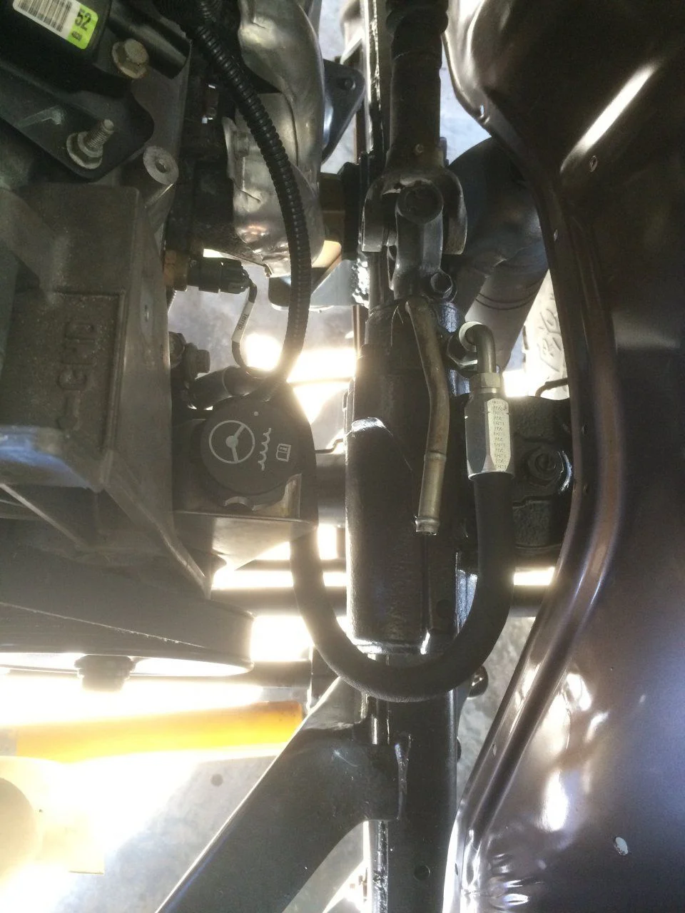

DIY high pressure PS hose from PSC. I'll take this to a hydraulic shop and get a crimped one made later.
Installed...

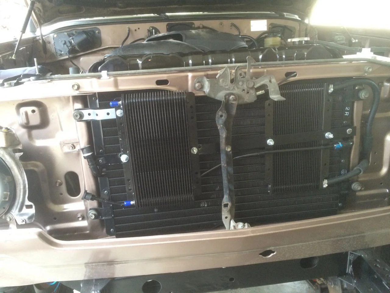

PS & Trans coolers mounted...

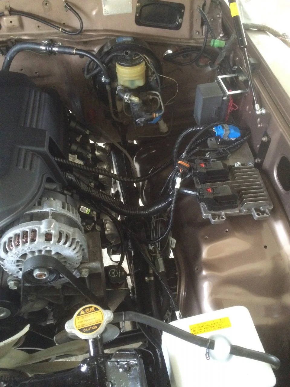

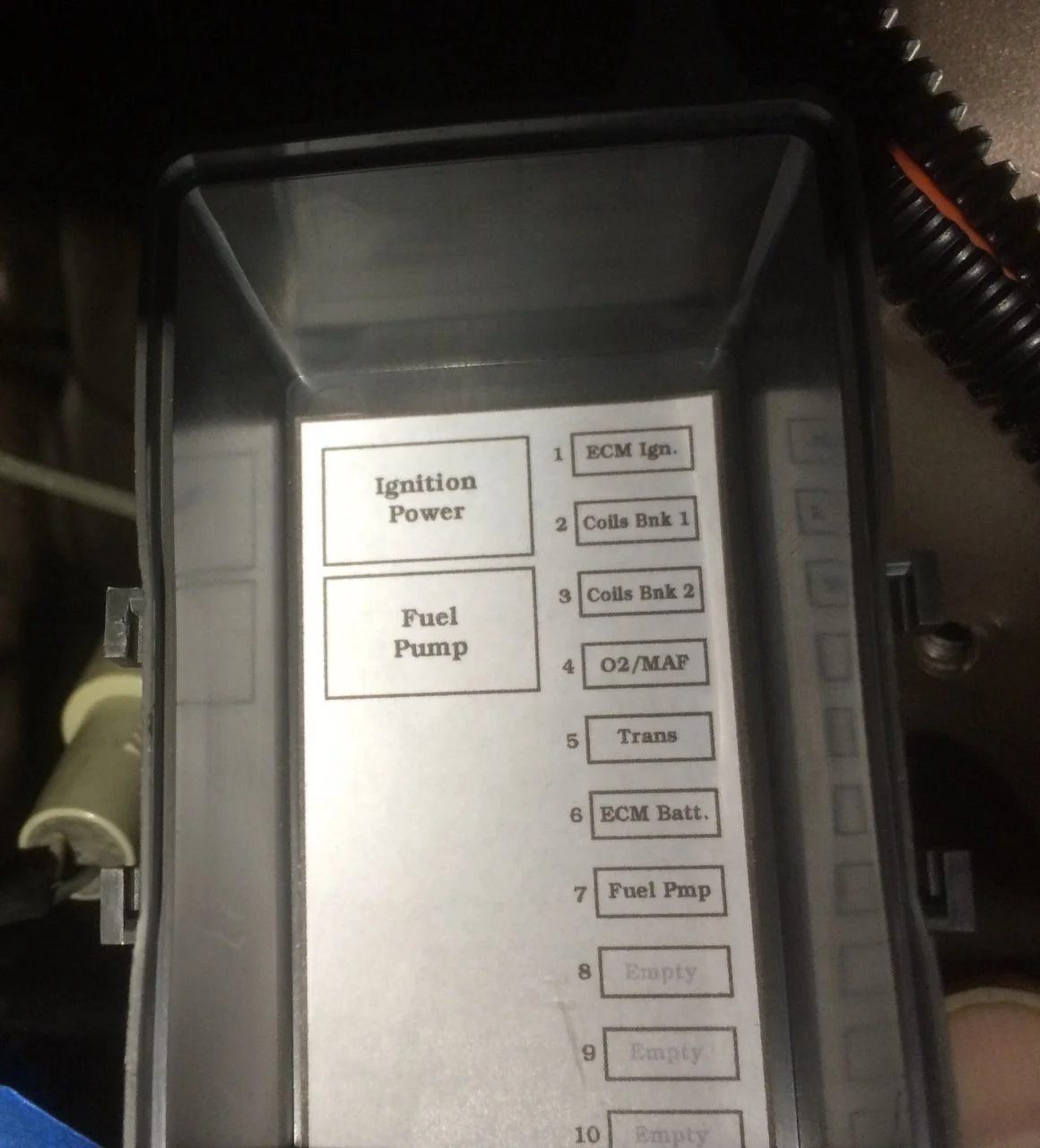

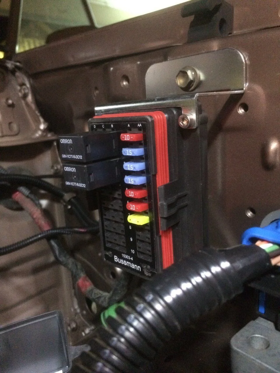

Computer & fuse/relay box mounted...
BMF (Bussmann Fabrication)
