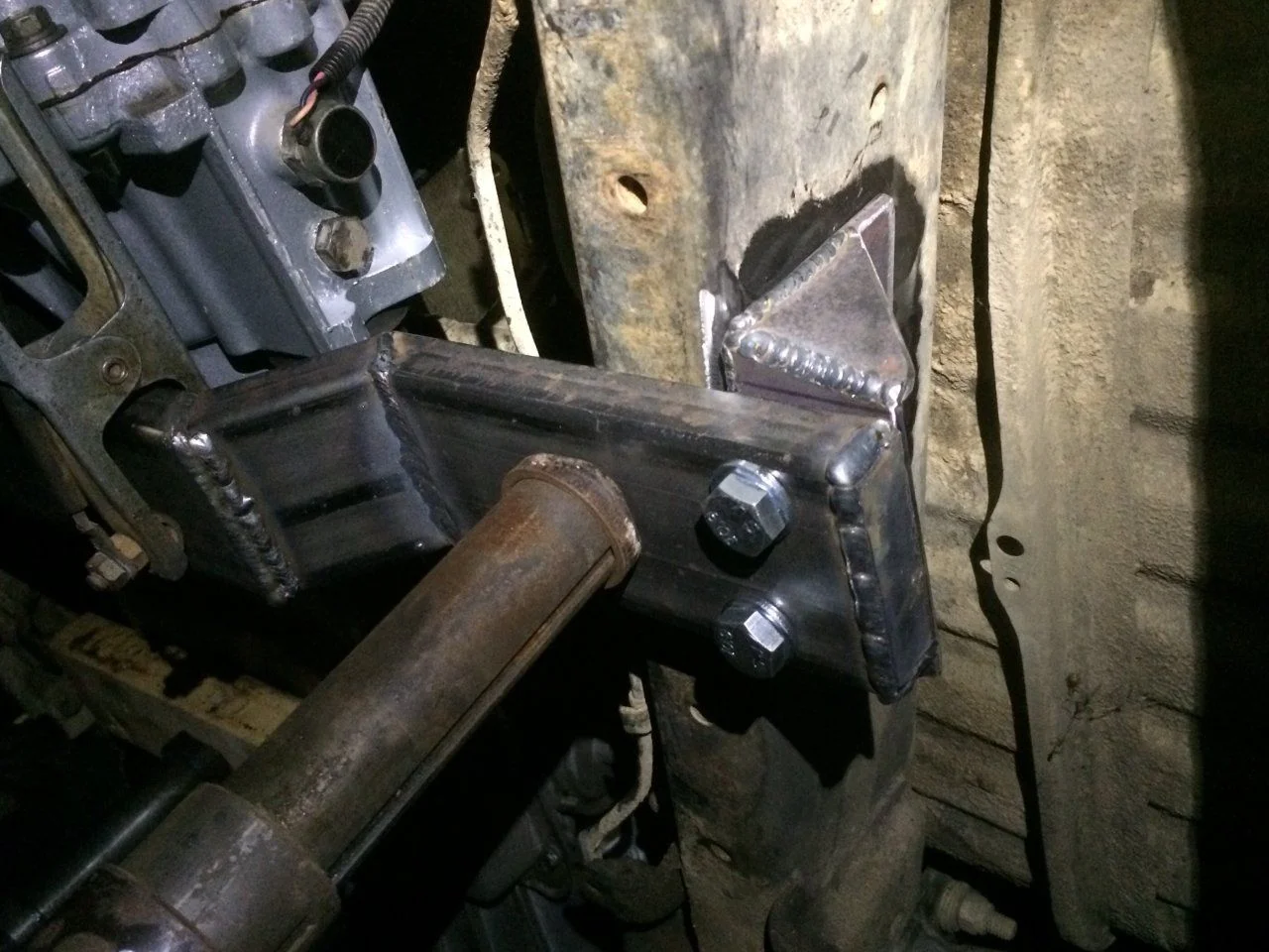

She's officially a roller now. I got the rear crossmember in place. Time will tell if my bootyfab is sturdy enough and my boogers sticky enough. It didn't even flex when I set the weight on it though.
I used 1x3, .120 wall. It sounded bigger when I ordered it. I'd go a little bigger if I was doing it again, just because. I ordered a 6' piece online, because the local steel supplier only sells it in 20' pieces.
I tacked the top nuts on the bracket for easy installs.
This is definitely lighter than the old drivetrain, plus the weight has shifted back some. With all the weight on the springs, it sits at least an inch higher. It's got a slight anti-stinkbug right now. Hopefully when I get the front bumper on it will level out.
When are you doing the spring over?
Cross member looks perfectly good.

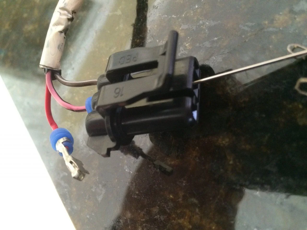

I hit a snag with the cam position sensor plug. The factory setup has a pigtail in a metal bracket to snake around the pulleys. My harness had the wire length to ditch the stock pigtail, but it had the connector that plugs into the pigtail, not the sensor. They are close, but not interchangeable.
No big deal in the end, I just swapped the connector. It just took a 30 minute detour to learn how.
