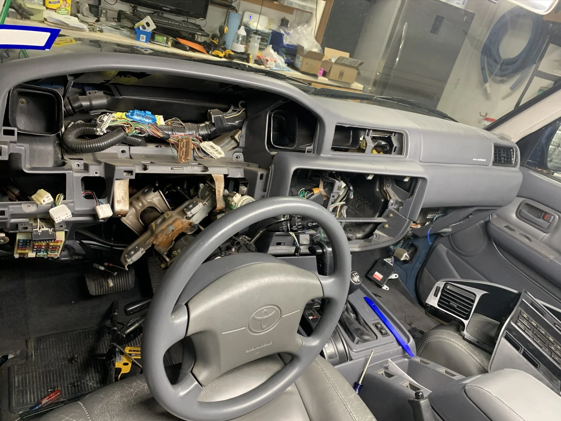

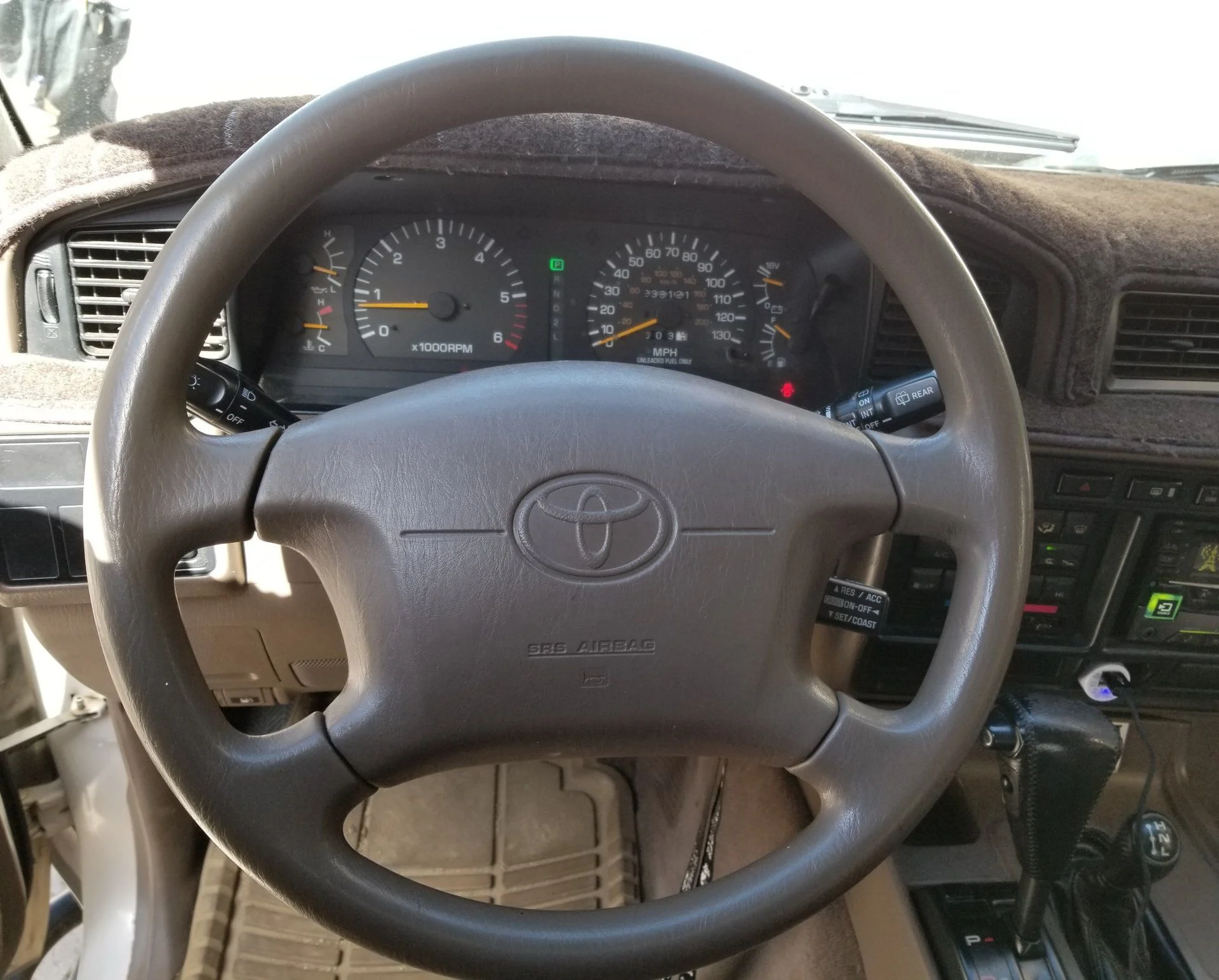

I swapped in a 1998 Camry steering wheel into my 95 land cruiser and it was a direct fit but the only catch was that the LC airbag did not fit so i had to order a Camry airbag off CL. The airbag was a direct swap and was plug and play for the LC. From what ive gathered 97-2001 camry wheels and airbags work.

Has anybody got photos of their swaps?

Similar MY LS400 wheel is the same diameter as the LC wheel, fits the airbag and everything. I pulled mine from a 1996 and it matched the gray interior of the LC just about perfect.
