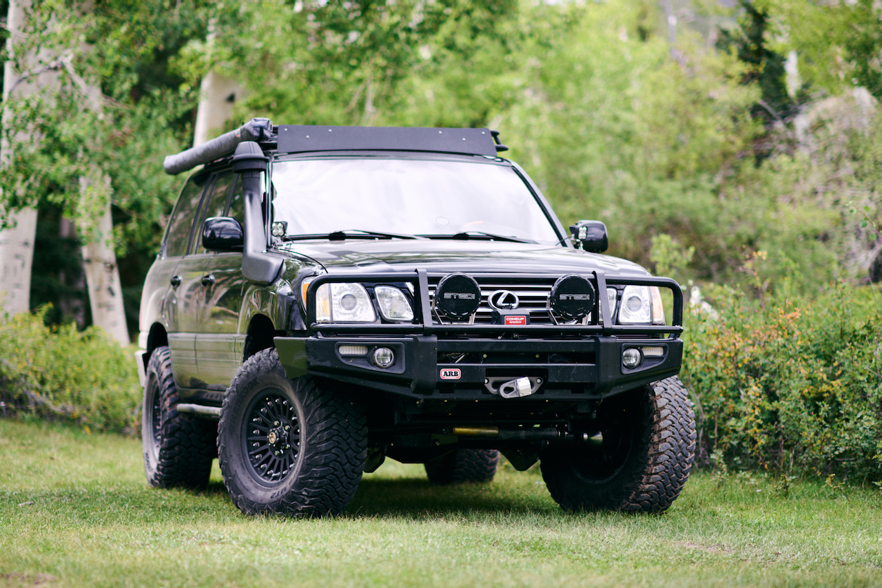

Hello, my name is Wes, owner of SHW Off-road. I am currently SASing my LX470. I am planning on having a booth at Cruise Moab next spring and would like to get as many SAS'd 100's together for a trail ride as possible. If you have a SAS'd 100 post a pic below, even if you aren't able to make it, but if you are interested in going let me know and I will try and get some things in the works for this.
105's WELCOM TOO!!!
Wait, you got your truck done or it's just rolling? Either way, it looks great!
That’s a trussed front diff housing, nice! I assume 4-link with coilovers on all corners?
