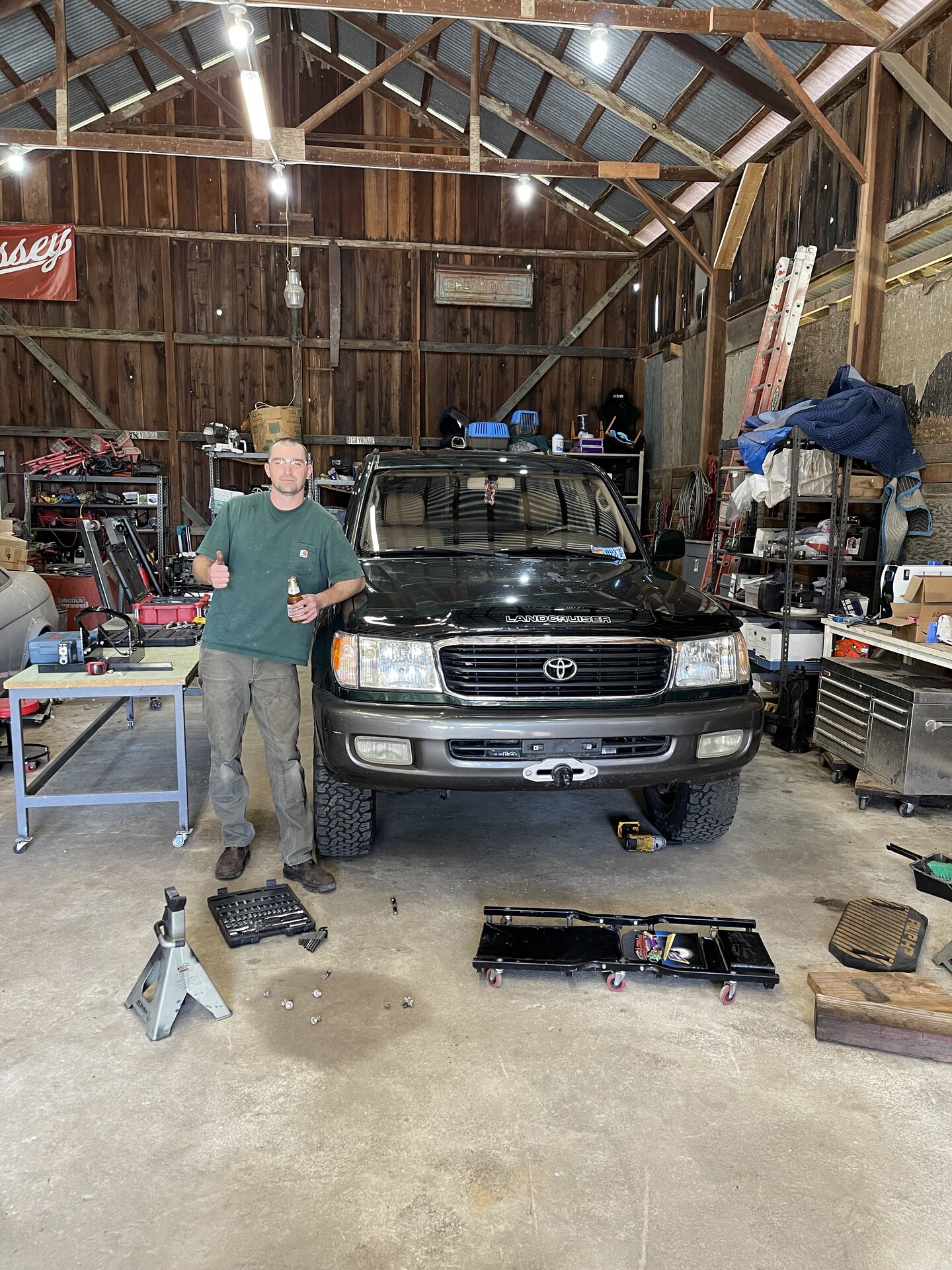

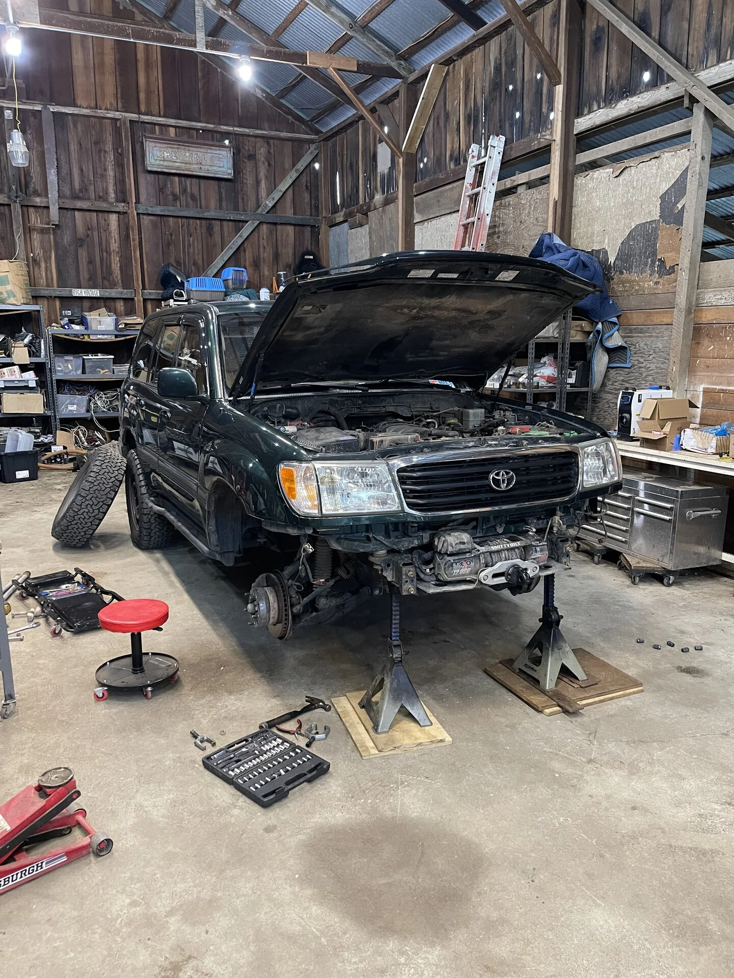

Yesterday was day 1 of the build. Laser leveled on jack stands.
Installed Dobinsons C59-615V springs for the rear, only got about a 1/2” lift over my OME 864 springs. I wanted a little more lift but I’m happy I’m starting as low as possible. I’m keeping rear factory brackets but using metal tech links and some TT lower link skids.
Removing all factory IFS today, torching the brackets off soon after.
