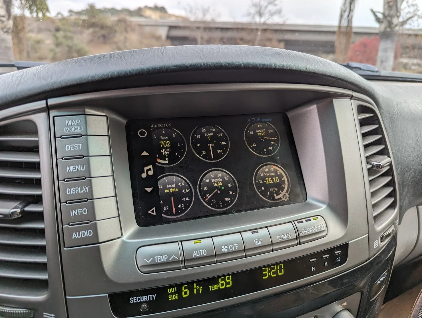

Finally, with some fiddling, got Torque Pro up and running on the headunit!

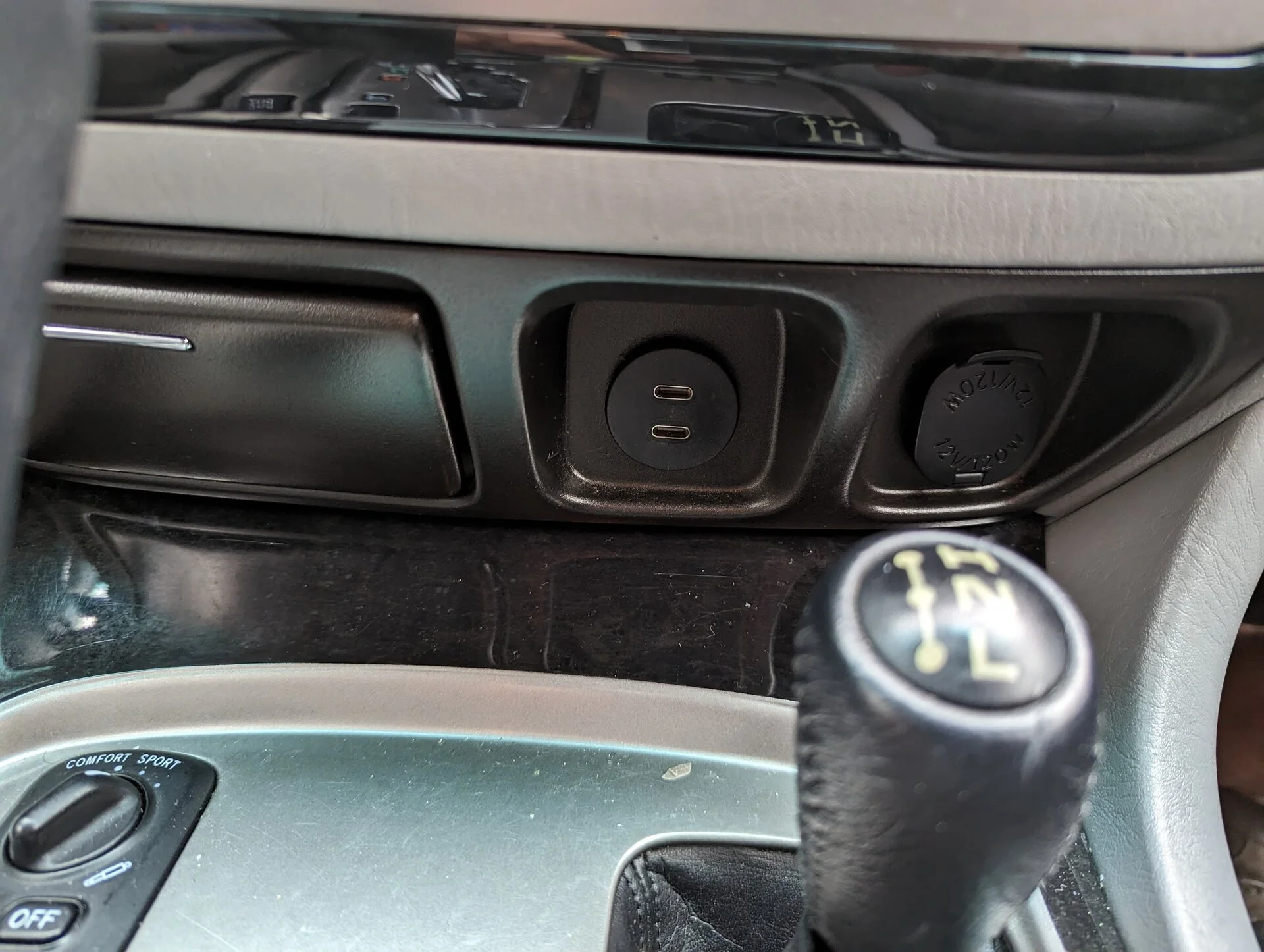

Sourced this dual USB-C adapter that fits nicely into the lighter space. Plugged the cables into the back of the VLine and everything works perfectly:

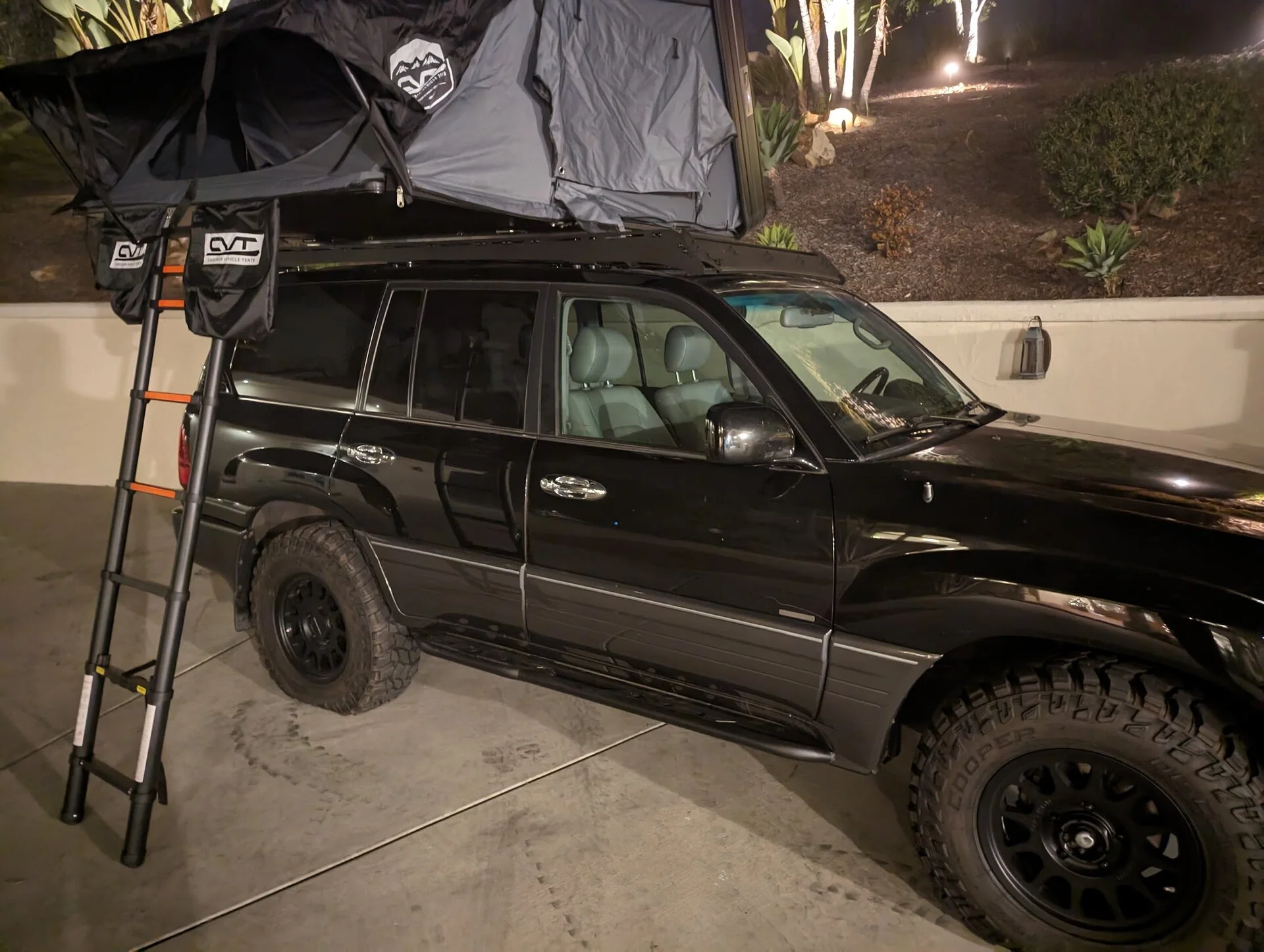

Got the CVT Mt. Washington installed! This is the new version that's a hardtop fold-out. There are some things to love about it, but also some glaring quality issues.
When I first opened the tent, I noticed that the "Stargazer Fly" was almost impossible to see through because it's so foggy. It looks like it's scratched, but it doesn't feel scratched. It's like the fogginess is inside the plastic. I tried washing with soap and water, but it didn't make a difference.

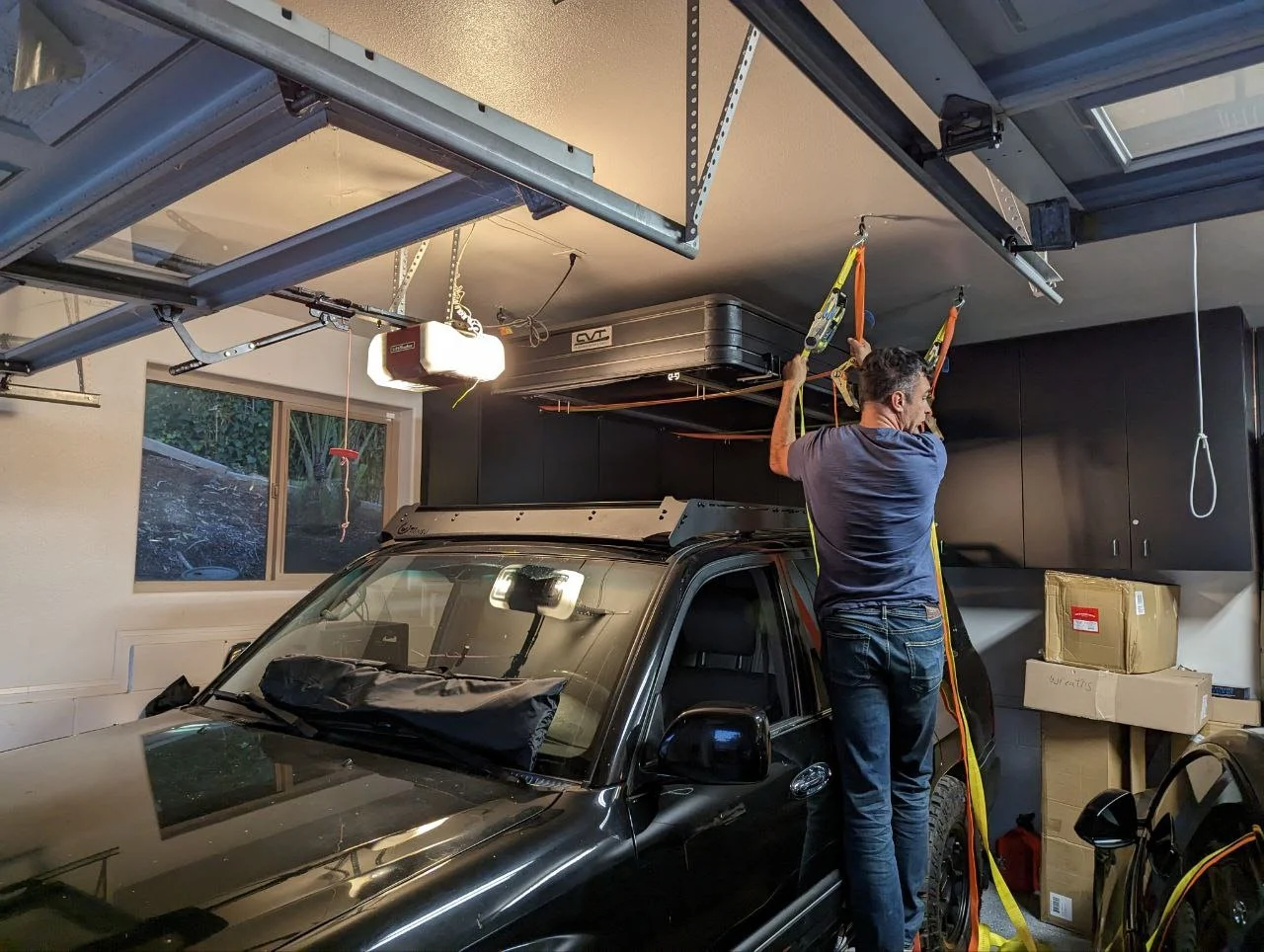

I wanted to find a way to install the tent solo and with it weighing 180 lbs, I knew I would need some engineering leverage. I rigged some eye hooks into the ceiling of the garage and used two sets of ratcheting tie-downs to lift it up.

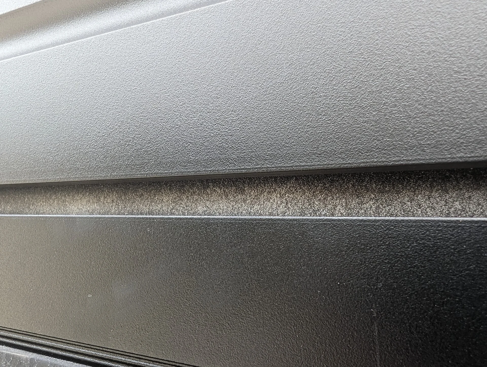

Once the tent was mounted, I noticed more quality issues. First, the channels on the side of the tent aren't painted well. It's almost like they accidentally oversprayed them:
Definitely a bummer.

I don't think I can recommend CVT based on the quality issues., but I'll keep the tent for now because I feel like I'm past the point where it makes sense to pull it off and return it. For now.

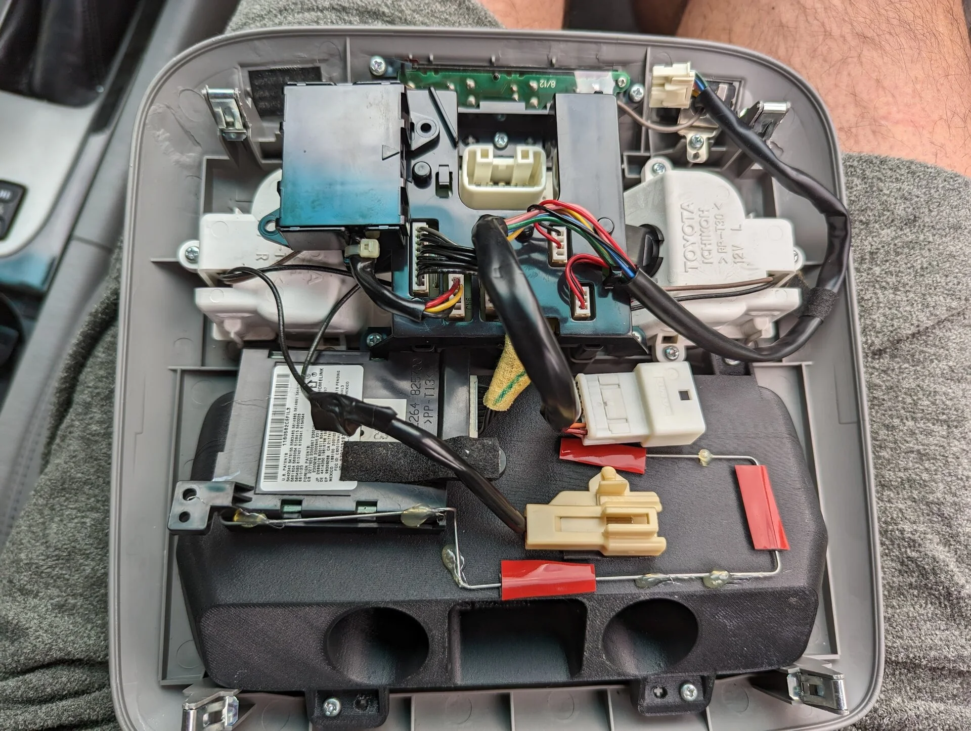

Here are some tips for that install for those with homelink and lexus link especially:

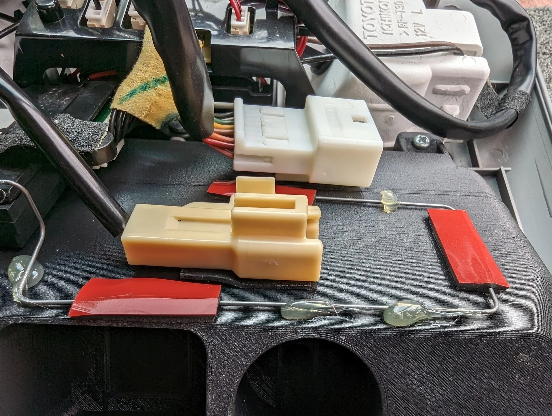

Here's the stock console when it's removed from the headliner:
Note we need to remove the bottom plastic housing that has three things attached to it. The black homelink box (and antenna wire) and two wire harness sockets. After removing those, we can install Ben's SPOD mount:
To mount the homelink, antenna, and sockets back on, I used some 3m double sided extreme tape. This provides some cushion to prevent rattles. Note that for the antenna, I used a layer of double sided tape underneath, then another piece on top (but didn't remove the top layer of backing to prevent it from being sticky). This held the antenna in place, but I was afraid it would rattle in the areas without tape. I shot some hot glue underneath to provide some spacing as seen here:

2) I installed a dual usb-c adapter in the cigarette lighter space. One tip here is to remember to slide the tightening nut onto the back of the mount before routing the wires! Here's the finished product.

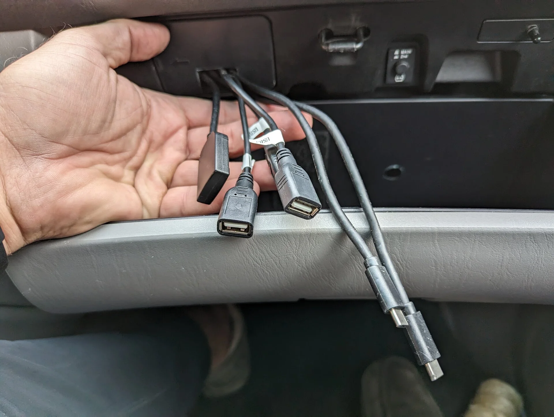

3) I ran the USB wires and the SIM card into the glovebox for easy access. The USB-A slots are from the headunit. The two USB-C slots go to the mount in the cigarette lighter. I'll hook them together when I get the right adapters in the mail. I ran them all here to allow me to switch stuff around and also to remove some of the cable bulk from behind the headunit where space is tight.

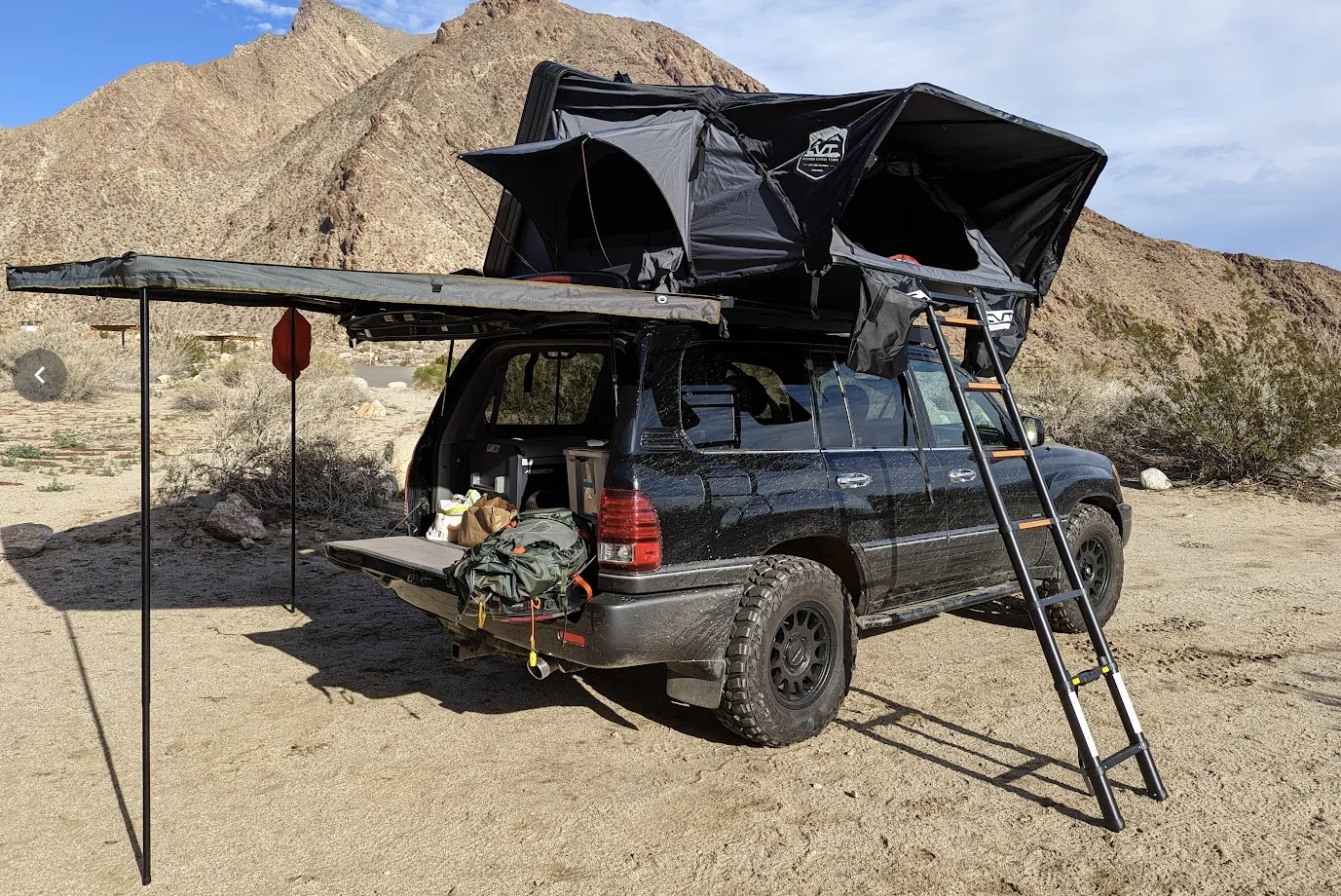

Finally got the awning installed! Clearly the rear whale tail needs to be removed at this point. It's getting in the way of both the awning AND the tent poles.
Awning was straight forward. No complaints at all. OVS 270. I'm 6'4 and it's a LITTLE low even with the suspension in high mode. I'm going to try to flip the brakets or dad some spacers to get a couple of more inches higher. The poles actually help lift it up a few inches, but it'd be great to not need to deploy them every time just to be able to walk under it!

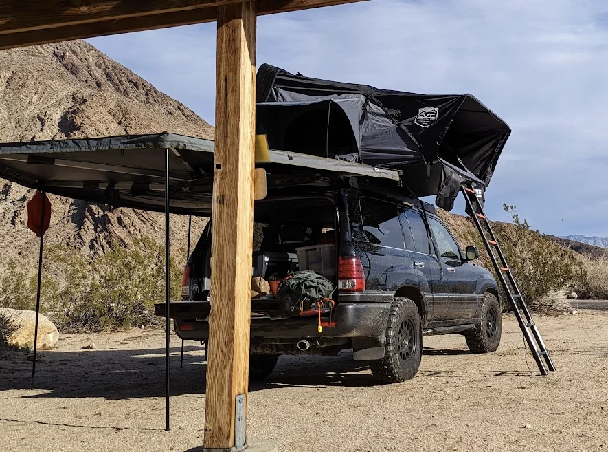

Got out to the desert (Anza Borrego) this weekend! Lots of adjustments to make to make things better, but an awesome trip. Took a couple of random side roads and got some wheeling in. Nothing that required 4WD, but still lots of puddles, eroded and unmaintained fire roads, and a couple of slippery muddy spots. The trail from Indian Flats to Lost Valley was especially beautiful and a great place for a picnic
