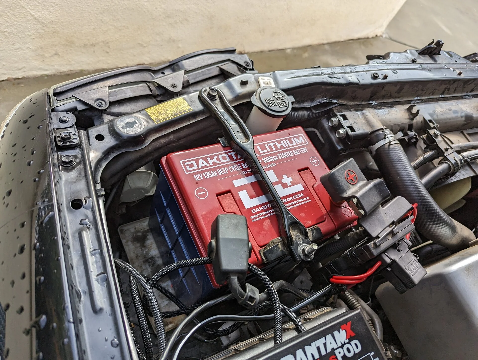

Just installed the Dakota DL+ Lithium 135 amp hour battery. This thing will EASILY run the electronics in the truck for a long time and can also crank the engine. This pairs nicely with the 130 amp alternator in the truck. As a bonus, it's a bit lighter than the OEM battery

The stock alternator is 130 amp :)
The battery has been flawless. I haven't driven the truck lately but had to use the onboard compressor to fill up a tire the other day. I went outside after she was sitting for 4 months and it fired right up like nothing.

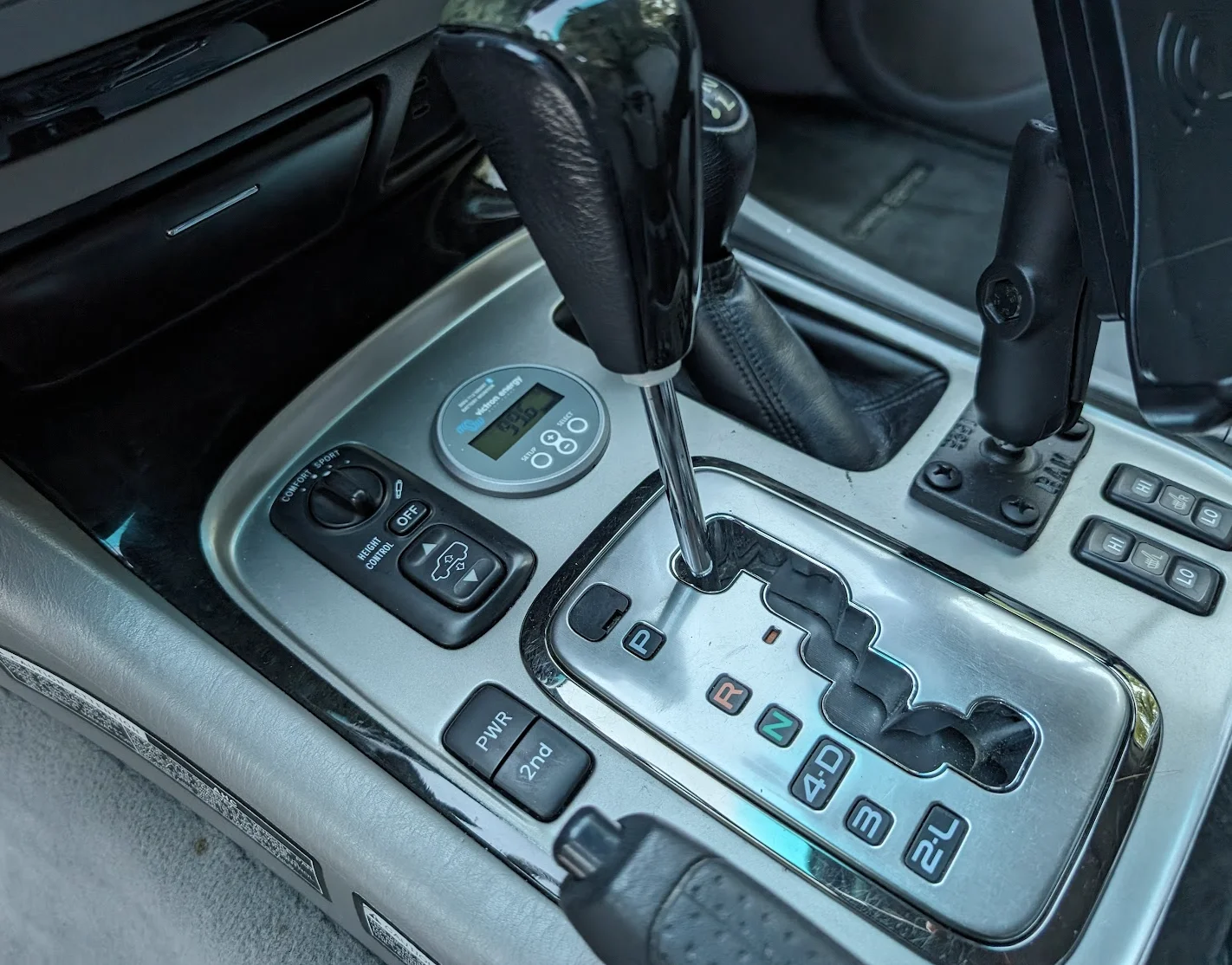

I also installed a battery gauge to keep an eye on it, which gives even more confidence.
Definitely a worthwhile upgrade if you don't mind spending the money.

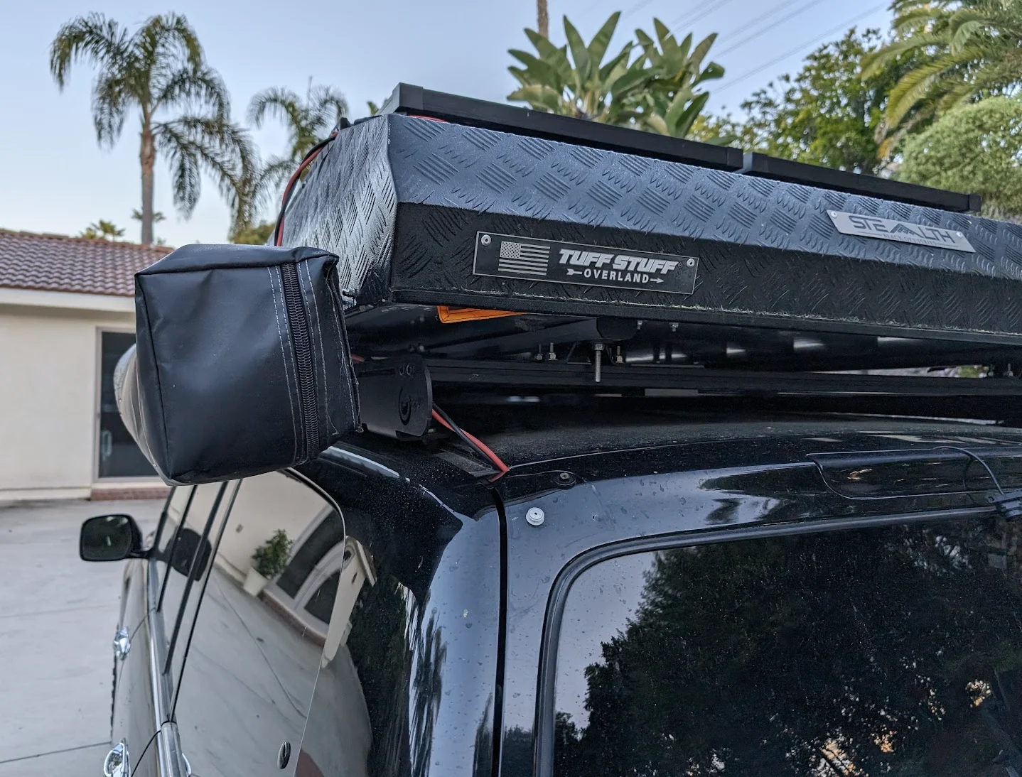

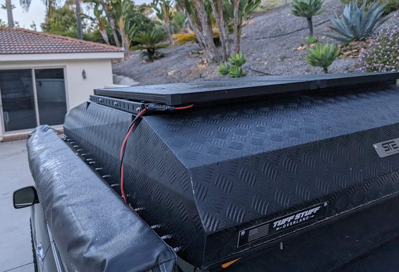

I have a delta 2 in there with two ecoflow rigid solar panels on top of the rooftop tent.

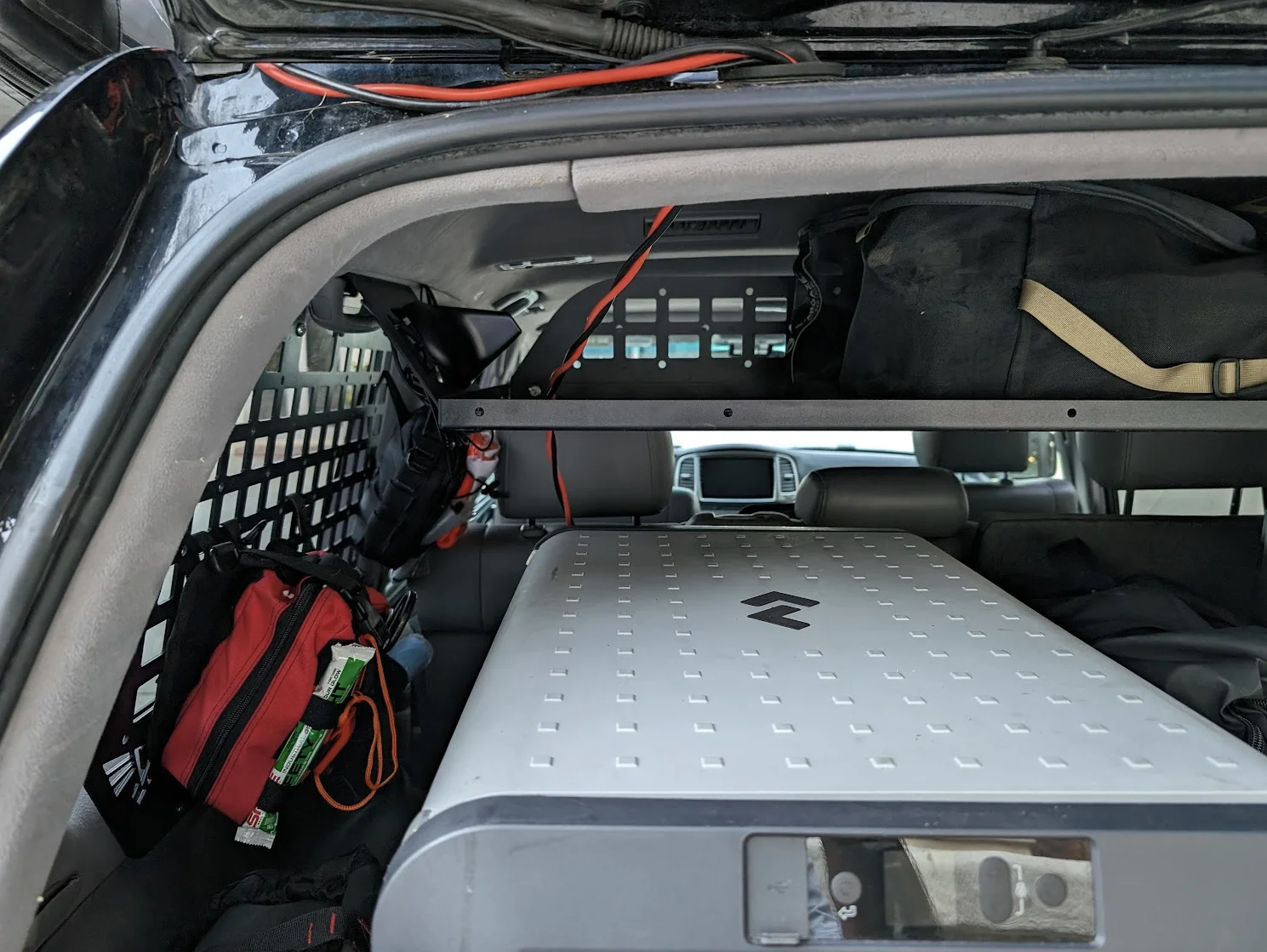

The battery is stored on the fridge drawer behind the dometic 55L fridge. All that is on top of a set of ADGU drawers.
I'll get pictures uploaded to show how it all works.
Here are some pictures of the setup:
Solar panels on the rooftop tent:
Those route down into the rear hatch
Once inside, they route to the EcoFlow Delta 2:
Here you can see the Dometic 55L fridge on the slide with the EcoFlow Delta 2 behind it, with the solar panels always connected to the battery. This keeps the Delta 2 topped off at all times. The fridge is also connected to the battery at all times (but is turned off). The fridge can run indefinitely like this 24/7, as well as plenty of leftover power for anything else I want to run. This also keeps the house battery totally disconnected from the truck battery, so there's no risk of leaving something on overnight and getting stranded with a dead battery.
Here's the power gauge installed:

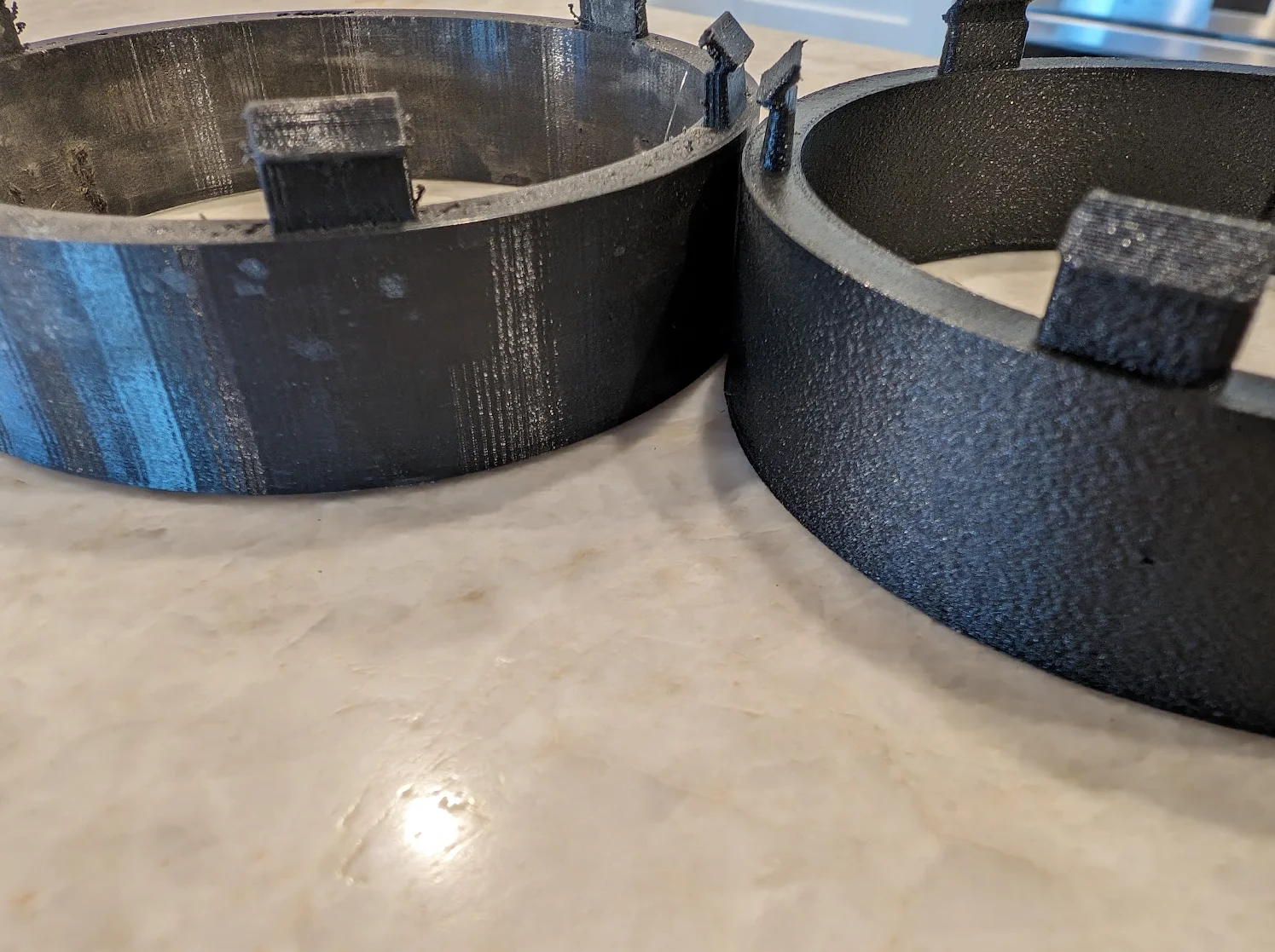

I reprinted the Method wheel cap extensions in NylonX with Carbon Fiber for some extra durability. They turned out much better than the previous PETG prints.
On the left are the previous PETG prints. Not bad, but a little glossy and you could see the layer lines. They also would snap tabs off if you weren't careful installing them. The new ones on the right are right out of the printer - no sanding or anything needed. Zero lines, nice matte textured finish, and the Nylon+CF is WAY tougher. It's also more resistant to heat and chemicals. They should last a lifetime.
